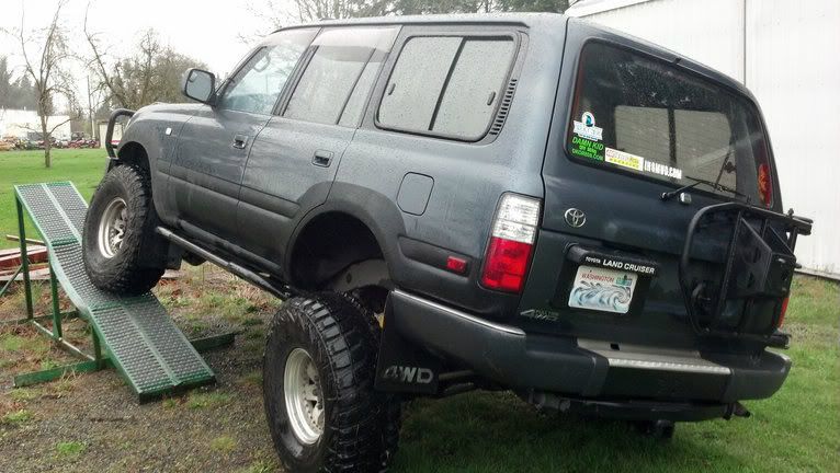

Standing at the rear of the vehicle it offsets to the left. Not a great photo but was my JDM cruiser that I imported in 2007. See it just under the ladder.
Dan you just beat me to it as I was uploading a photo.
Your photo shows the OEM tire carrier as well, versus the first generation Slee on mine. Later Slee carriers are shifted more to the left and do not lend themselves to the JDM plate mount.
