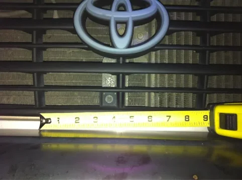

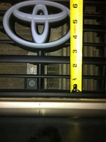

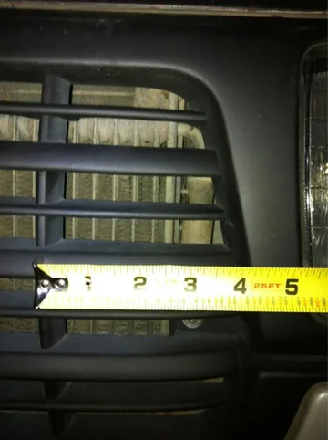

I have two ideas and would like to know the actual dimensions of the housings. First idea is for (2) 2x2 pods mounted in the grill here;
Second is to mount the 7.5" here
I need dimensions to see if I can pull either of them off.
Also, is it possible to get (3) 2x2 pods? I had a tab built on my bumper for a light and would like to put it to use! (Price dictating)

I will get exact measurements for you tonight, of the 7.5" and 2X2's with pictures. I just have to grab my measuring tape. I don't have a 7.5" on hand, so I will post some measurements off my spec sheet.
