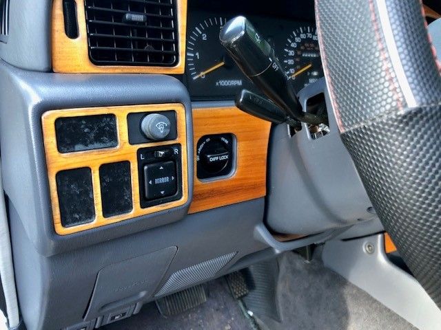

I picked up this pretty much stock 80 (1996 locked) minus some OME springs as a complete impulse buy. I was going to sell my built LX (which I did) and keep a stock locked 80 in the heard. However, I've decided I am getting out of 80s all together and diving into my 60 and 55 in a big way. So, this one needs to find a new home. Rust fee (minus the little spot below back glass it was patched before and after pics) , southern truck, clean car fax, 251k. Solid build able truck or rip the springs out throw some stock spring back in it and roll with it bone stock. Chris and Rob checked it out for a local buyer already, he decided he now wants a 100 and not an 80. $8500 firm takes it home and that will include an OME steering stabilizers and the Slee 2nd batter tray, windshield relocate bracket etc. The longer it sits the more work I will do to it and the price will go up. Would love to see it stay local. Would also consider trader or partial trade on 60/62, 100, 40/45, or a 1st gen Tundra with v8.
