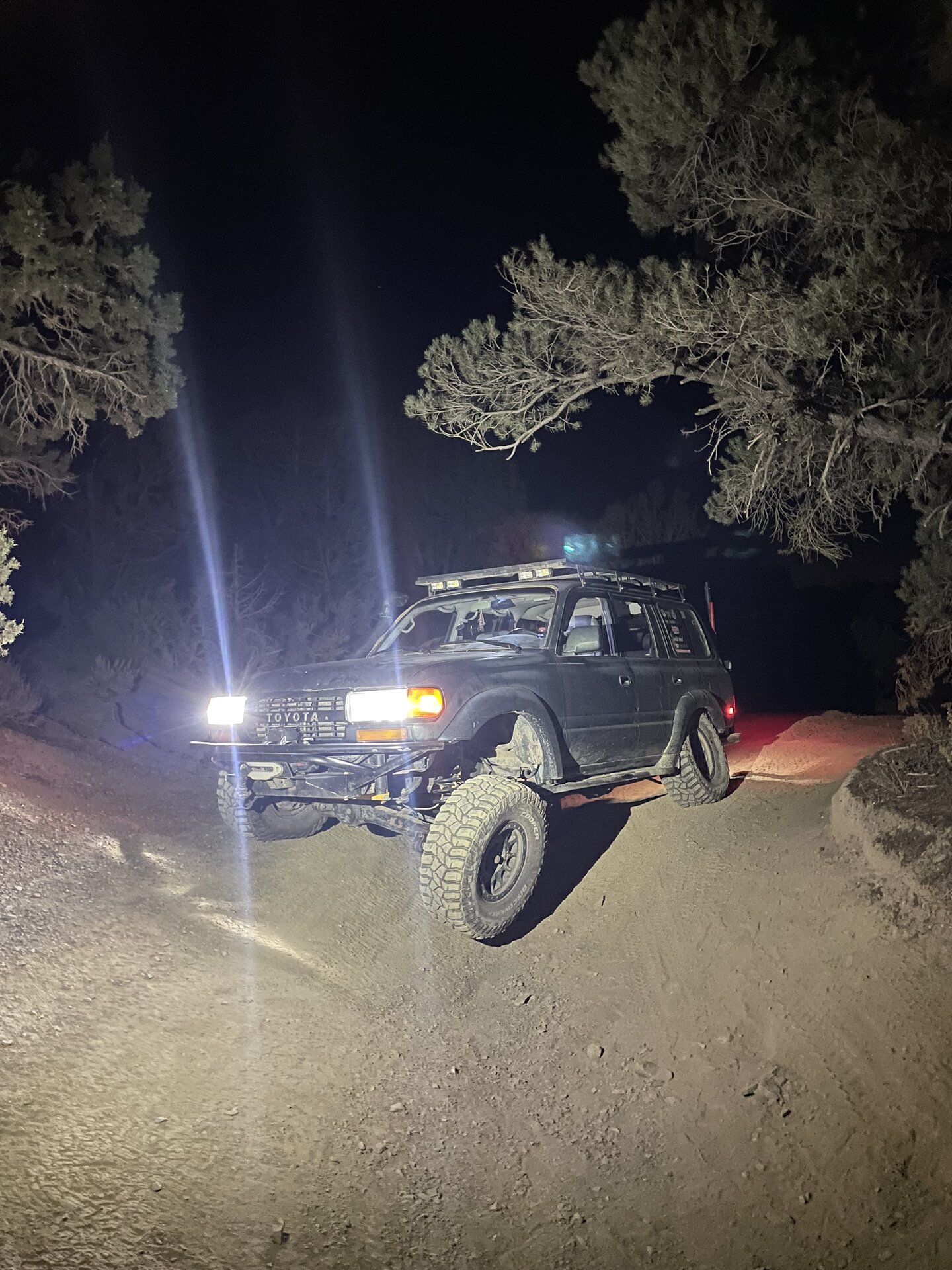

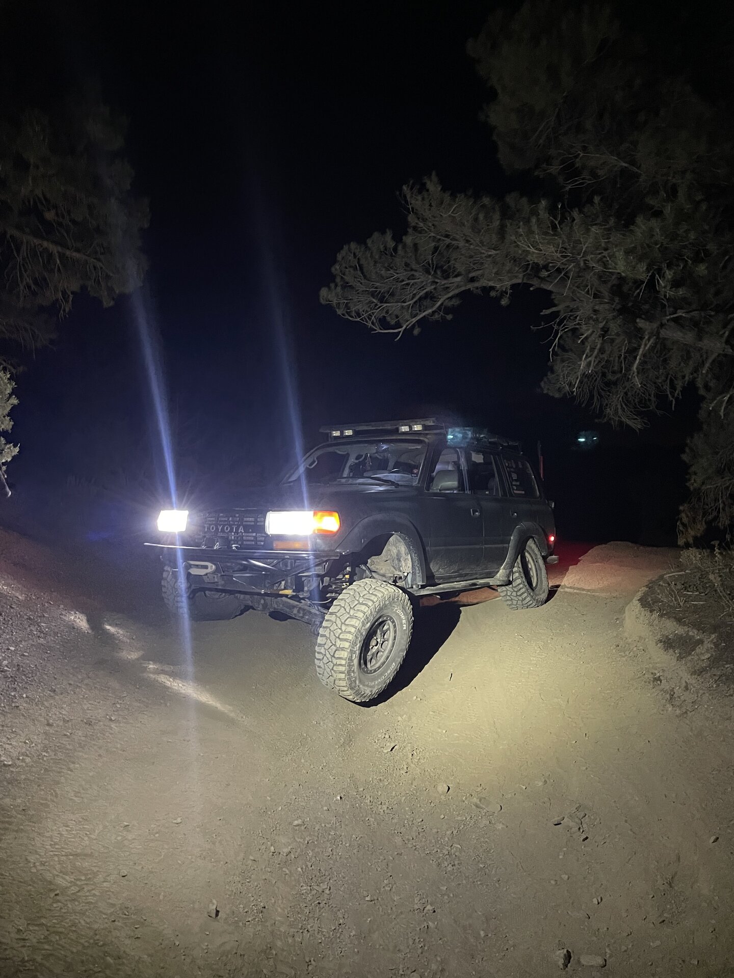

Here are some photos with a disconnect I fabricated a few months ago.
