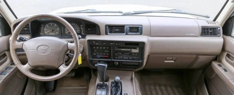

The older dash is way nicer looking. People will say it looks like a Camry but if you look at Camry's back in the day both of the dashes look like different generations of Camry dashes. The early one looks more like a supra and is more driver-focused. The new one looks like it was hacked together IMO. but different strokes for different folks.

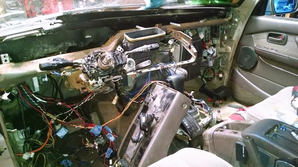

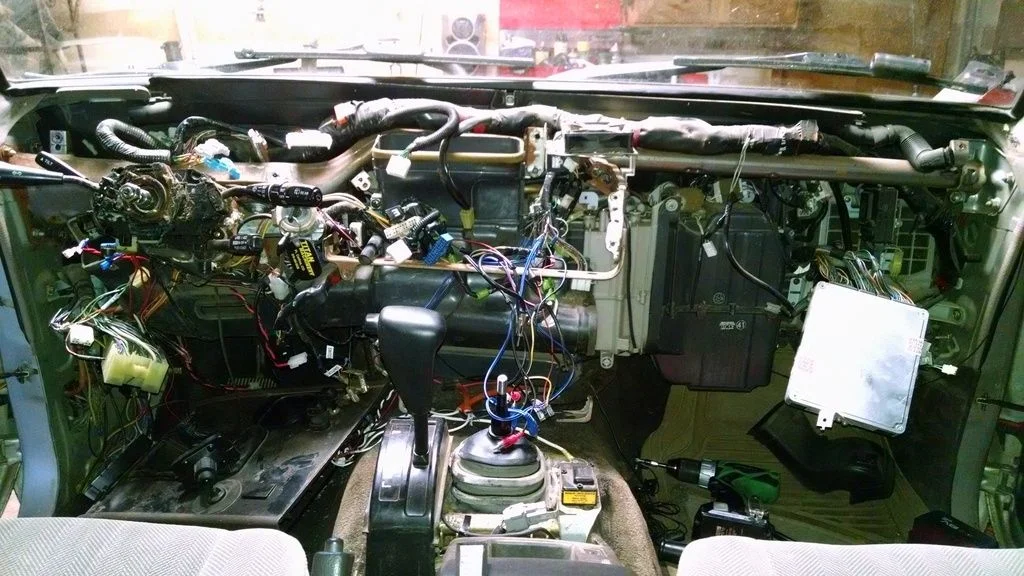

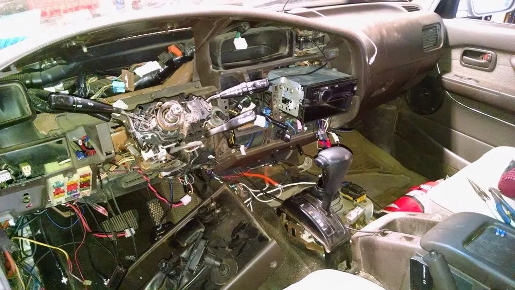

Can't speak to the later dash but I did pull my 93 dash to replace the hacked-up wiring harness and I did not enjoy it. Not because it was technically challenging but more so that it was tedious and frustrating. I'd agree with @Njck22 that it's about a :banana::banana: job. Its as simple as following the FSM, taking your time, and exercising patience, it can easily become frustrating so knowing when to take a break and walk away is key.
Photos from my build thread, "Operation un-phuck P.O.'s chitty wiring"
Lower kick panel, radio / HVAC trim, upper trim & gauge cluster removed. This shows the central HVAC vent that is different from the early to later dashes.
Early Drivers side vent tube, there was a dash bolt hidden behind it which frustrated me when trying to remove the dash (there is another hidden one behind the ashtray.
Dash out old wiring, take a look at the central vent. The 90 degree turn out has been taken off, but I'm willing to bet the lower part is different from the early models to the later models. Not sure if that requires taking out the entire HVAC box?
Dash out harness out. Don't mind the craptastic wire mess, that's no longer part of my rig.
