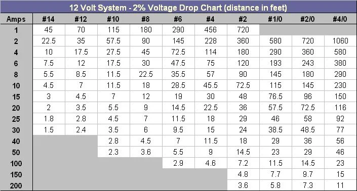

My limited research says the DC doesn't like to travel long distances. Maybe this is solved by running bigger wire? I don't know.
I think for larger solar panels it is important to get the right wiring from the controller to the batter. For a 400 watt panel you get about 30 amps of current, which is a lot. And from rear quarter panel to the driver side factory battery location is about 25 feet depending on how you want to route it. So according to the current drop chart you will need #2 gauge power cable to be safe.
I plan to run panels putting out between 160 and 200 watts, which equates to about 13-16 amps. I already have 4ga cable run from the drivers side (main) battery to the rear quarter panel, it's about 17'. According to this chart, and being conservative (let's call it 20amps) that 4GA should be good for 22.5 feet.
I plan to run between panels putting put between 160 and 200 watts, which equates to about 13-16 amps. I already have 4ga cable run from the drivers side (main) battery to the rear quarter panel, it's about 17'. According to this chart, and being conservative (let's call it 20amps) that 4GA should be good for 22.5 feet.
I did the same thing to a blue sea fuse box and I used 18feet of 4gauge. To reach the seat belt bolt area is a another 4-5 feet.

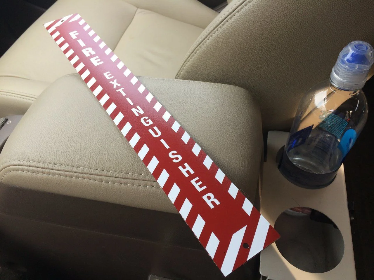

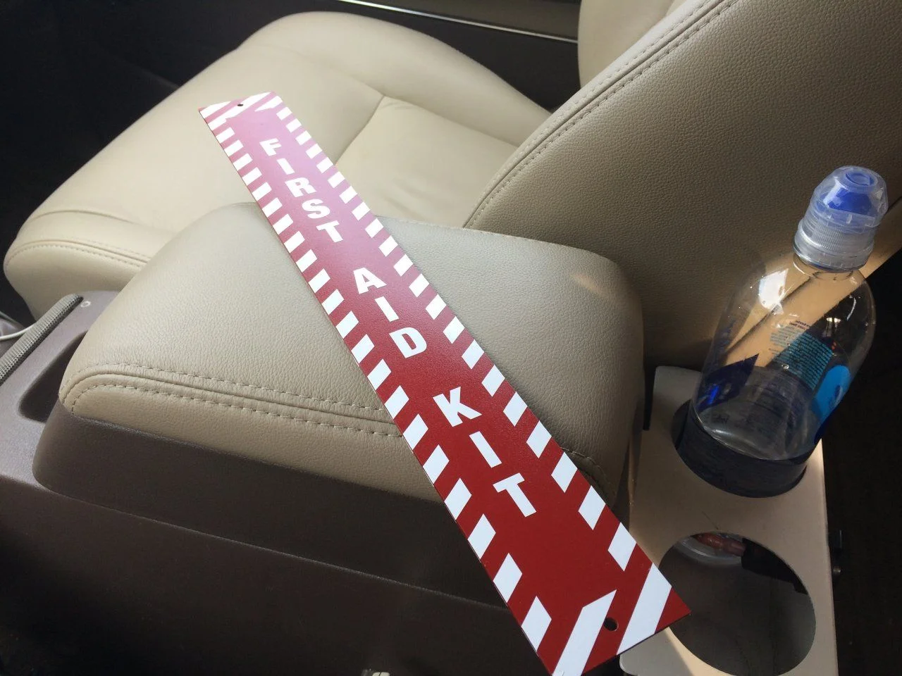

Update: one small piece of the puzzle is done. 14 gauge aluminum, powder coated red, silk screened with reflective paint. Using vinyl for representation only. The pics show front and back of the insert.
I'll have more to show in a little bit ;)

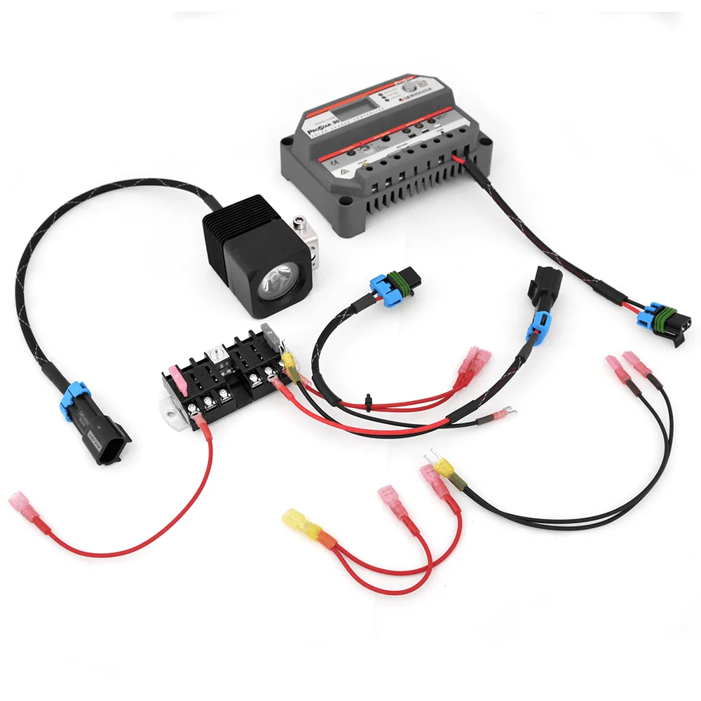

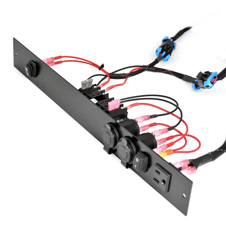

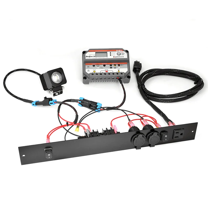

Alright folks, here is an update that I think will be more to your liking. I have the Power Panel about 95% wired. I have three wires that I need to confirm the wire gauge, I need to properly pack the grounds and I need to make another Metri-Pak disconnect for the entire Power Panel. Otherwise the wiring is all figured out. The panel itself assembled just as you see it here. If you guys think I am missing something please let me know and I will see what I can do about adding it. I haven't decided how I am going to label it yet but I'll figure out something.

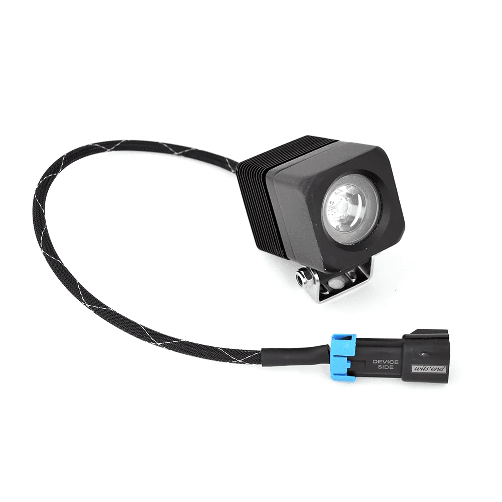

• LED camp light- I am NOT a lighting expert so your guesses are as good as mine when it comes to lighting. I played with this one and it seemed to get the job done. I'll be making it so that you can use nearly any LED/pod that you want to use so long as the wire can support it. The light is plugged in using a Metri-Pack connector.
• Solar Charge Controller- wiring for this is limited to a pigtail so that you can just plug it right in and its just a Metri-Pack connector. I will be making a mounting panel that will tie into the back side of the D-Pillar Mount (DPM).
• 110v cable- this is also something that I have to assemble. If ANYONE know of a place that sells these exactly as you see in the pics, please let me know. I haven't been able to find one. This cable is literally an extension cord to a power inverter.
