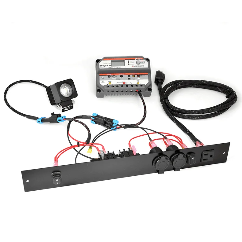

Not sure if everyone would have that needs as I do, but in addition to having a switched cooking light, I could use one or two more switches for led strip lighting just inside the gull wings or along the awning. You could label that 'mood lighting'
Adding more switches, or at least knockouts, is easy and I think there is still room to do so. Of course it could all be on one switch...but then that takes the "mood" out of the equation. :p
Edit: I'm pretty sure I could add three or four more switches up top. Need to be careful though. If it's just for low wattage LEDs then it should be ok. Anything else that draws more current and I'll need to re-evaluate wire gauge BUT I'm open to it. ;)
If you are going solar, then that controller has a built in LCD the displays solar current, load current and battery voltage.
OK, I'll play- how feasible would it be to add the voltmeter and switch from your underhood panel to this so that the condition of both batteries can be monitored from this command center?
Hmm, not difficult but I would be concerned about the accuracy at that distance. And why both batteries? If power is not coming from the Solar Charge Controller then it's coming from whatever battery is supplying power. It can do both batteries but then you are running extra wires. To check voltage of the supplying battery then it's just metering the supply voltage.
Unless you mean a switch to toggle the LCD off and on?
