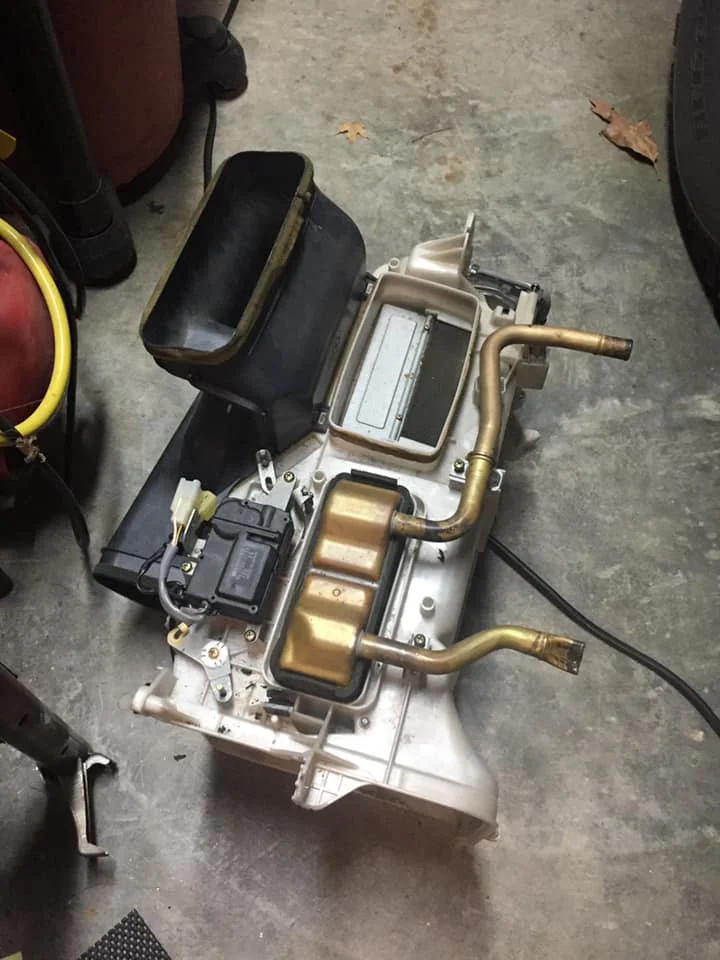

My guess is the blend door is not moving to allow air to flow through the heater core. Behind the dash there is the "box" that holds the heater core and all of the flaps to direct air. As you move the temp slider from cold to hot a motor turns a flap to let more air flow through the heater core instead of bypassing it (this is my loose understanding). My guess is maybe the black box in the photo is what is controlling that. There are also a few threads regarding the blend door that may help you further.
