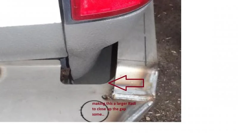

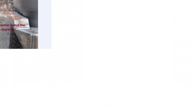

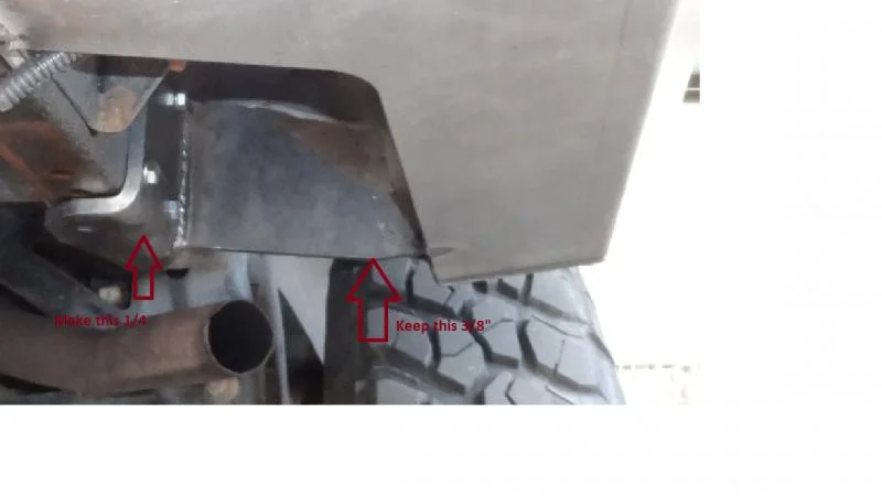

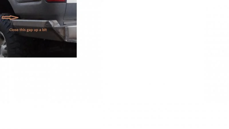

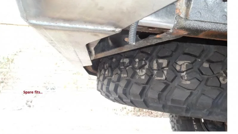

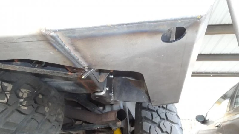

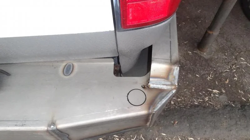

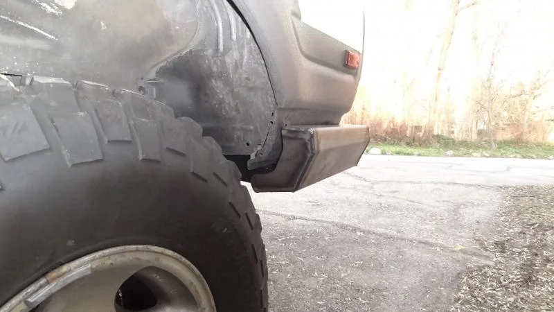

Got in the shop and finished up the first prototype.. there are a few changes that need to be made to the brackets minor really, i may go with 1/4 and 3/8 on the brackets for better forming and push a few dimensions on the bumper for better clearances. i should be able nail down a price for the bumper pieces minus shipping Tuesday next week and maybe even a shipped price for the lower 48.. outside of that we will have to do on a case by case basis i think. shipping may be cost prohibitive for those up north and we could figure something out. i'll post pictures later tonight or tomorrow morning..
Pictures..
