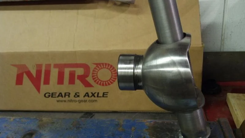

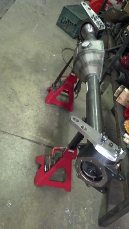

Custom built 80 series width 9.5" landcruiser frontends
We have made a jig, and can offer these complete turnkey, as of now will also require a core 80 frontend for the knuckle balls etc, we can provide.
Parts list and price (today):
NPHTLC95HOS CUSTOM HD TOYOTA LC 9.5" AXLE HOUSING, NO BRACKETS OR ENDS, MUST SPECIFY LH, RH, OR CENTER DIFF, 3.5" TUBES $call
NPTLC80-KNUCKLES FJ80 HI-STEER KIT WITH KNUCKLES, ARMS & BUNGS $call
AXTBIRF-FJ80KIT NITRO HIGH STRENGTH CHROMOLY BIRFIELD AND AXLE KIT For 80 series LC $765
TLC100-430-NG 98+ STYLE LANDCRUISER 4.30 RING & PINION, 29 SPLINE $449 Also available in 4.88. Can use the TLC-XXX-NG 97 & older type gears with RD142 as well
YOKT35100-MULTI 29 SPLINE FLANGE $55
ARBRD152 98+ LC 9.5" REAR LOCKER, 32 SPLINE $1040 We changed this to 30 spline side gears, to run our off the shelf axle kit.
MK TLC-B 91+ LANDCRUISER 9.5 MASTER KIT W/ KOYO $192
SK CSTLC-90+ LC 9.5 SOLID PRELOAD SPACER KIT
KNCLKIT-FJ80 LC 80 KNUCKLE REBUILD KIT $140
AK TOY-FRONT X2 FRONT WHEEL BEARINGS & SEALS $40 EA

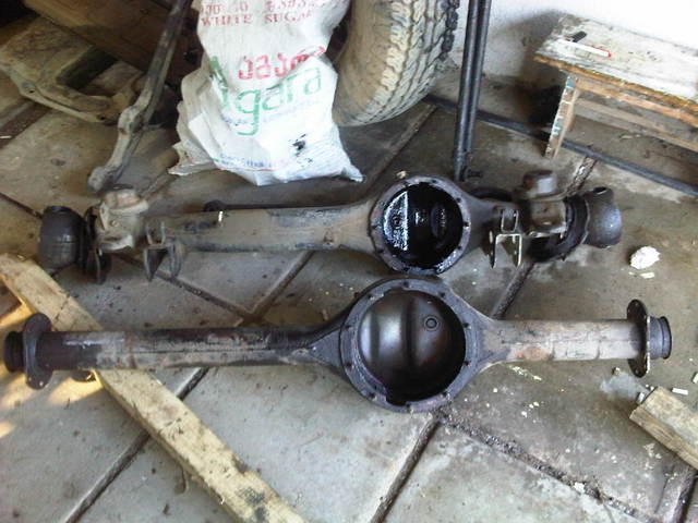

I am going this way to build front axel
BJ40 Rear semi float axel, streched to 80 series front axel length, with 80 series knukels.
With ttis i hope to achieve 9.5" r&p, and 80 series knukels disks birfs etc...
Here is photo of 80 front axel and 40's rear semi float.

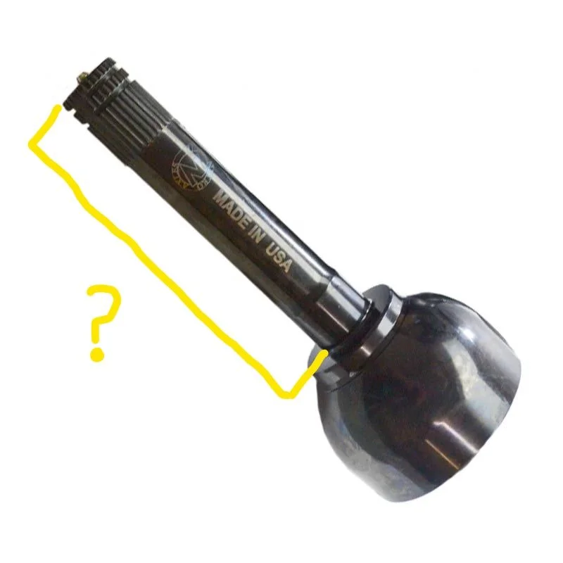

anyone able to out a 40/60 birf and a 80 birf side by side to see the length difference between the outer stubs?
Ok, try and get that tomorrow or Saturday. If it matters they are the shorter 94 version, I'd have to pull my front apart to measure my RCVs if you want the longer ones pictured
Don’t go to that trouble on my account. I’m just looking for a rough idea.
