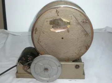

Hey Stan, some of your earlier pictures aren't showing up for me anymore... But if I remember correctly, post #27 was where you showed how a tumbler had restored some bolts from rusty/nasty to shiny. What kind of tumbler and polish did you use?
Forgive the hijack but I've had pretty good luck with an old discarded rock tumbler (homemade versions are on online). What trial and error has taught me: Use a nice solvent for the grease (purple stuff or some simple green), an abrasive for the rust (fine sand), and patience (8+ hours or tumbling)

I use a tumbler purchased at Harbor Freight . Greasey stuff I clean with solvent first and alllow to dry. I use media found at HF, little pyramid shaped pieces. Rice is right on the mark, time, lots of time. Usually a day or two in the tumbler.
