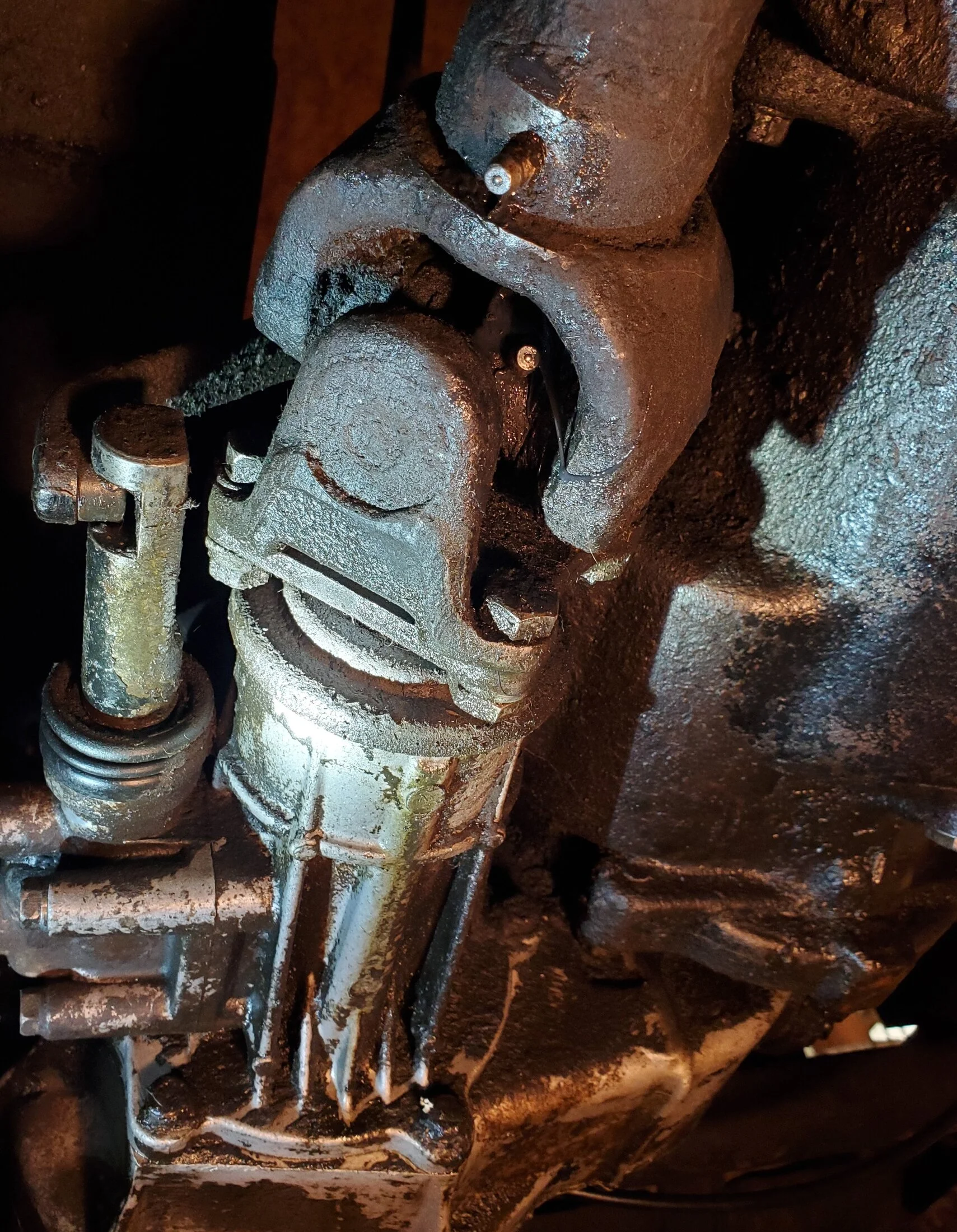

2) There was a slight, but noticeable up/down, left/right play at the forward output shaft of the transfer case (see pic), less than 1/8" total deflection by hand. Rotation of the front drive shaft is smooth and easy. Does that seem ok? Again, no obvious seal leaks there, so maybe ok at this point?

About the wobble in the front output shaft of the transfer case, would that be a worn bushing or bad bearing, and how difficult would it be to correct that problem? Can it be done without pulling and splitting the transfer case?
It could be as simple as tightening the nut, or could be the bearing. I think you can just pull the frt output housing. I think it's a stub shaft and the shift collar for 4wd is there.

Thanks, I'll dig into the FSM and see what's involved. Hopefully, it's not too bad to correct. In the interim, I'll avoid engaging that front drive shaft.

I've had some chores to take care of, but finally got back to that wobble in the transfer case front output shaft.
The front drive shaft came off easily from output shaft flange, revealing a loose stake nut on the output shaft.
I torqued it the best I could without the Toyota tool and restaked the nut. I'll have to circle back when I have more time and the correct tool to hold the flange in place, but it seems to have fixed the problem. Thanks for the advice.
