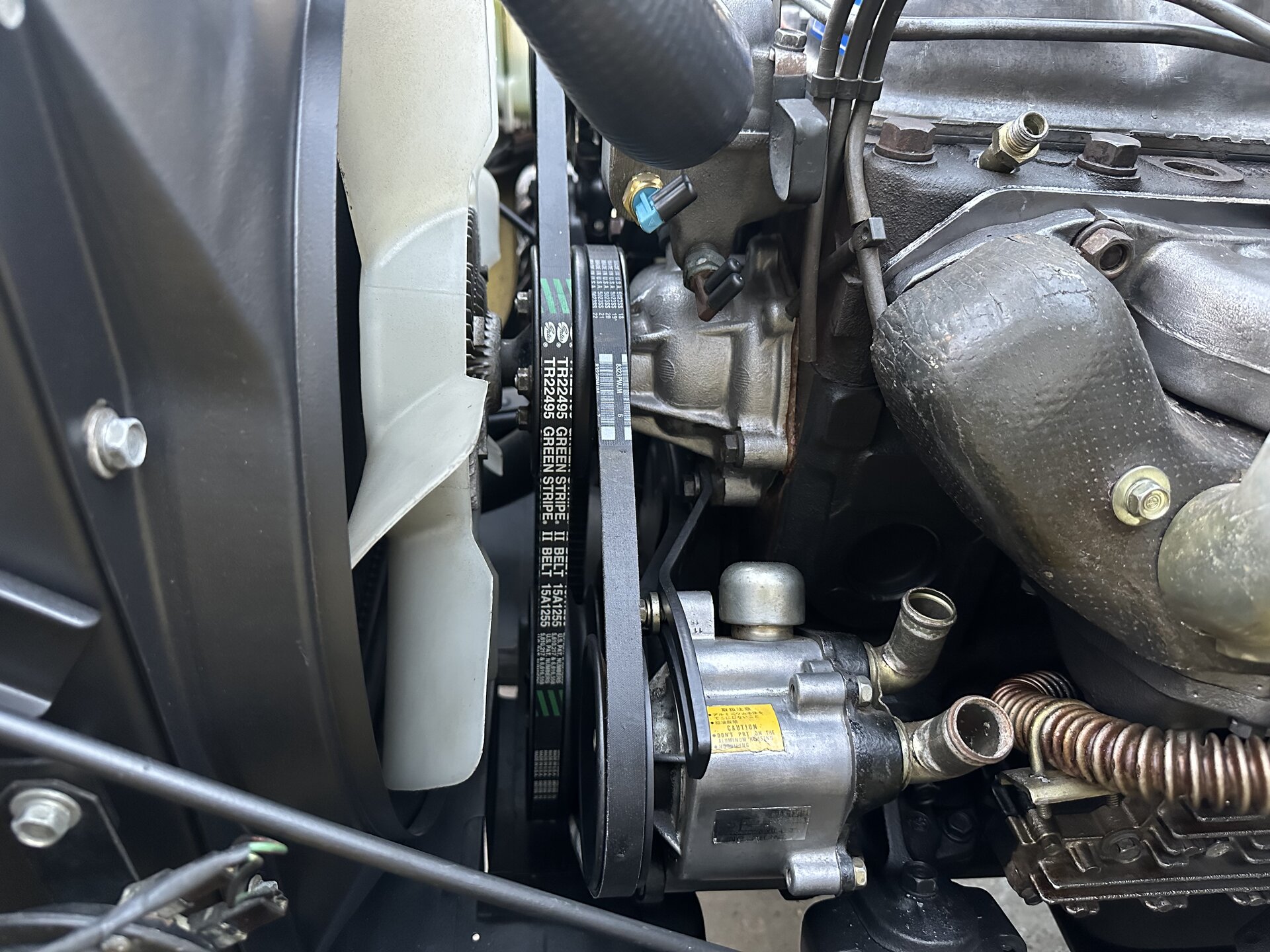

Got the smog pump belt on before I called it a night. Kind of sucks I had to take the alternator and fan clutch off to do so, but that’s part of wrenching lol
So the pump belt ended up being too short and causing the hose to go up right into the header. I read up about the recommended belt size (43 1/8”) being too short, but no one has posted a part number for a belt that worked. Ordered up a few different sizes and will report back with my findings.

It’s crazy how small a belt size change affects the position of the pump. The 43 1/8” puts it at the left of the adjustment bracket, and 44 13/16” puts it at the opposite end of the bracket lol. I got a 44” coming tomorrow 🤞🏼
