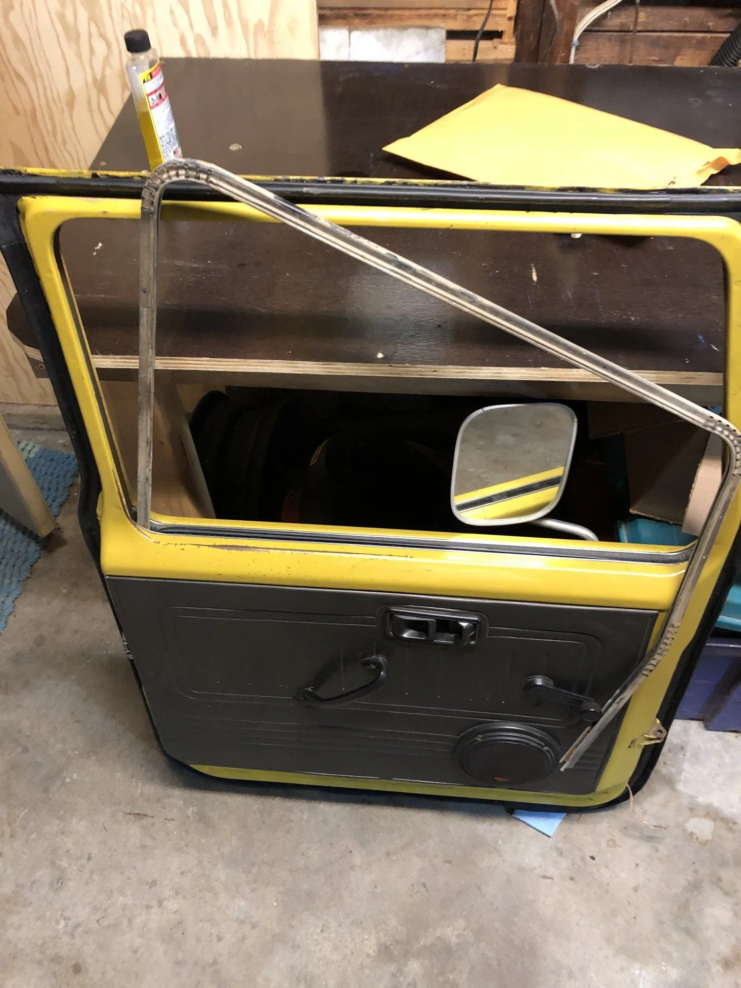

If you don't replace the channels inside the inner cavity of the door, only the U shaped one on top and two that run horizontally where the glass goes in and out, do you need to remove the glass? I removed the old ones last night, going to install the new ones as soon as Artie the mailman arrives..
Removal pic
