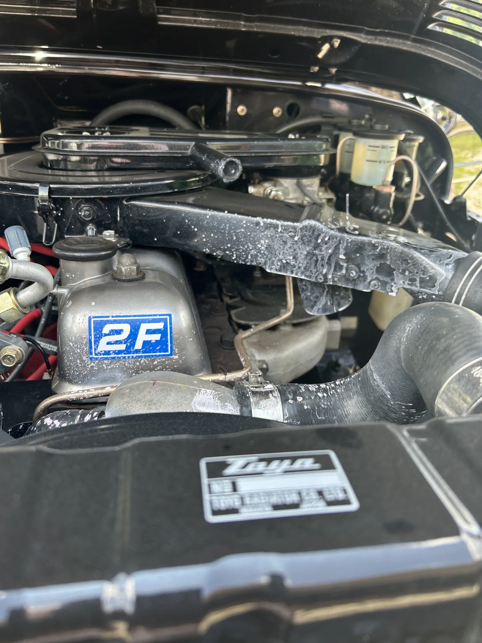

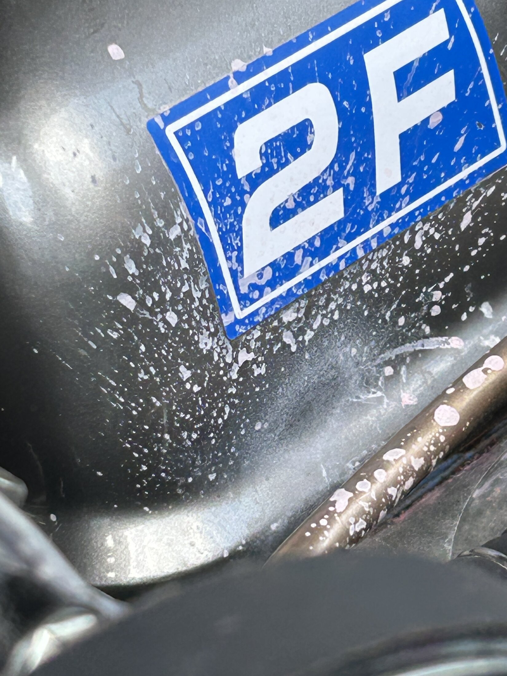

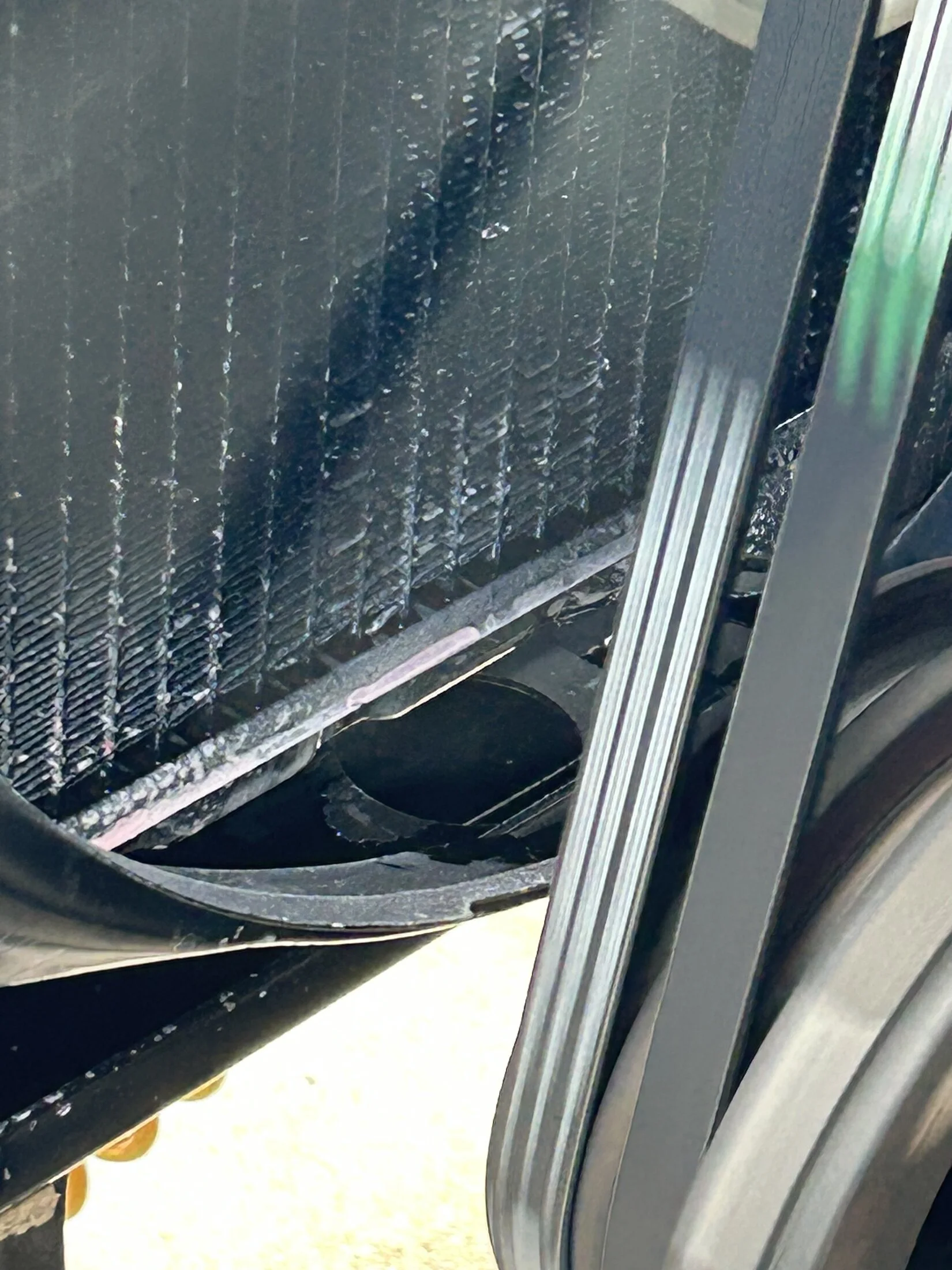

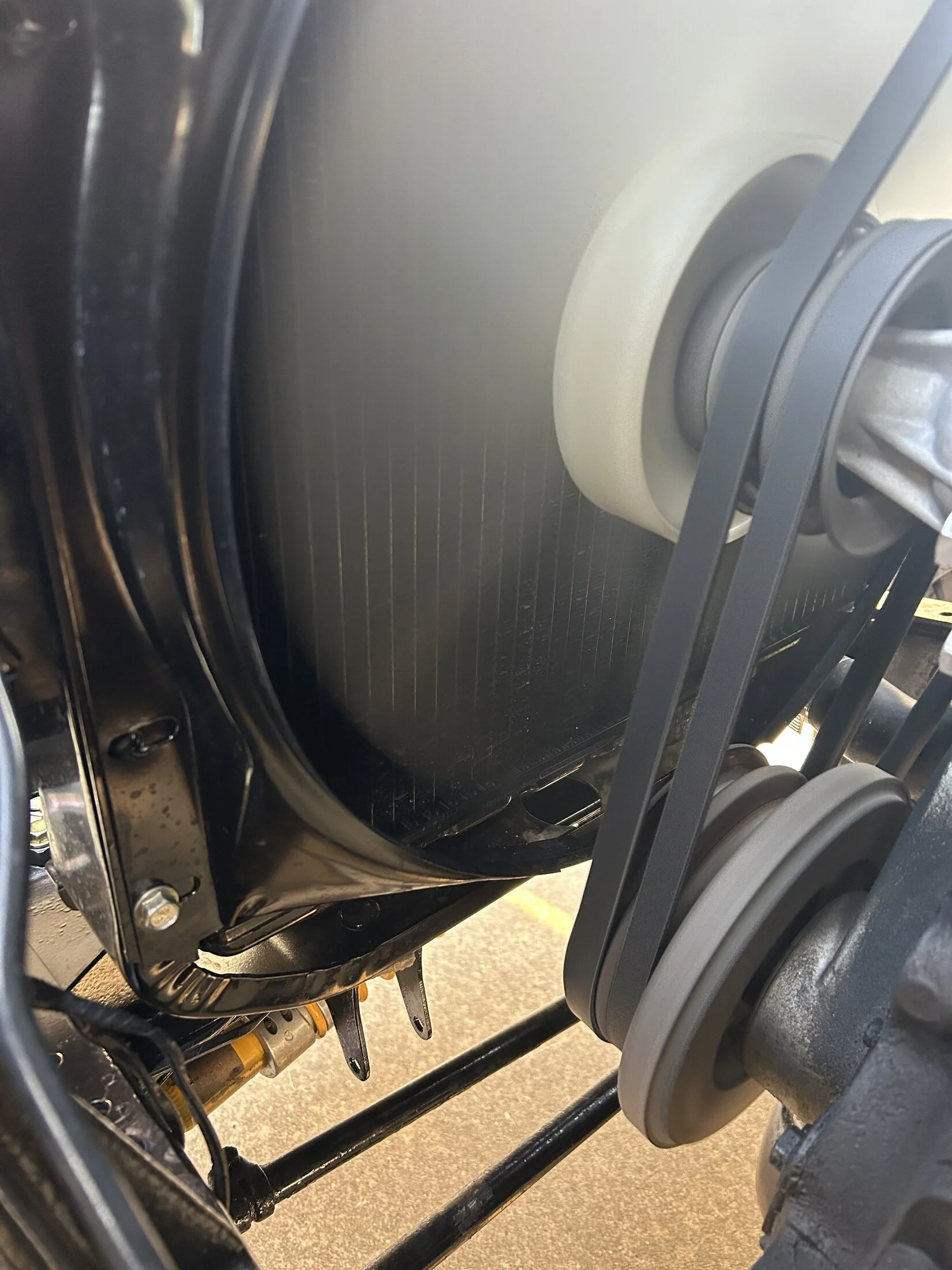

OE rad is loosing Yota Red/Pink @ <500 miles after installation. Gotta put this on hold until I can get a rad pressure test on it. I have a kit somewhere. Good news it’s in one of three storage blds. Shouldn’t take long to find.
No visible leaking while sitting in the BG (Thank God), I’ll put it under pressure and see if I can pin point the issue. Best case it’s not the Rad. Worse case it’s not the Rad…

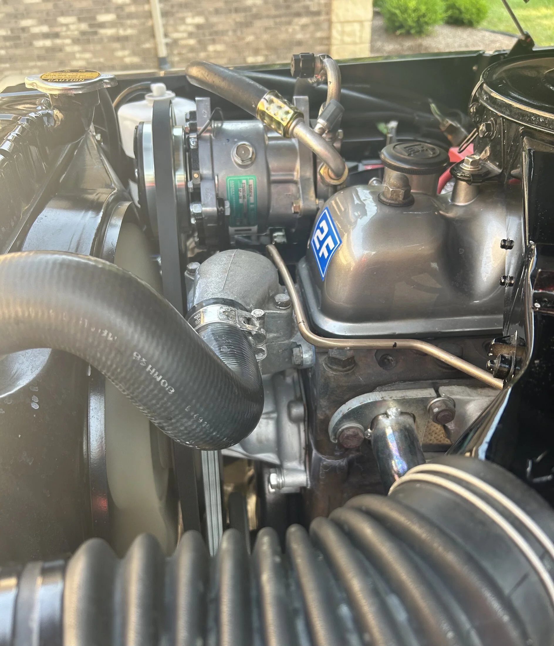

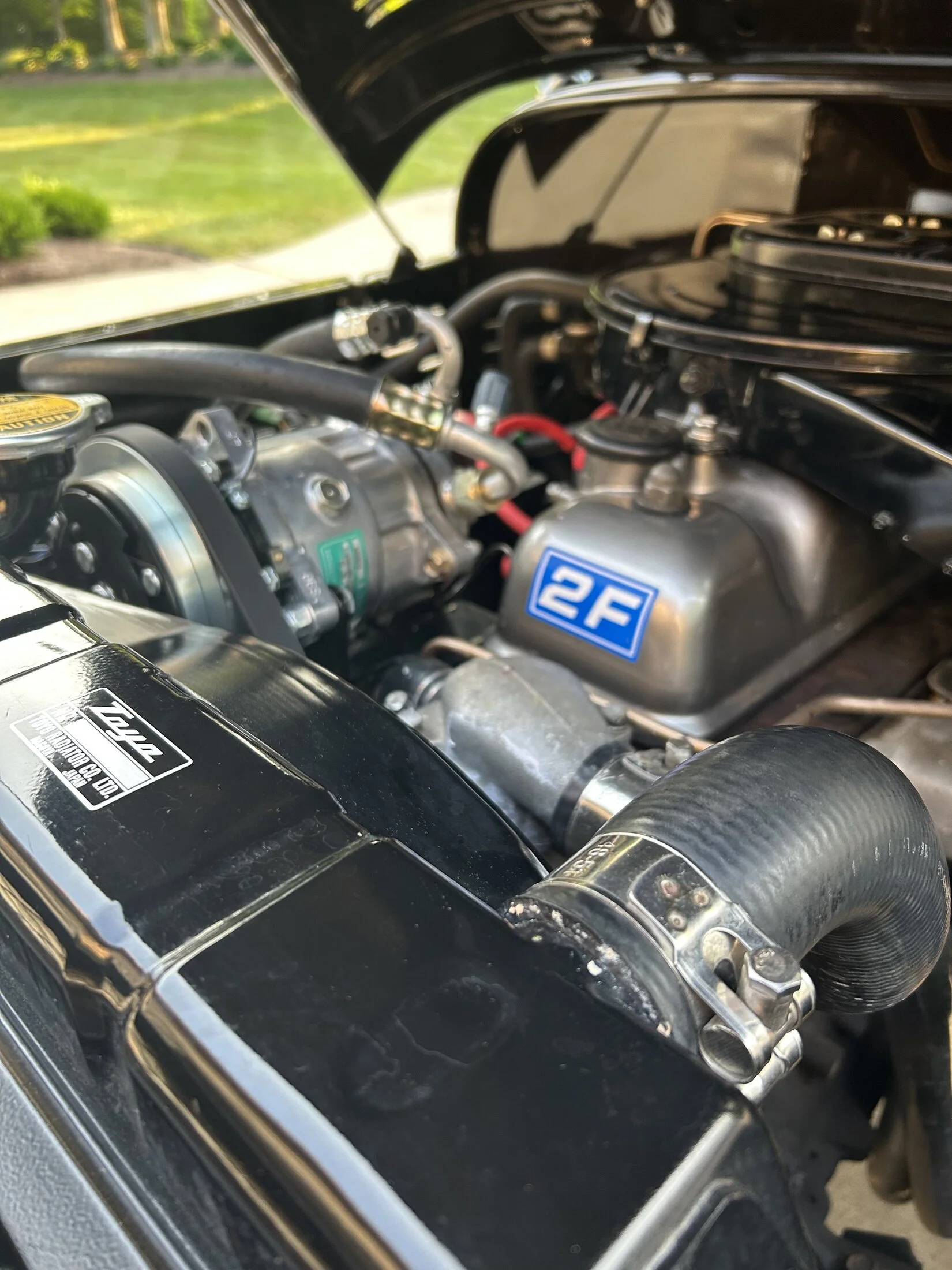

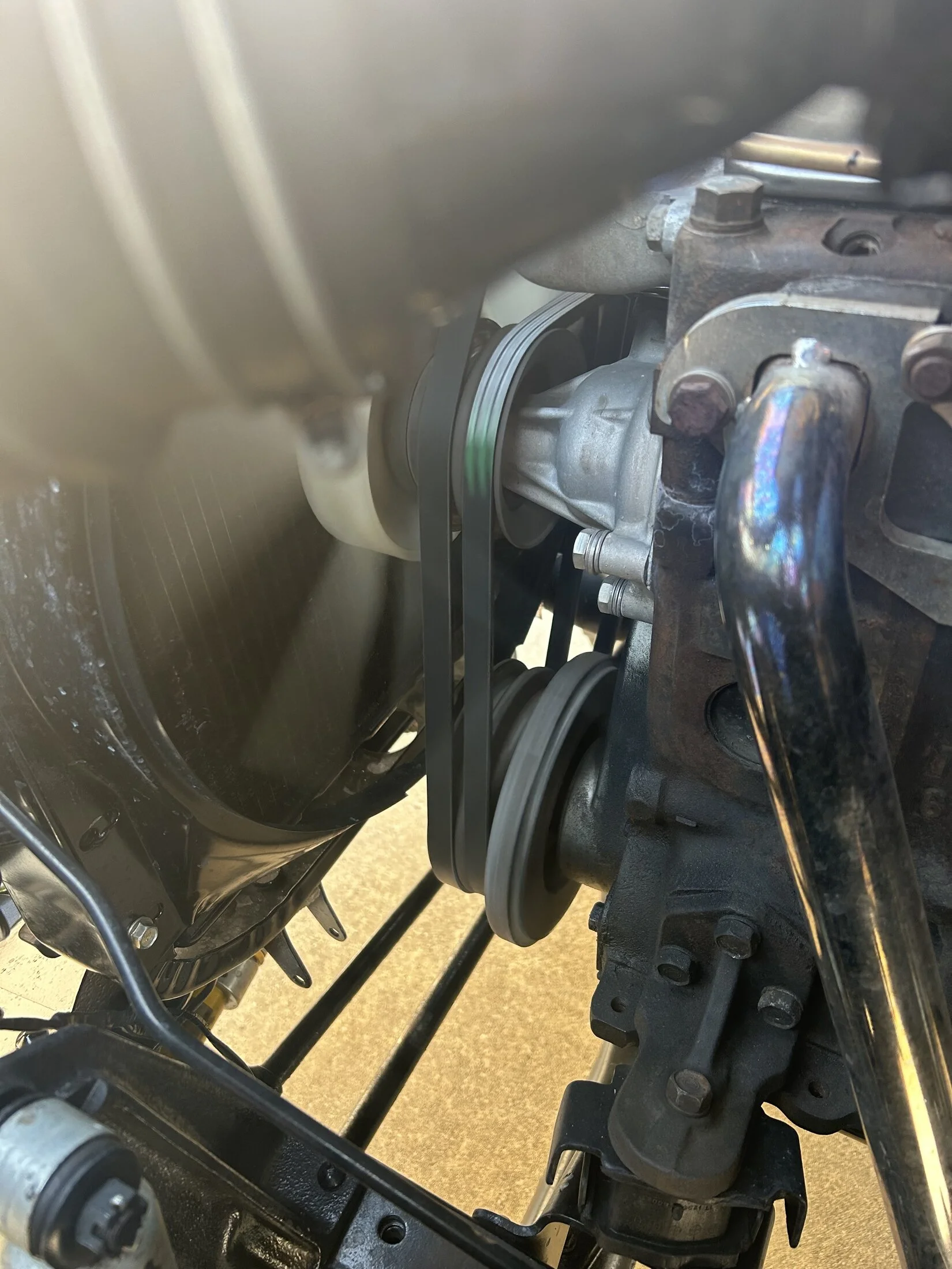

The veins on my forehead will have to wait, I skipped the gym today to spend a meaningful morning tightening hose clamps. After sacrificing a rooster and paying homage to the patron saint of driveway projects, I sprayed/cleaned as much fluid residue as practical and engaged.
Rad was exactly one fest stein shy of a full tank. Topped it off and let it warm up to operating temp. No drip or drizzle detected.
I’m headed out to the Meade Hall today to clean up and mow. I’ll wheel Che’ around the test course before I leave IOT see if I can detect any fluid trying to exfil through any of the usual exits.

Was running late so I went ahead and mowed this AM, gratuitous pic below. Immediately following, I ran 2.0 down to the test loop and pulled some RPM’s in the slow lane. Stopped at the Quickie Mart for a beverage and some ice. Filled up with high octane and pointed it home. I let it sit and idle for a few minutes before shutting down and popping the hood.
Yesterday, it looked like someone had blood sacrificed my little pony under the hood. Pink splatter everywhere. Today after cleaning the crime scene and doing a four mile hot lap, I’m happy to say, no drips, drizzles or leaks…So far.

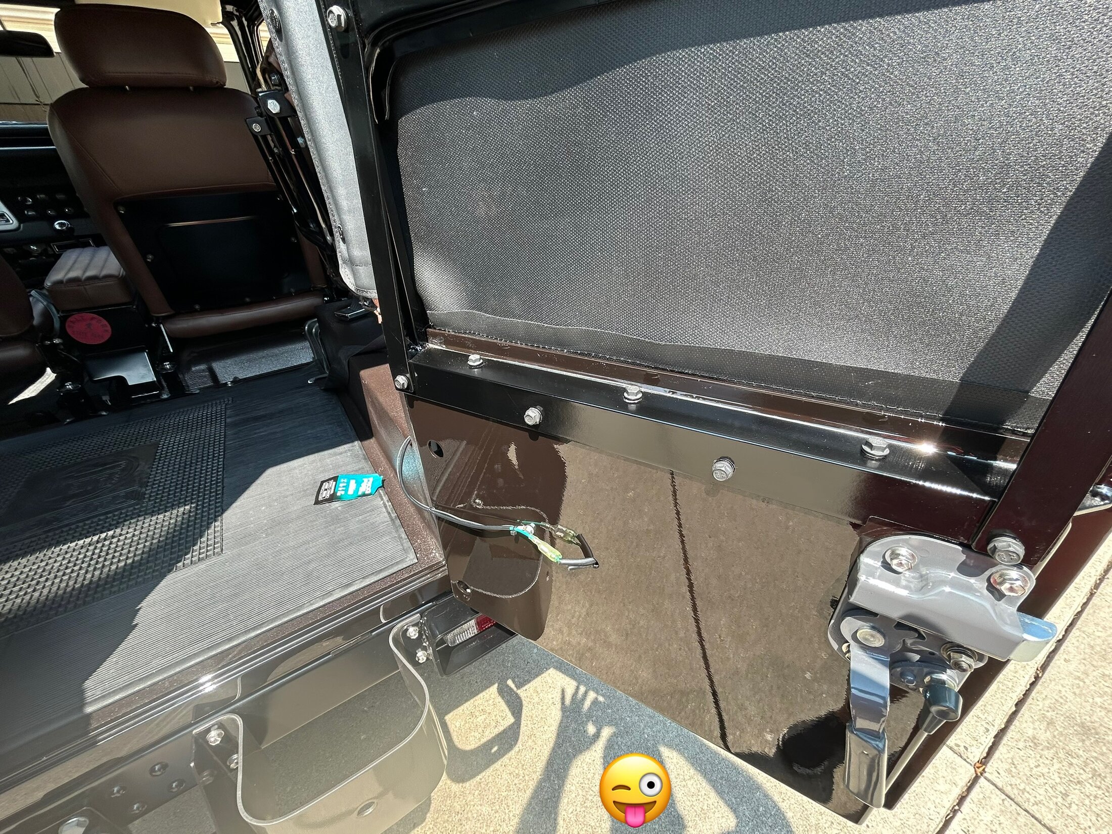

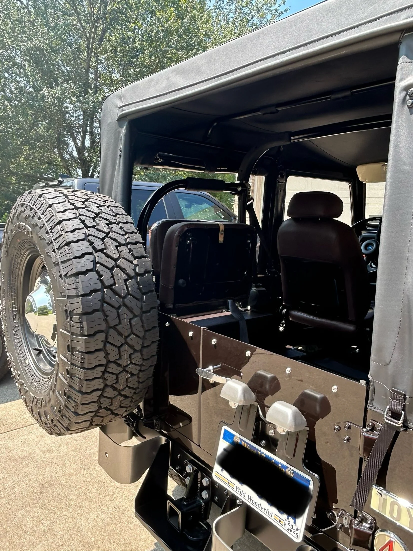

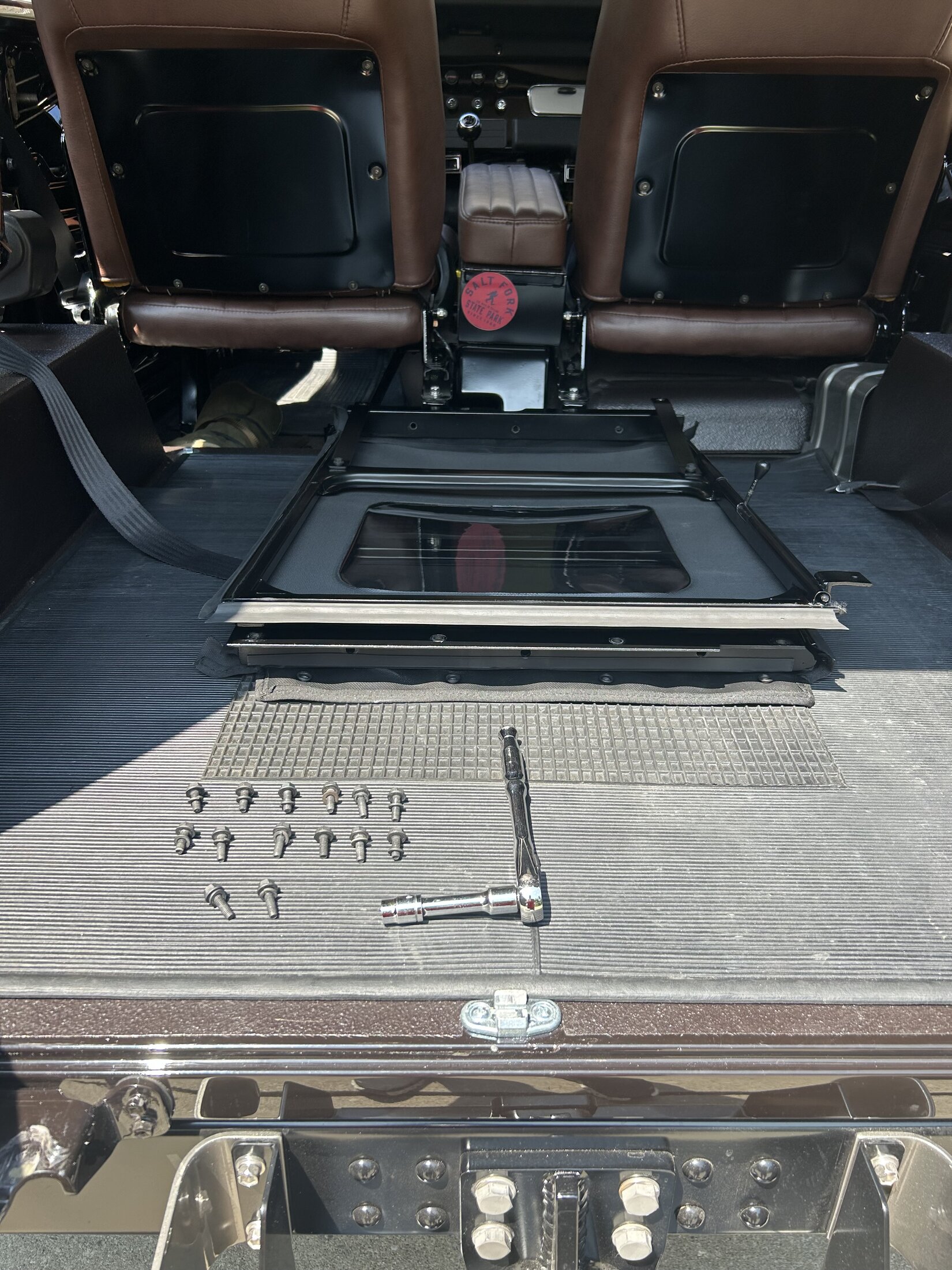

Wanted to show some of the details on the Columbian, Canadian Japanese kluge Ambi doors. 1st pic shows where the TROA section (top) was cut off and mated to an L bracket for mounting to the lower doors. Next, vertical stabilizers were added for rigidity and to prevent flexing/moment (👈🏻for engineering nerds). 10mm’s holding everything in place. Takes about 5 minutes to remove. End state = I get a functional convertible ambulance door.

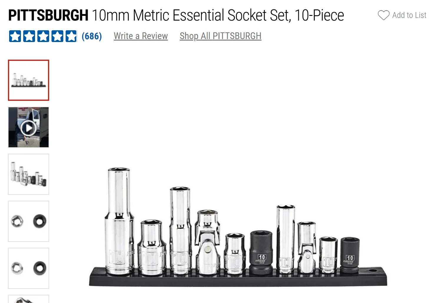

Since the whole conversion hinges on the availability of a 10mm wrench, you may want to invest in this set for cheap insurance. :)
