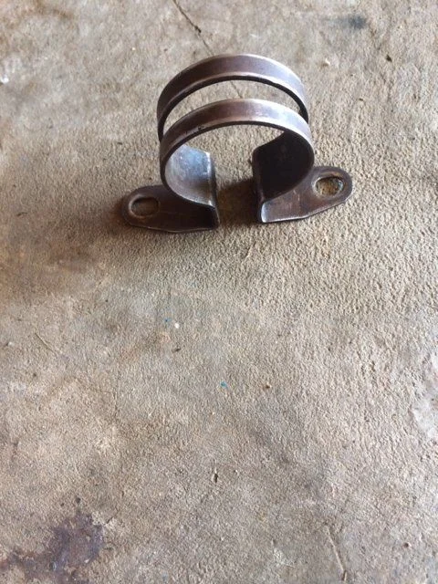

Coil mount rehab.. With no word from the paint booth, I am pushing on to some of the "smalls".

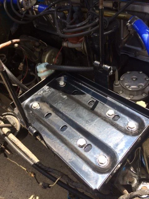

Mounted the new battery tray...Stainless hardware.

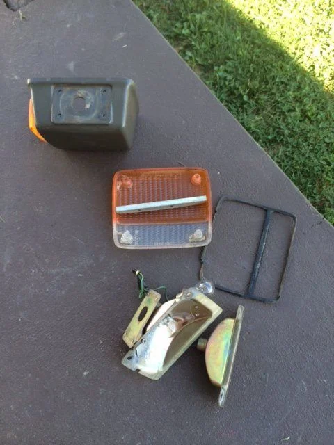

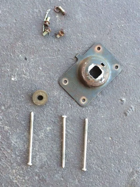

Starting a headlight rehab. Right lamp is minus a mounting post...Ordered new gaskets and lens mounting screws. Waiting to see how the lenses clean up before pulling the trigger on new ones. I have an aftermarket set of lamps I may cannibalize IOT keep the OE lamps in service.

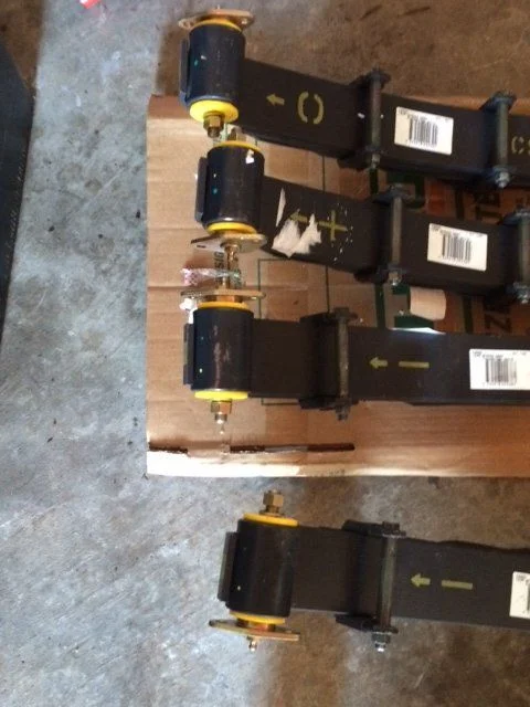

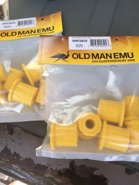

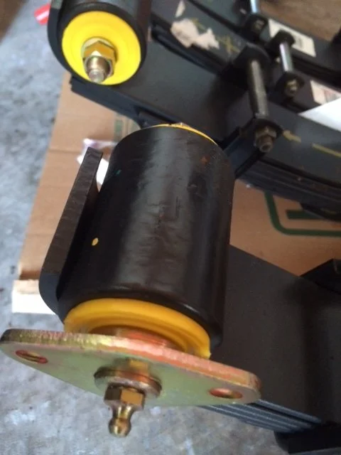

New OME bushings made it in too. Looking into September for the shocks...Rounding up some additional help for the spring install...Test fit for applicability/serviceability. Everything looks copacetic.....Still need to measure suspension travel to ensure shock fitment.

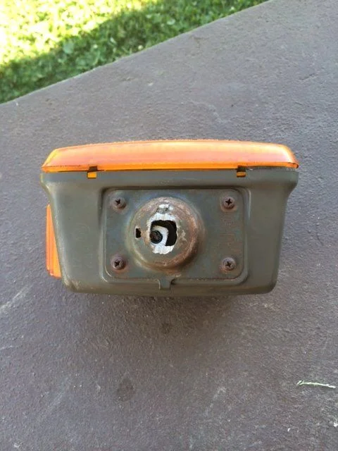

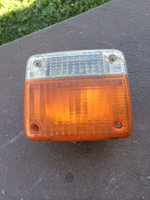

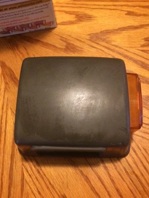

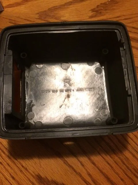

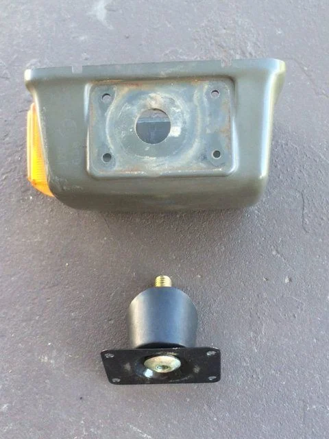

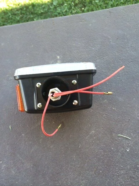

More "small decisions". :hmm: Hardly tech worthy but, necessary. 1st photo is an old aftermarket turn signal lamp. The base fits the OE perfectly...Again, not sure what I'm going to do but, this is an option...With the "Carb Swap" mission creep at full gallop, saving a couple sheckles is looking pretty good.

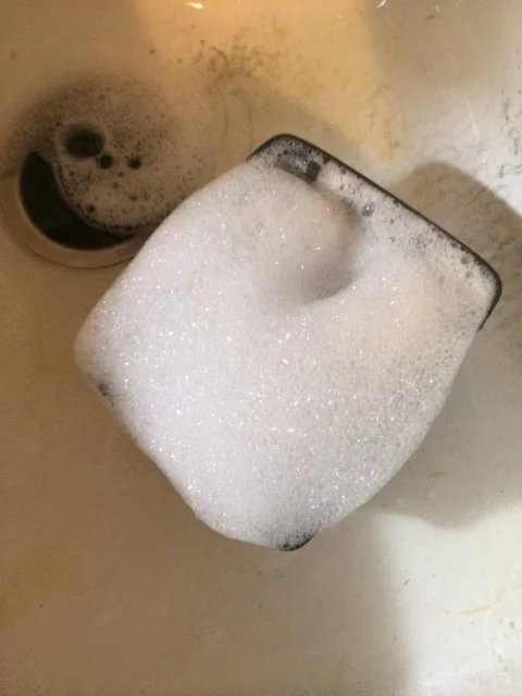

Gave the turn signal bucket the "Dawn" treatment. Will probably just hit the assembly with a good plastic polish. Everything was in good order minus the mounting post.

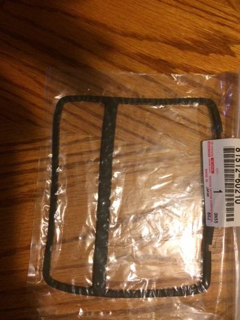

Gaskets and new hardware for the front turn signal re-hab.

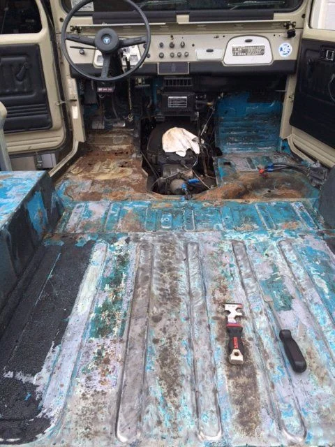

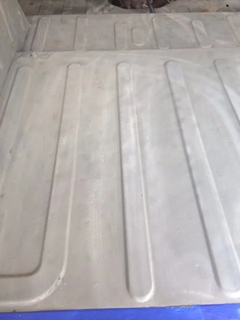

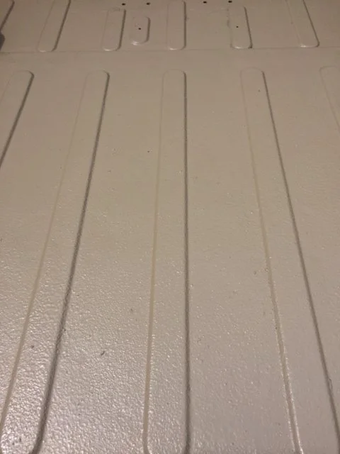

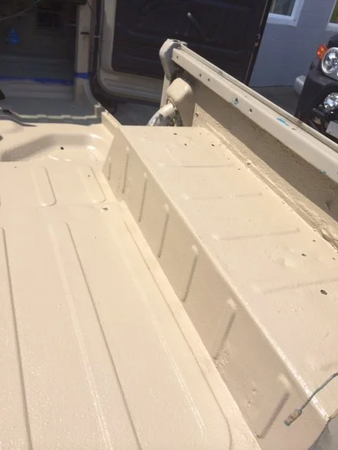

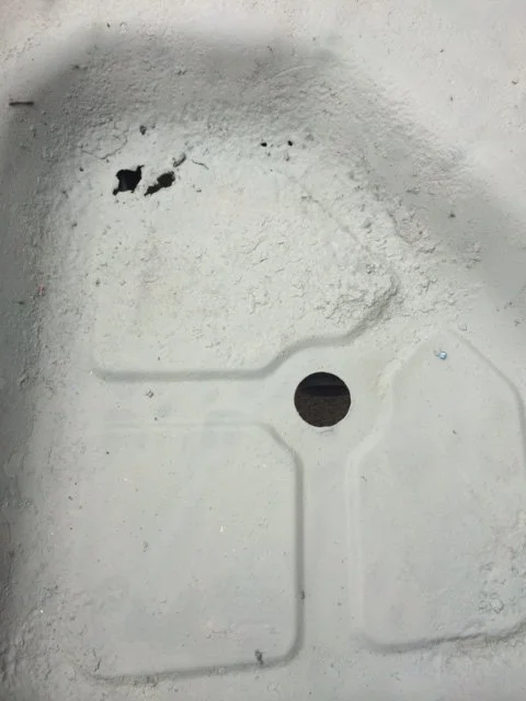

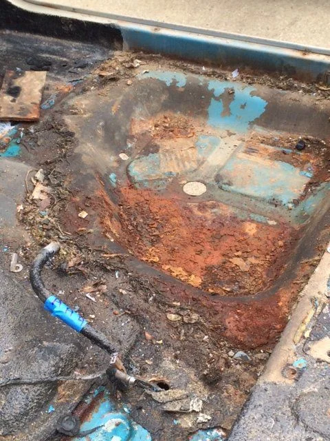

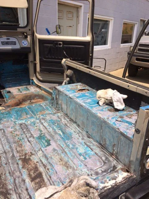

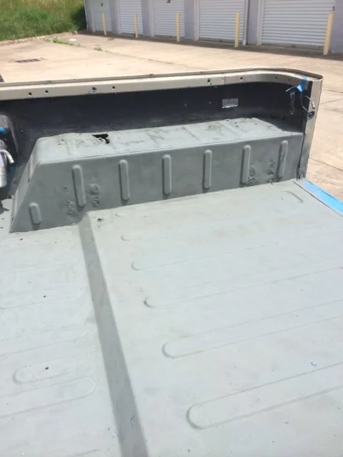

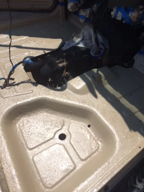

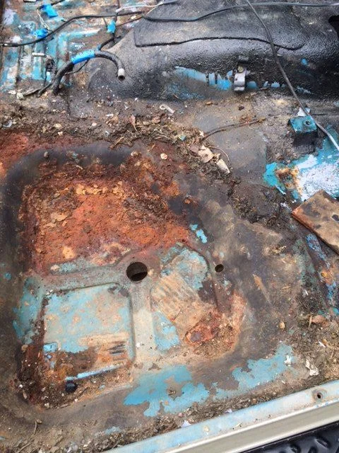

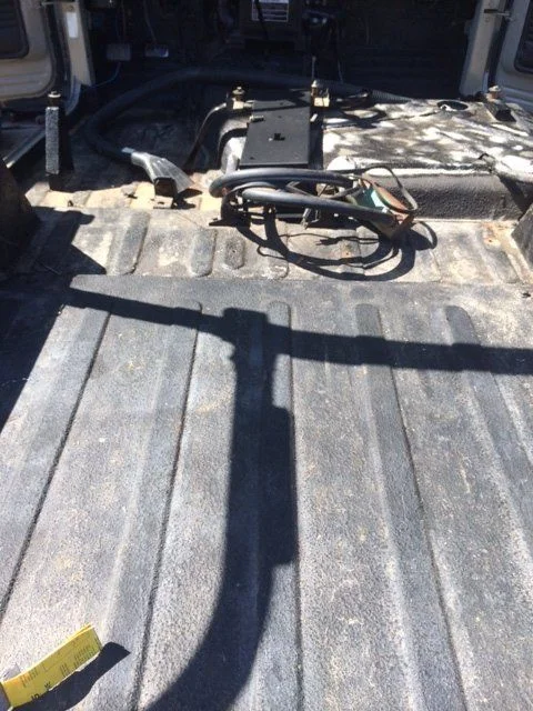

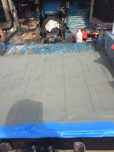

Cab floor re-hab. Before, during and after. Using MONSTALINER....I'll post a review of the product later. Used a "Desert sand" tinted.
More before, during and after.
More before, during and after round III
