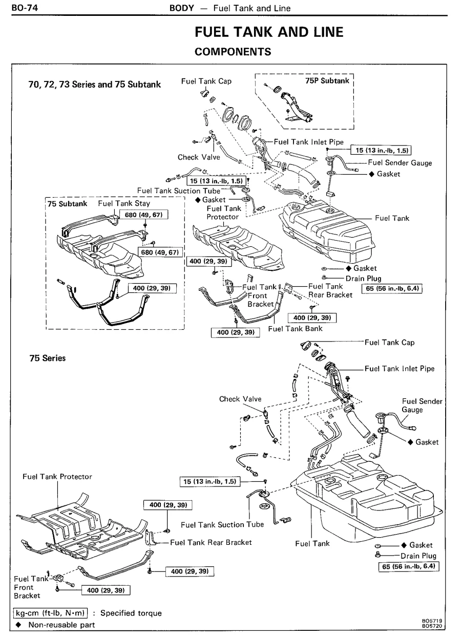

@Pako83 based on the following part diagram, it looks like those connections on your fuel tank go to the fuel-vapor separators:
That's up to you on whether you want to circumvent those, but they do seem to serve a purpose based on a quick search. Not sure what the new tank is ripped from, but it's not the same as yours, clearly. I don't know what the consequences of that tank would be if you installed it as is.

This is the way the tank is set up, from the FSM.
The manual refers to the rear tank as subtank.
One of the hoses vents to the body, and it is tricky to connect.
You can connect the hoses following the diagram above, and put a plug in the others.
Hope this helps.
Juan
