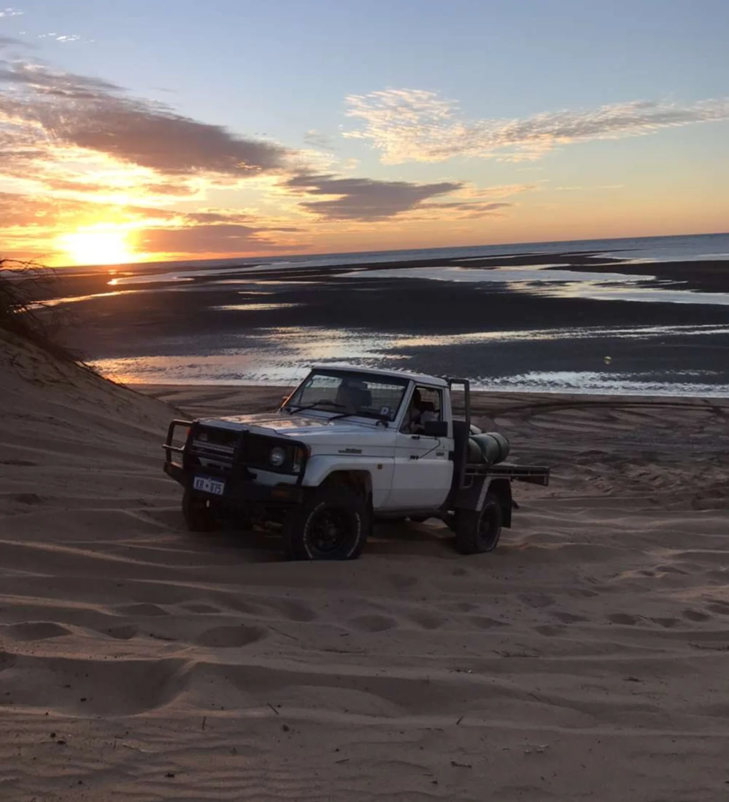

Hey Everybody, picked up a 1999 HZJ75RP about 6 months ago and I've finally got enough spare cash to do some performance upgrades to her.
It started off as a water tanker patrolling a pipeline in the snowy mountains (VIC), so it's got a big modified tray and beefy 1-ton leafs underneath.
It's got 208,000 on the clock, but last owner ran it pretty hard and took it out on salt flats etc. So it's got a bit of surface rust and chassis looks pretty rough.

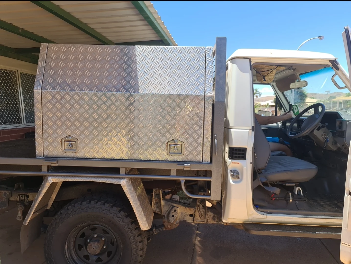

So far it's got new tires; picked up some Mickey-T Baja ATZ-P3s the other day, and I've grinded the tray back to bare, before respraying with hammertone charcoal and raptor lining the bed/headboard.
I've folded up some checker plate for the mudguards and fitted a dual Battery setup.
It's a bloody good car, really reliable and has gotten me everywhere Ive wanted to go, apart from the odd sand dune. Now I'm looking to do some big upgrades, and I want to do them right.
