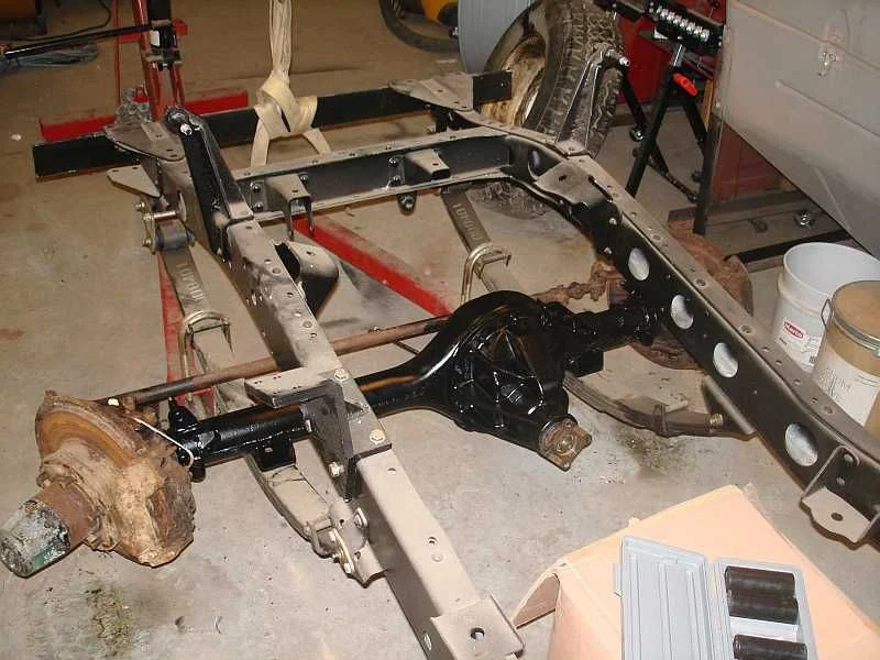

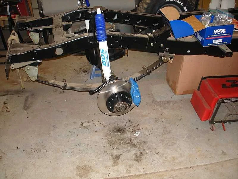

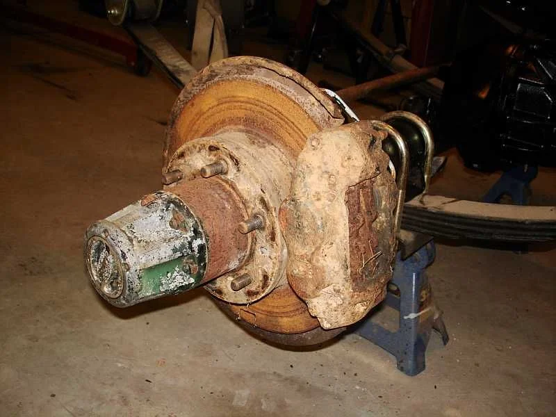

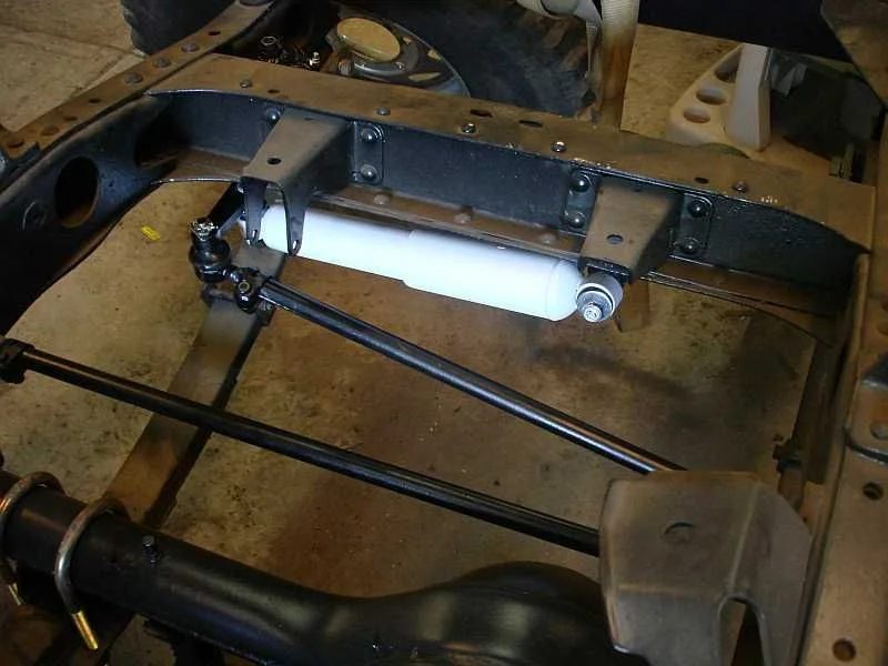

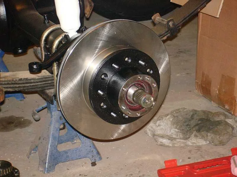

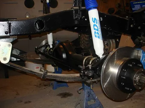

more progress in the past few months.......

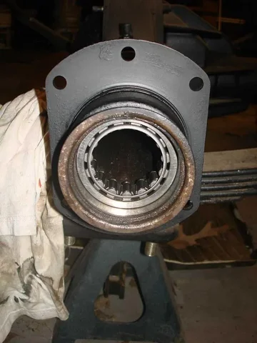

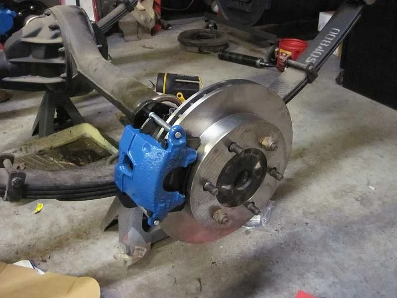

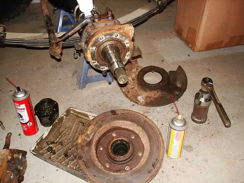

Swapped a 76 axle under my 75 for the disc brakes

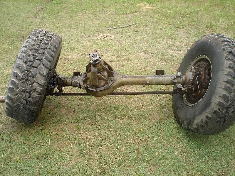

sandblasted rust off

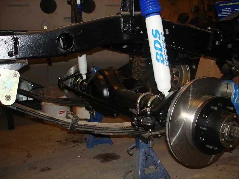

painted

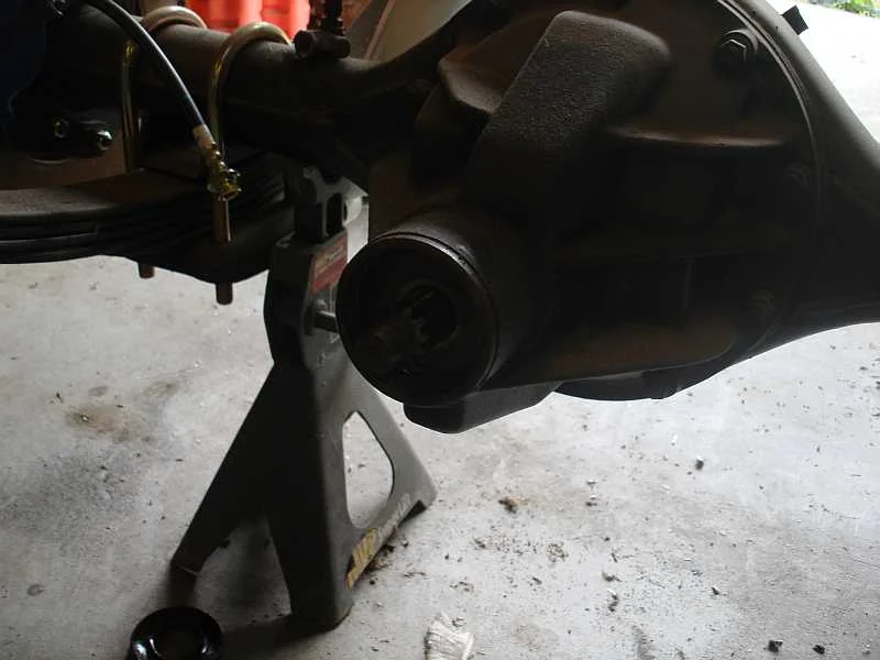

swapped

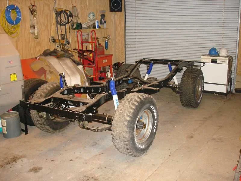

Nice. So whats next now that you have the rolling chassis.
Once I find a good exhaust manifold, I am going to finish up the motor, mate it to the transmission, and drop it in.
Also gonna have to go on over to Coolerman's site and dig up info on redoing my wiring harness.
I'm kinda in ADD mode now. I have several things going at once and no clear direction of what would be the logical next step, so I keep slogging along slowly and one day it might come together.:D
