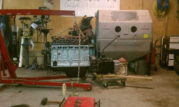

Engine mated to transmission. Went together with no problems which makes me nervous that I might have messed something up.:lol:
Used my "other" engine hoist to drop it in all in. I did not learn the trick to loosen the mount from the engine a little to give some wiggle room so I ended up breaking a mount which I will have to replace.
Rolled back in the shop.
I need to take some pictures of the front right mount that I broke to get some ideas on replacing it. Also, after searching, there seems to be some difference of opinion on Mud as to whether the "tab" on the square mount goes toward the motor or toward the frame.
