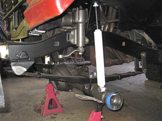

On the twisting frame issue with the scout box... my fab guy(probably same as pighead's) felt strong enough about the issue to add a support:
attachment.php
Of course, I'm a bit over built and the frame twist issue is lessened by hydro assist:o
Your radiator looks much bigger than the one I'm using for my Vortec. It cools my Vortec easily without a shroud:eek: I'd be more concerned over the capacity of the electric fan as I've seen more cooling issues related to electric fans that didn't flow enough.:meh:
That looks really nice... I'm not saying that the fab guy who built that steering setup is wrong about the possibility of the chassis twisting but I'm still having a hard time accepting that this fully boxed frame with sleeves is going to actually twist this frame.
I may throw in a similar style brace just for safe measure but in the mean time if anyone can prove to me that this is a real potential issue can you post some proof to the matter. I'd like to be sure that I'm not building something that is under built or unsafe...
Thank you Lil'John and Pighead in the mean time for expressing your concern... I'll be installing the extra brace today...
I have no proof, just anecdotal experience. I have seen an FJ40 frame twist in response to a steering box, and once you see it you'll have no trouble accepting it's possibility.
I think that the additional frame plating is as important as the diagonal brace.

In your case, with the 2F, I would definitely toss the brace in if you have easy access now. With mine, my engine mount is a cradle and adds another cross member right behind the PS box... you can just barely see it in that picture.
On mine, what you don't see is the sheer amount of plating my fab guy did on the outside frame rail in addition to the sleeving.
The sleeving is only to prevent the box from pulling off the frame. It won't prevent the frame from twisting.
My fab guy(FC Fab) is somewhat of a FJ55 expert. He has done at least six pigs that I'm aware of in addition to mine... with mine being the mildest of them all:eek:
Thus, if he thought putting that brace in was a good idea, I'll trust him.
I'll take your word for it... If the pig needs it, it will get it! Thanks for helping me prevent a potential future problem... When I put the diesel drive train in I think I'll add an additional crossmember as well for good measure..:cheers:

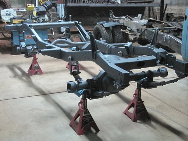

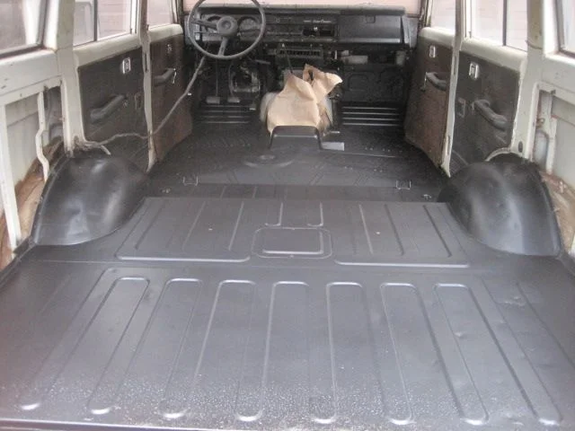

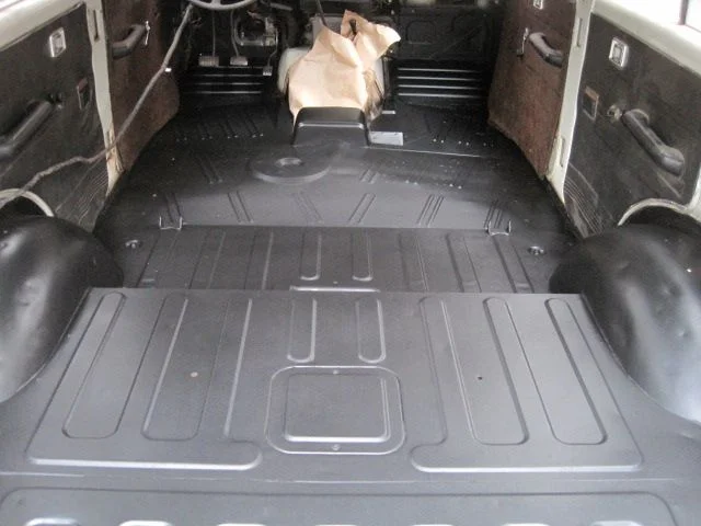

Long over due for an update!
Doug's been working on stripping the floor in prep for paint and undercoating.

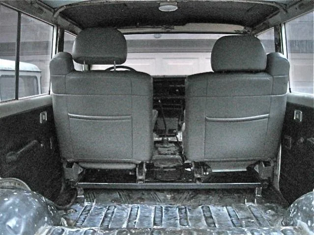

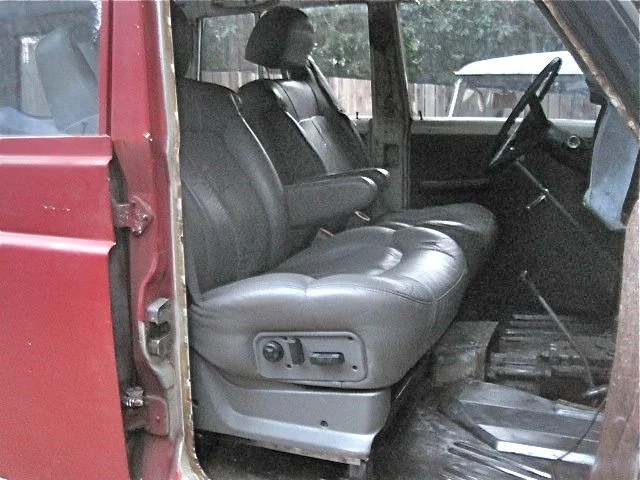

I worked on the seat frame which was a little challenging to say the least. These old pig floors have a million different contours to the floor, and setting up an even mounting surface proved to test my patients... I'm just about there! I fabricated a custom center cross brace to hold / relocate the rear heater which turned out nice.
Just have to weld int the floor plates to bolt the seat frame down, paint everything, and bolt it all in.
Bryan worked on the rear vents. He has been removing all the chrome from the plastic housing in prep for paint.

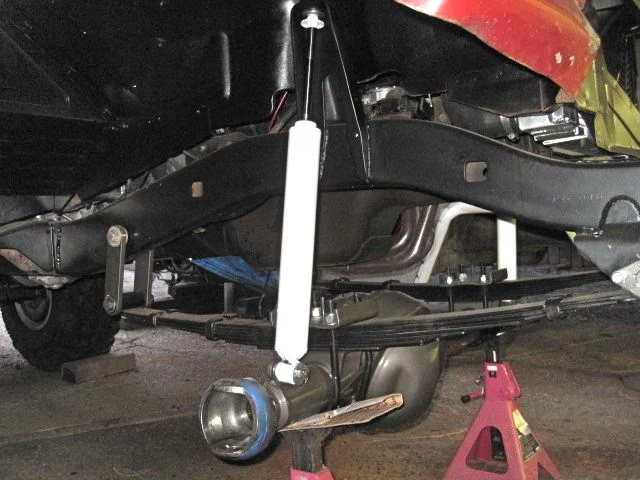

Front axle is installed, and I'm just waiting for Luke from 4X4 labs to send out my correct high steer kit... Hope to have this pig on the road next week if all goes well!
What did you paint the frame with?
Looks good!
I would have gladly traded you my vents w/ peeling chrome for yours... :frown:
My were peeling as well... You wouldn't have wanted them...
The frame was painted with Satin Black rattle Rustoleum... When the time comes for the wagons complete resto-mod it will look like this:

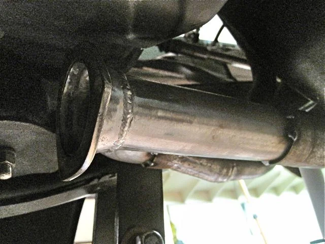

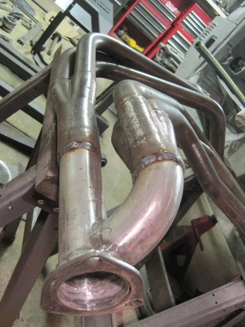

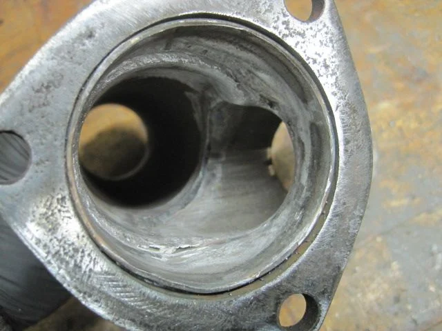

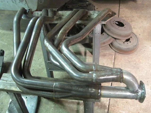

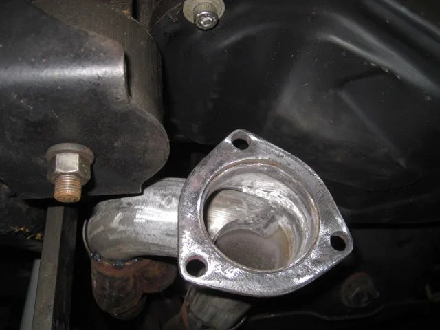

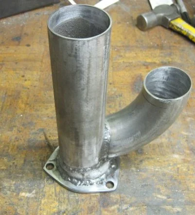

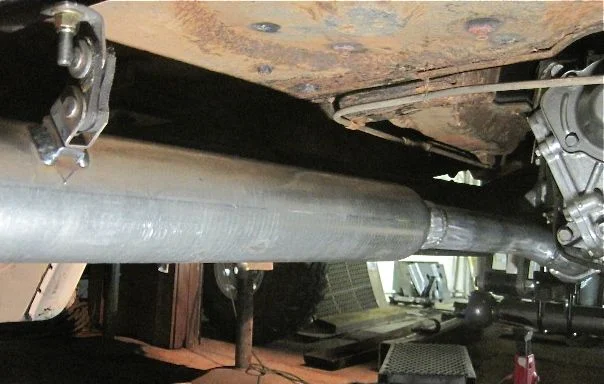

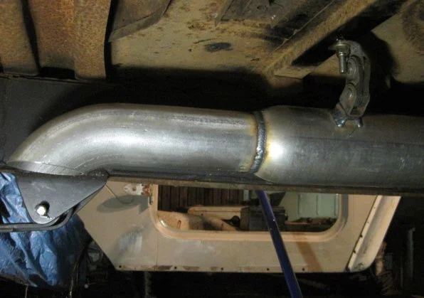

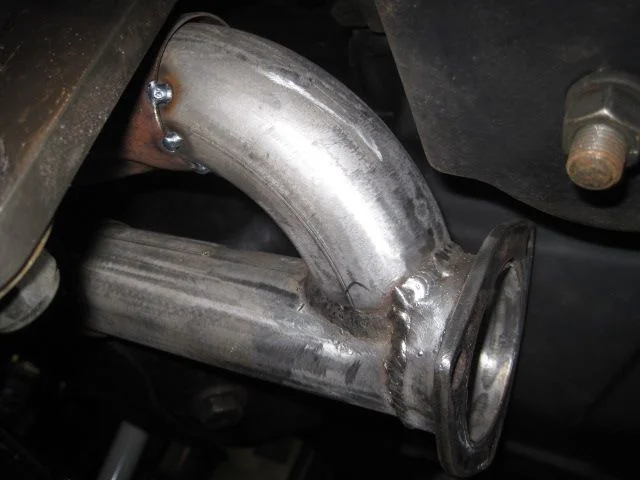

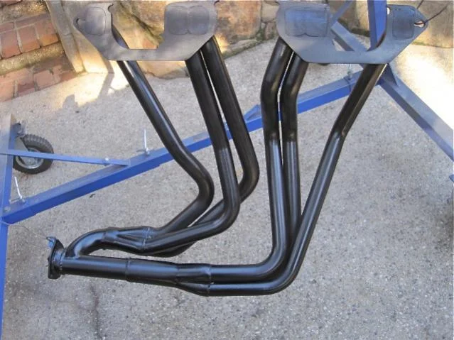

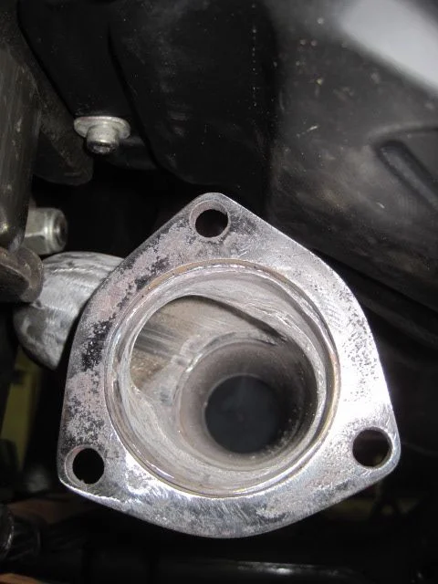

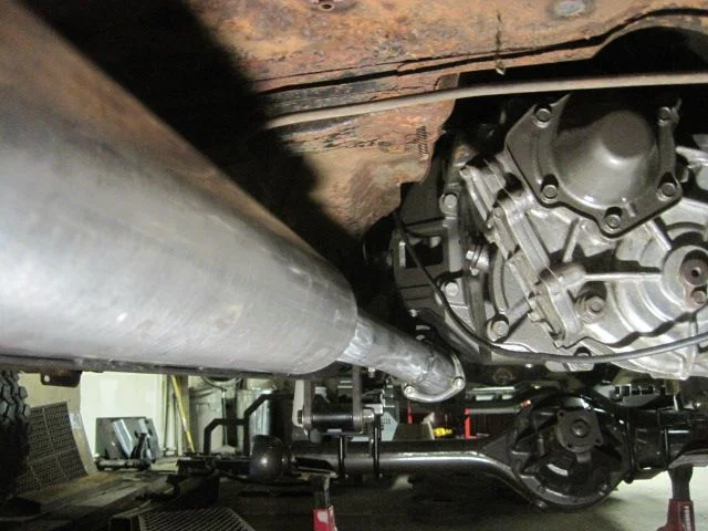

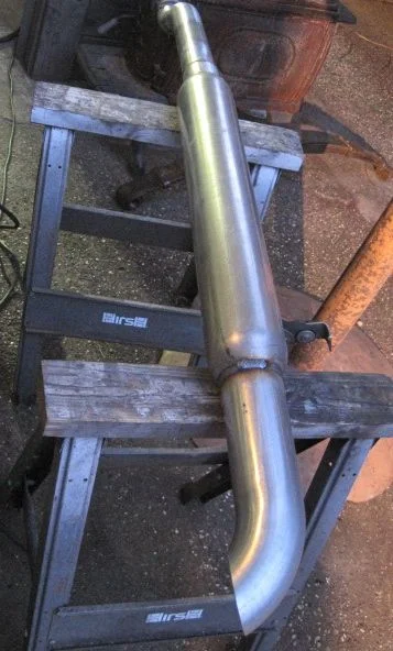

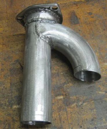

Finished up the exhaust today...
Stripped the headers down and painted them with a little high temp paint. I realize that heat paint doesn't last very long but at least it will keep the headers from rusting for a little while.
The rest of the exhaust system was built from a Magna Flow glass pack, 2 1/2" Exhaust tubing, (1) 2 1/2" Mandrel bend, and (1) 3" mandrel bend for the tail pipe.

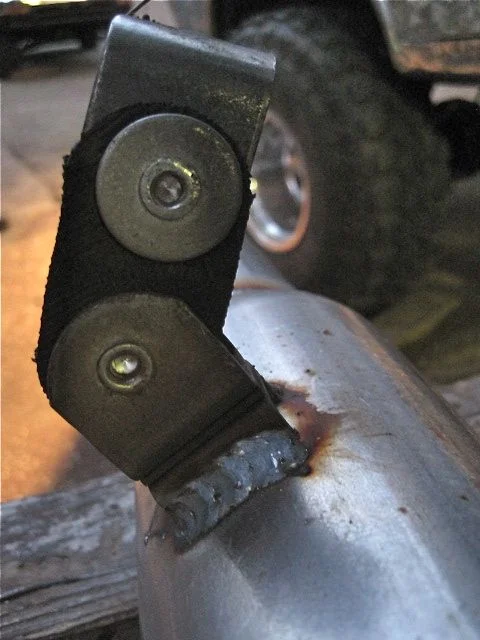

I welded a grade 8 bolt to the bottom side of the floor support brace for the hanger attachment..
