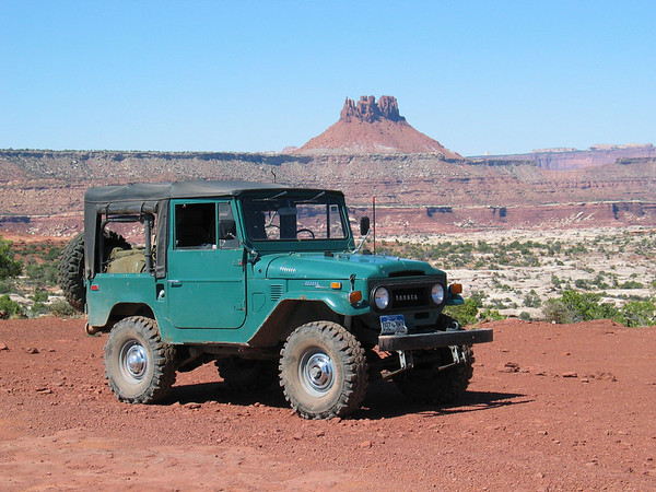

After selling my 76 fj40 in the early 2000’s, I had all but given up finding another one. Then fate took over and a buddy at work gave me a phone number of a guy who wanted to sell his. I didn’t think I could afford it but my buddy said he wasn’t asking a lot. As soon as I saw it I knew I had to buy it. He called it the Turtle, and had owned it since the eighties. I have spent the last two years working on it when I have time. My plan was to take care of the rust and bring it back to good mechanical condition, and preserve most of the originality of Turtle. This isn’t a frame off restoration, I decided to hold off on the frame off and have fun driving it. :steer:
I started with cleaning the undercarriage and frame and then inside the engine bay. Along the way painting with por15 rattle can paints and brush on formula. I then addressed the cooling system, brakes, exhaust, electrical, fuel.. under the hood. I converted the front brakes to disc and replaced the birfields and asin hubs from an early solid axle Toyota.

Onto painting.. I wanted to save the original paint, but after all the welding I made the choice to repaint with the same factory rustic green. After all later on I can always do a frame off restoration but for now I wanted it to look uniform and not a patchwork. I tried out the activated rattle can paint but ran out and wasn’t impressed with the overall thickness of the paint. I went and bought Omni urethane and redid the painting twice after I ran out the first times. Finally got done. Also, I painted with a small makita compressor that really struggled to keep up. I used what I had and someday will purchase a larger compressor.
After ordering some oem rims and painting them with Kubota rattle can gray. I went and cut out the rust in the floor and welded new metal and treated the floor to naval jelly before a coat of paint. I used epoxy rattle can paint. I might raptor-line the bed and floor later on.
I had to troubleshoot some signal light wiring problems, turned out to be grounding issues and corrosion on the switches. After my first test drive I found my rear diff shot. I replaced it and in the process learned there’s a particular way to put the spacer in the rear diff back in. I replaced the oil pan after oil leaks with a new gasket didn’t stop. I then found that the master cylinder was locking the front brakes on because the brake pedal rod was too far out. I also had the manual steering gearbox rebuilt along with completely replacing all the steering components. Now..Turtle is a lot of fun to drive but my to do list continues.. new clutch, 3 speed and transfer case overhaul, muffler, windshield and hardtop rebuild, jump seat restoration, and heater fan motor restoration.
I went and took a few more pictures of Turtle as she is now.. I have to admit it feels great to have gotten this far.
