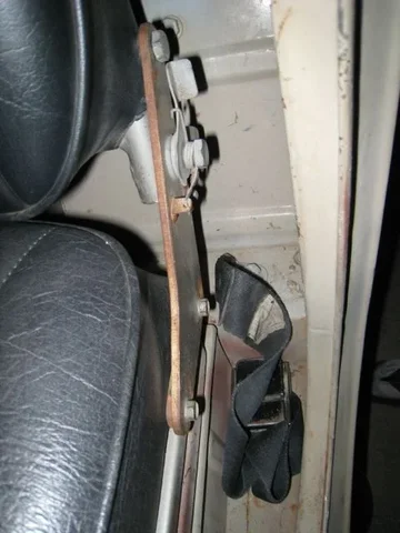

The other quick job was installing the bench seat hook pardion found for me - thank you again!
Now the drivers seat can be locked in the upright position with something other than bailing wire the PO used.

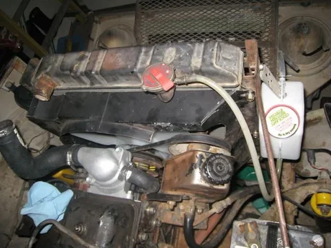

Finally got around to switching out the metal four blade fan with a plastic one and a new shroud. Thanks to 65swb45 for putting the entire package together: spacer, fan, bolts, shroud.
While I was in there I decided to address the cold running temps. It was strange, even in the middle of a Sacramento summer I didn't see the thermostat go over 150. Well when opening up the thermostat housing, and yes shearing off a bolt in the lower housing, I found there was no top gasket at all.

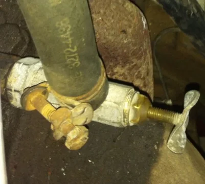

So fixed the thermostat gaskets and housing I managed to break, replaced all the hoses and installed a heater valve at the back of the block so if the temperature ever gets close to hot I can turn off the flow to the inside heaters. That should pretty much cover all the cooling system changes I needed to get done...
Tonight I finished the last couple of hose connections and putting the bib back on. Now the shroud is on it's harder to get around the front without dropping the bib, but I suppose that's part of the point - to keep fingers out :D
Next up is to put the fixed cluster back in and fill it up with coolant and take it for a test drive before the next job... knuckle rebuild and front brake overhaul...

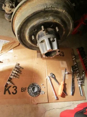

made things a lot more predictable. A few pictures to remind me of the order of things
Looking at the side of the lock nut it showed the last person in didn't use a socket. I was a bit concerned my Stanley Proto 50mm deep socket wasn't going to fit, but it did...

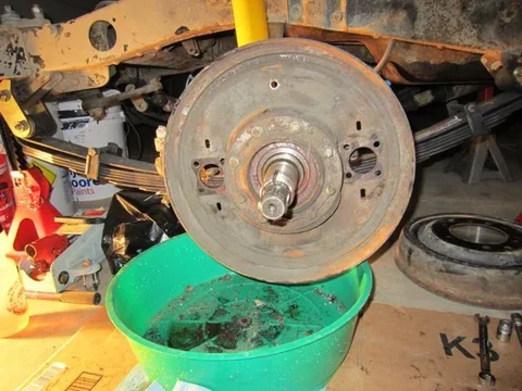

There was a lot of scraping to get the old mud off around the knuckle and some hammer action to get the wheel cylinders out. While I'm in here I'm replacing all the brake lines/components. The rubber lines are perished and after several bleed/adjust cycles it still pulls slightly to the right. I'll be using the 9/71-9/75 parts as the parts for 8/71 are discontinued. I see sor are doing a kit with the new brake lines to work with the 7/70-9/71 year:
http://www.sor.com/cat081.sor
But more on that when I get to it...

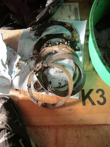

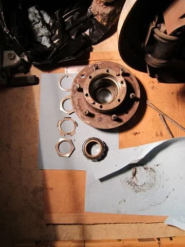

I was surprised the metal split ring and backing retainer (half moon pieces) are not part of the rebuild kits...

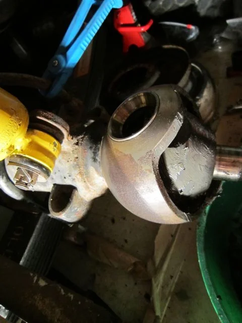

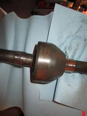

The ball is a little pitted and rusted, hope that's ok. There wasn't a lot of grease in there and some felt more like grit/mud. All the bearings are being replaced too, hopefully I won't have to go back in here for a while...
Some slight rust and pitting on the axle seal surface too :/ Well I suppose this is 40+ years for you and not the best upkeep...

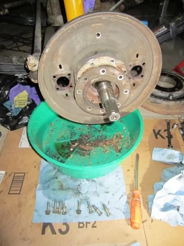

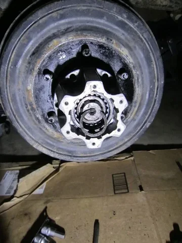

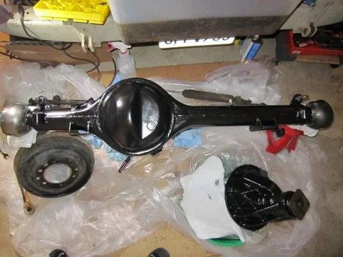

Started on the rear axle last summer and just getting back to it. So here's the starting point. Not too bad, but I'm putting on all new brake hardware and replacing the wheel bearings.
Stripped it down completely, driving out the wheel bearings with a piece of wooden closet rail I had lying around. If I ever have to do this again, I'll remember to take the diff out before removing the axle from springs. Had to re-install the axle and use a jack to free the diff. A good tip read here, but one I wished I'd used before taking it off.

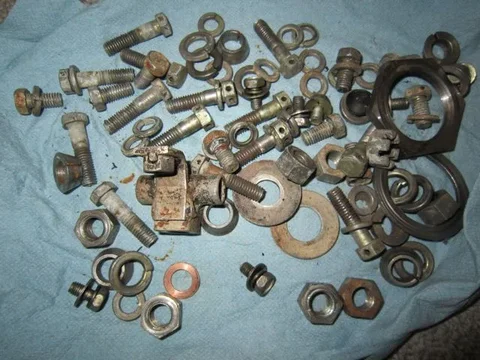

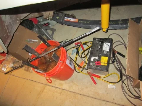

All the hardware and some of the larger pieces went into the temporary parts cleaner tub with an air-tight sealable top. These u-bolt plates are better, but they're headed to the electrolysis bucket shortly. The nuts, bolts and studs were soaked then cleaned off and are now tumbling in ceramic media ready for reuse. A couple of the diff studs needed their threads cleaning up with a 10mmx1.25 die.

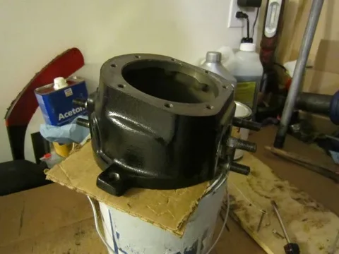

So a couple of weeks on rust removal in the electrolysis bucket, some more prep on the housing before painting and should be ready for starting the re-assembly. Well that's the plan anyway. A couple of hours each sunday morning a good way to relax and chip away at the job.
