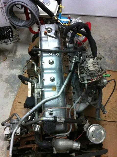

After posting a want add here I managed to meet up with BlueHZT60 and get a replacement 2F for my leaking sad 1.5F
It's missing an alternator and distributor which will be arriving later, but apart from that it's looking good. Thank you BlueHZT60.
It appears all the answers are here on MUD :) I figured if I was in a hurry my F alt and dist would work; the saginaw pump is better than the toyota pump so I should replace that.
One thing I have to work out is the belt routing. It has an airpump and A/C pump that I don't really need. The P/S pump will be replaced with my sag pump. Do I delete the non-needed accessories and re-route the belts? I think I just need water - PS - alt -fan
I've ordered the 2F FSM and hopefully help me get this swapped out.

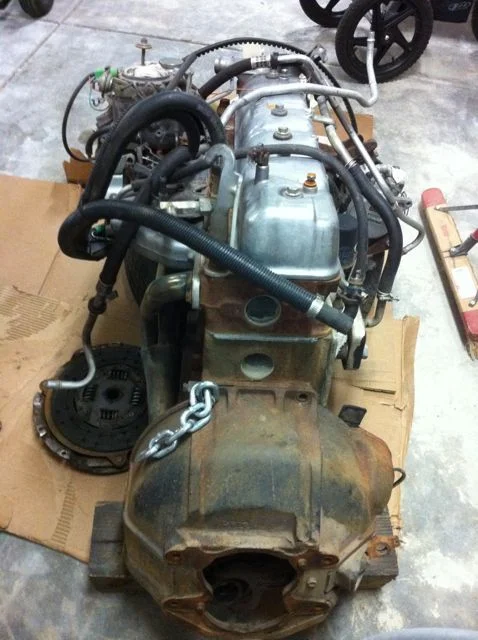

After thinking about it I'm going to keep the three on the tree and use my 1.5F bell housing, but replace all the clutch components (resurface flywheel) as they're juddering at the moment on the 1.5F. That includes the leaking master.

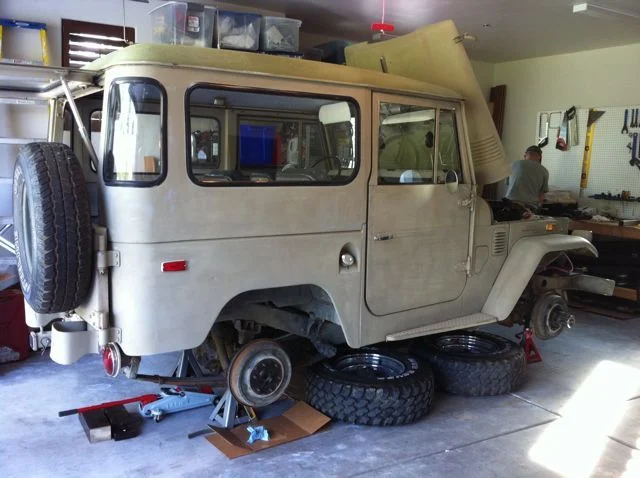

Spent the last couple of weeks when I had time disconnecting all the engine/driveshaft parts ready to pull the 1F out. The hardest part was probably the three on the tree shift linkages. I finally figured out there is a 9mm flat to help keep the joint from spinning while removing the ball joint nut.
Before I went to remove the 1F I checked the 2F and found the crank won't turn to get the clutch cover off :/ Yeah my fault for not checking in the first place. So it's sitting there with some oil in the cylinders, and I've ordered some Kroil to see if it's just the pistons siezed up. A couple of the plugs were rusted when I pulled those. Hopefully soaking it will get it free. Otherwise the strip down/rebuild route is next.

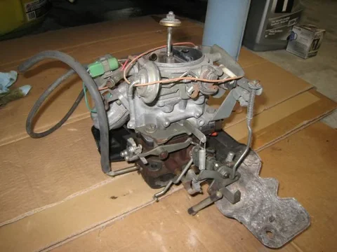

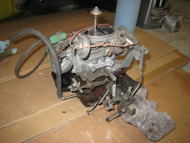

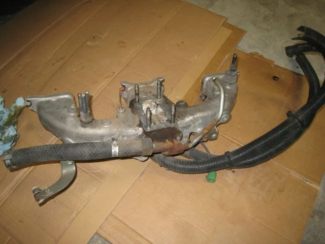

So more time on the 2F: the carb accelerator linkage was frozen so with some PB help took that off, together with the inlet and exahaust manifolds.
The carb butterflys were corroded in place, so that answers why that wasn't moving
There is an aftermarket carb base heater

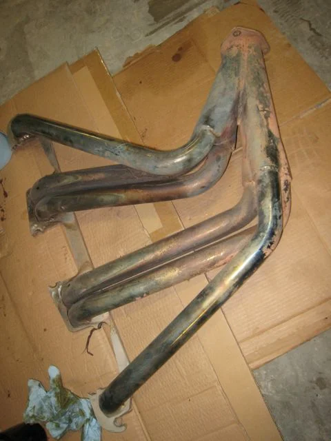

Finally the headers came of, looking the best of the bunch. Shame as I'll probably keep the F exhaust manifold to avoid any hangup on the 3spd linkage.
