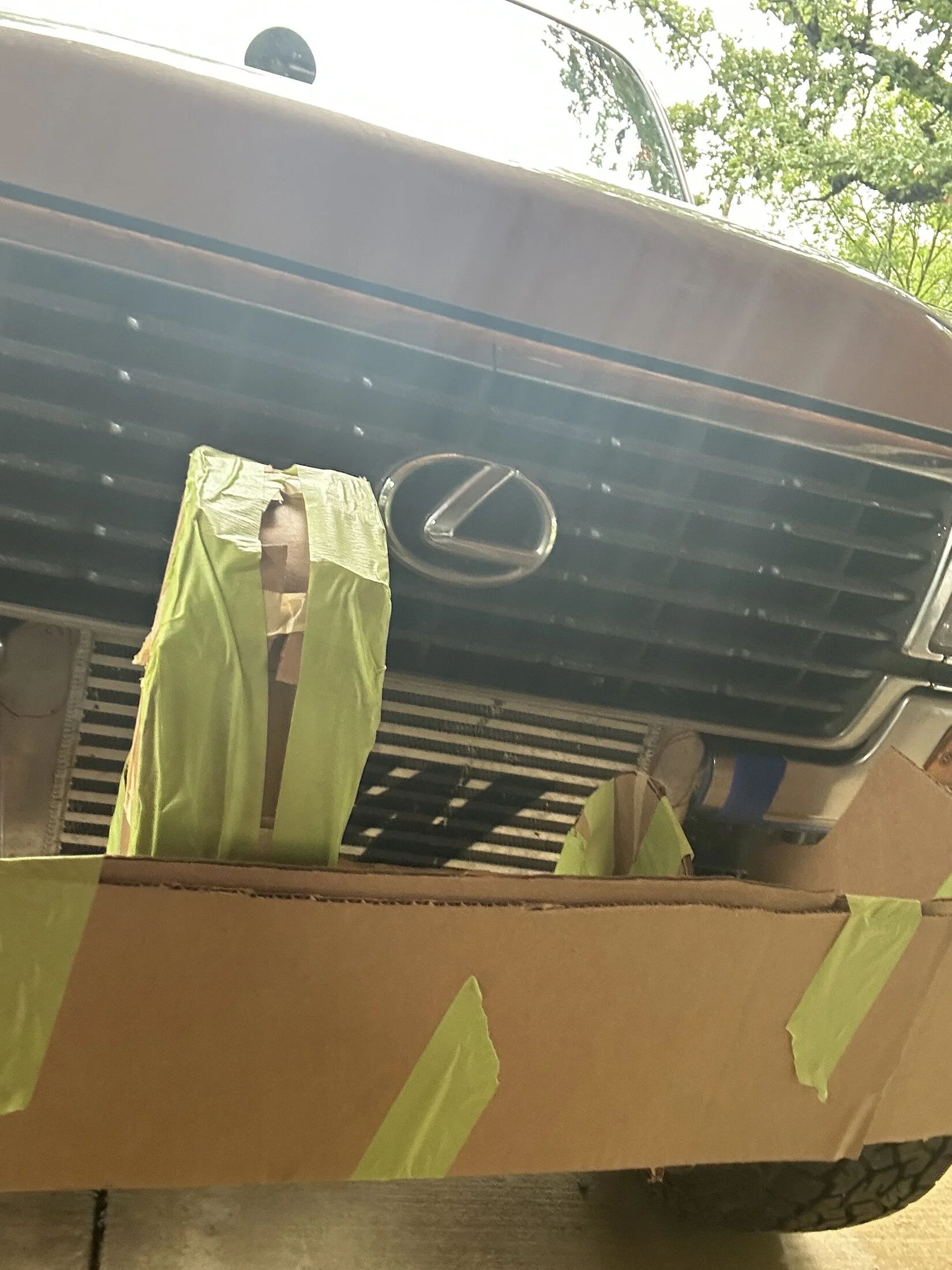

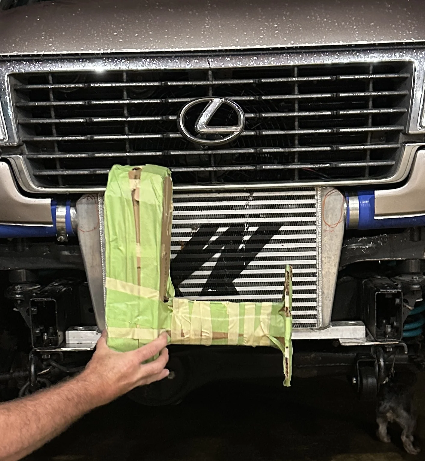

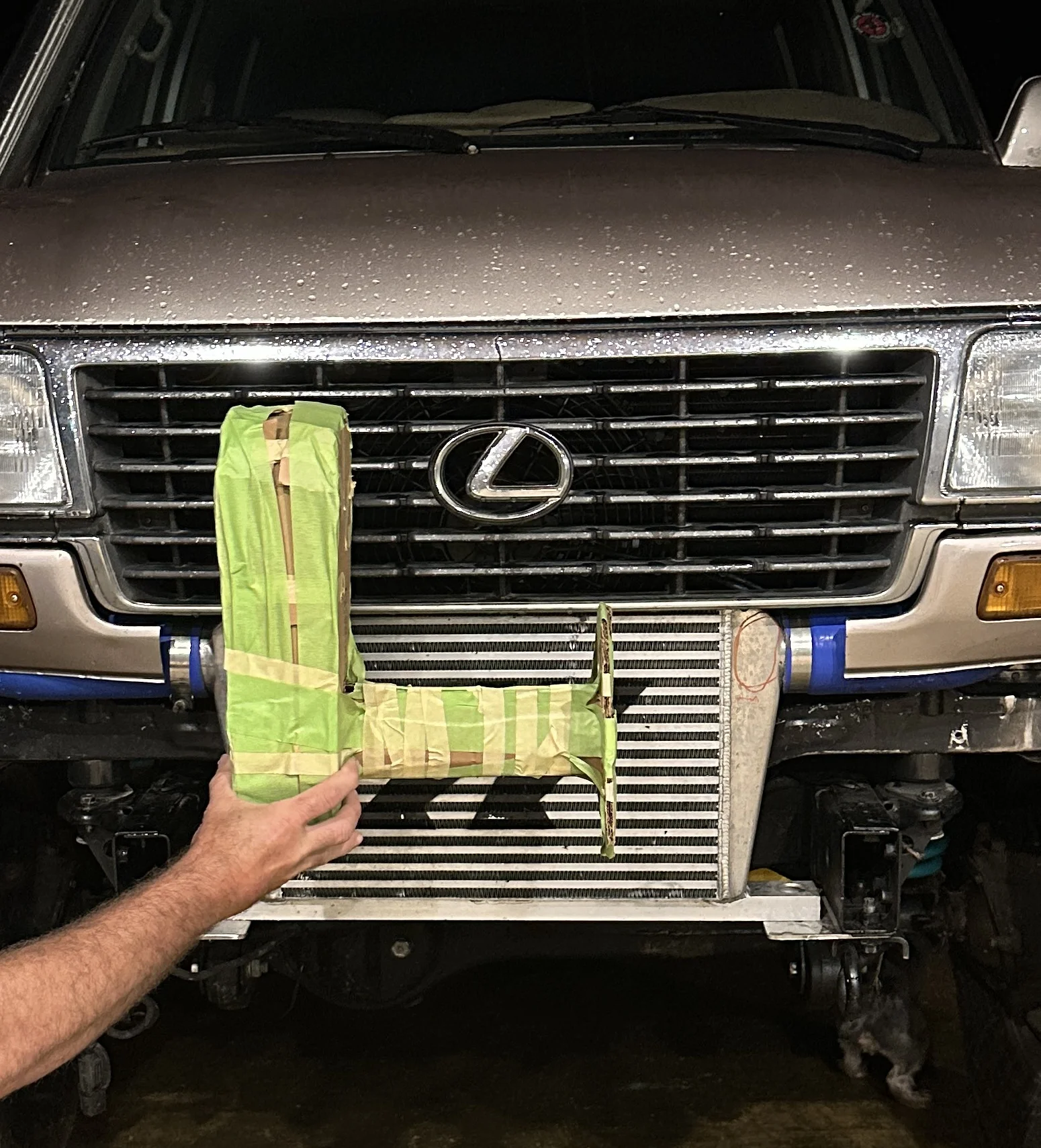

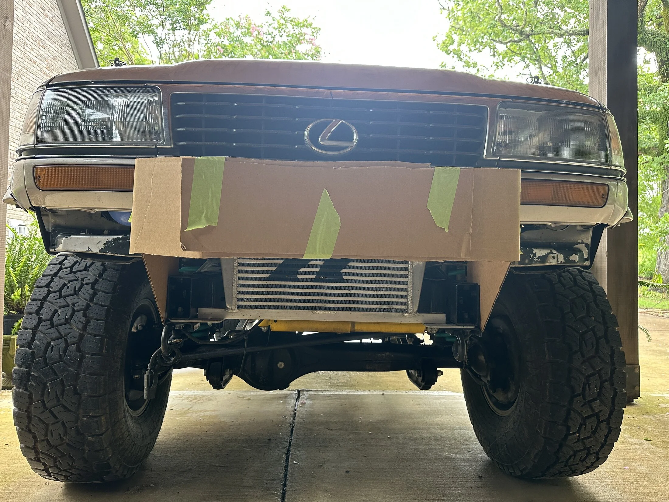

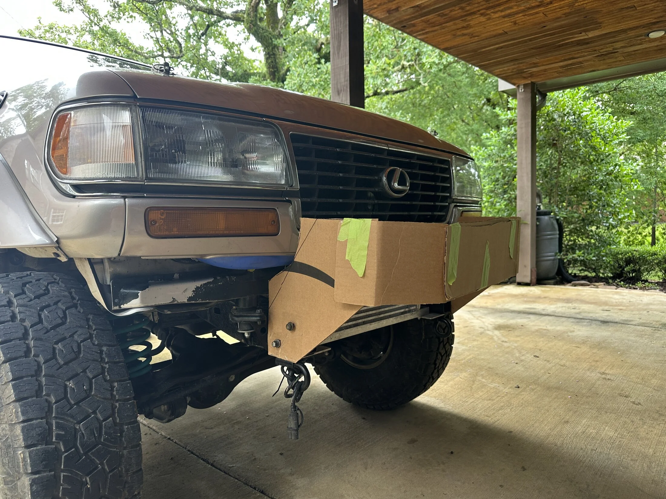

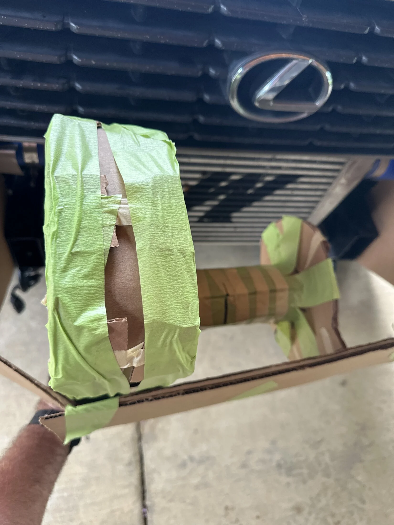

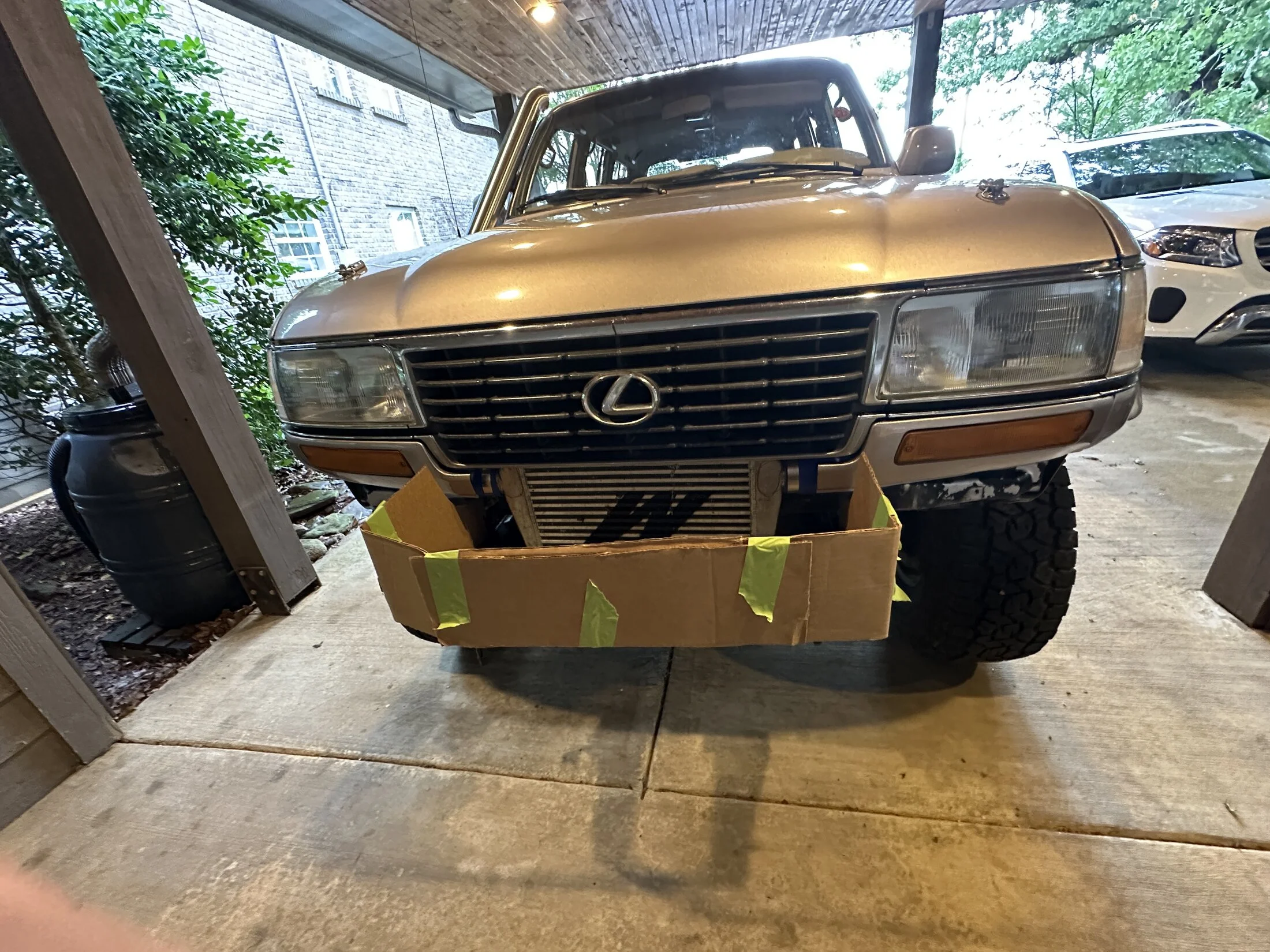

I’m mocking up my front bumper and winch (warn 8274) with cardboard. I’m looking for some advise on the mounting height. I personally like the top of the winch closer to the top of the grill for the sake of clearance and the aesthetics.
Is there any drawbacks to locating the winch mount higher up in front of the grill?
Any suggestions or feedback is much appreciated.
Photo #1 - Mounted high with grill.
Photo #2 - Mounted along top of frame rail.
Photo #3 - Mounted along the bottom of the frame rail.
I just built my bumper for the line to go through the bumper, but it’s an FJ 40, so I stuck with the classic look.

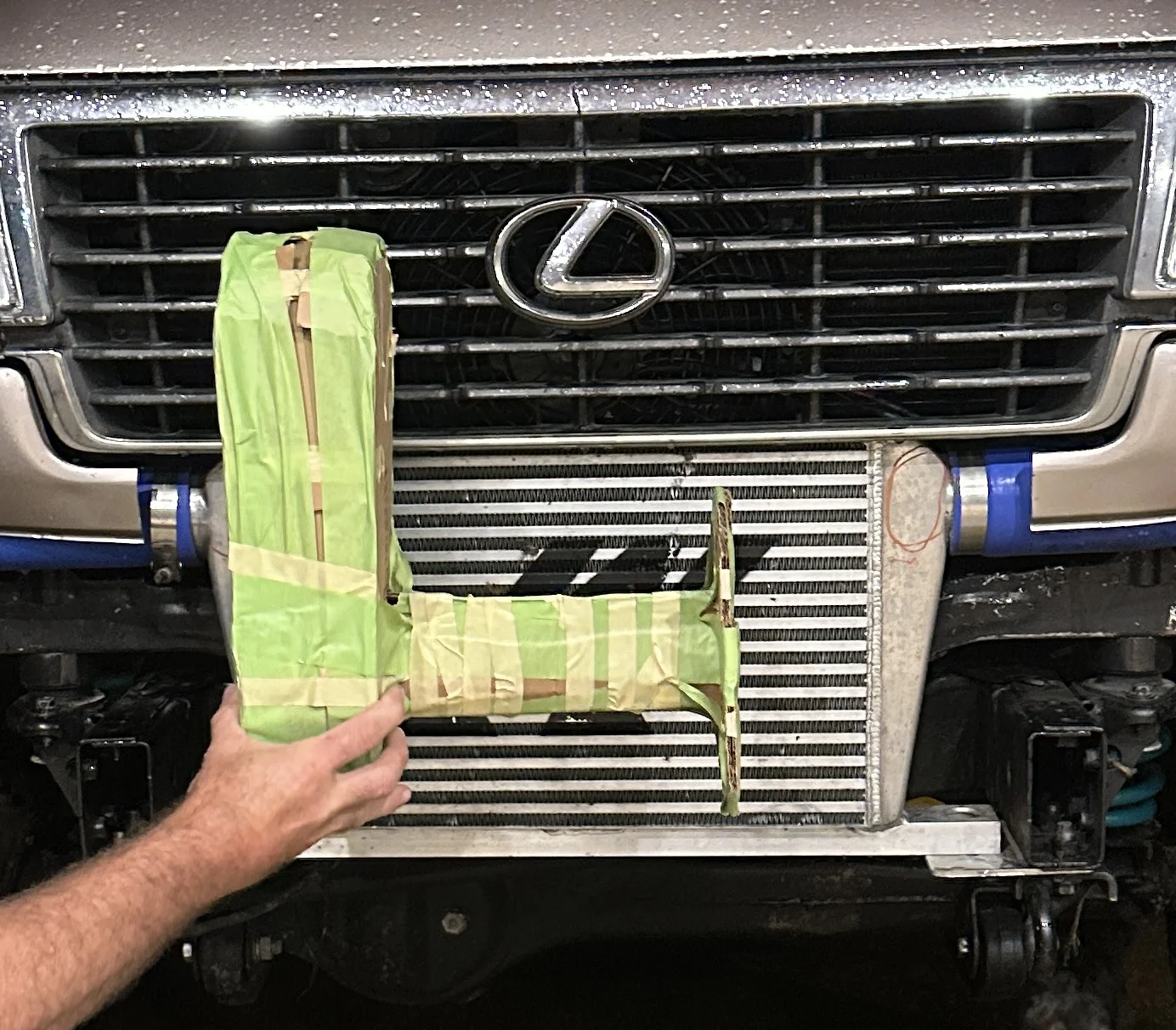

I would prioritize airflow through your intercooler in this case, but airflow through the radiator could be a concern mounting it up high too. Is there a fan on intercooler? Electric with a good shroud on the radiator?
Not sure clearance is really in the equation, the bumper will be there, and the intercooler is already there.
The 8274 is already very tall, I like the lower look, but you do you.
Thank you for your input. Right now, there is not a fan on the intercooler. On my radiator, I have the Dodge mechanical fan (no shroud). I plan to build a two piece aluminum shroud this summer. Right now, without the shroud, it still pulls a lot of air.
Forgive me for not digging back through the thread, but do you see EGT? Or even have a before intercooler/after comparison?
I would think highway might be fine, but crawling won’t yield much air through the IC.
But maybe with theee engines running the the way they do that won’t be an issue.
That is a nice size intercooler, mines pretty small but does have a fan, but is also inside the engine compartment.
I don’t have any before/after comparisons on the EGT. I installed the EGT gauge after the intercooler.
It’s my understanding that the 1st gen Cummins came without an intercooler and the intercooler becomes more important while towing. Since I’ve put the Dodge mechanical fan back on (without a shroud), my coolant temperature hasn’t gone above 140 degrees. I’m going to build a shroud and extend parts of it to my intercooler so the fan is pulling from it as well.
Your shroud idea sounds like a fantastic solution.
You are correct the first gens didn’t have intercoolers and they were amazing trucks. The ford 7.3 didn’t for long time, not sure if they even do yet…

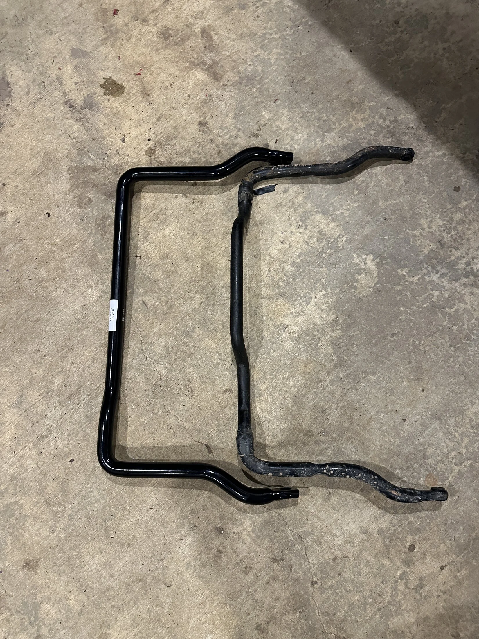

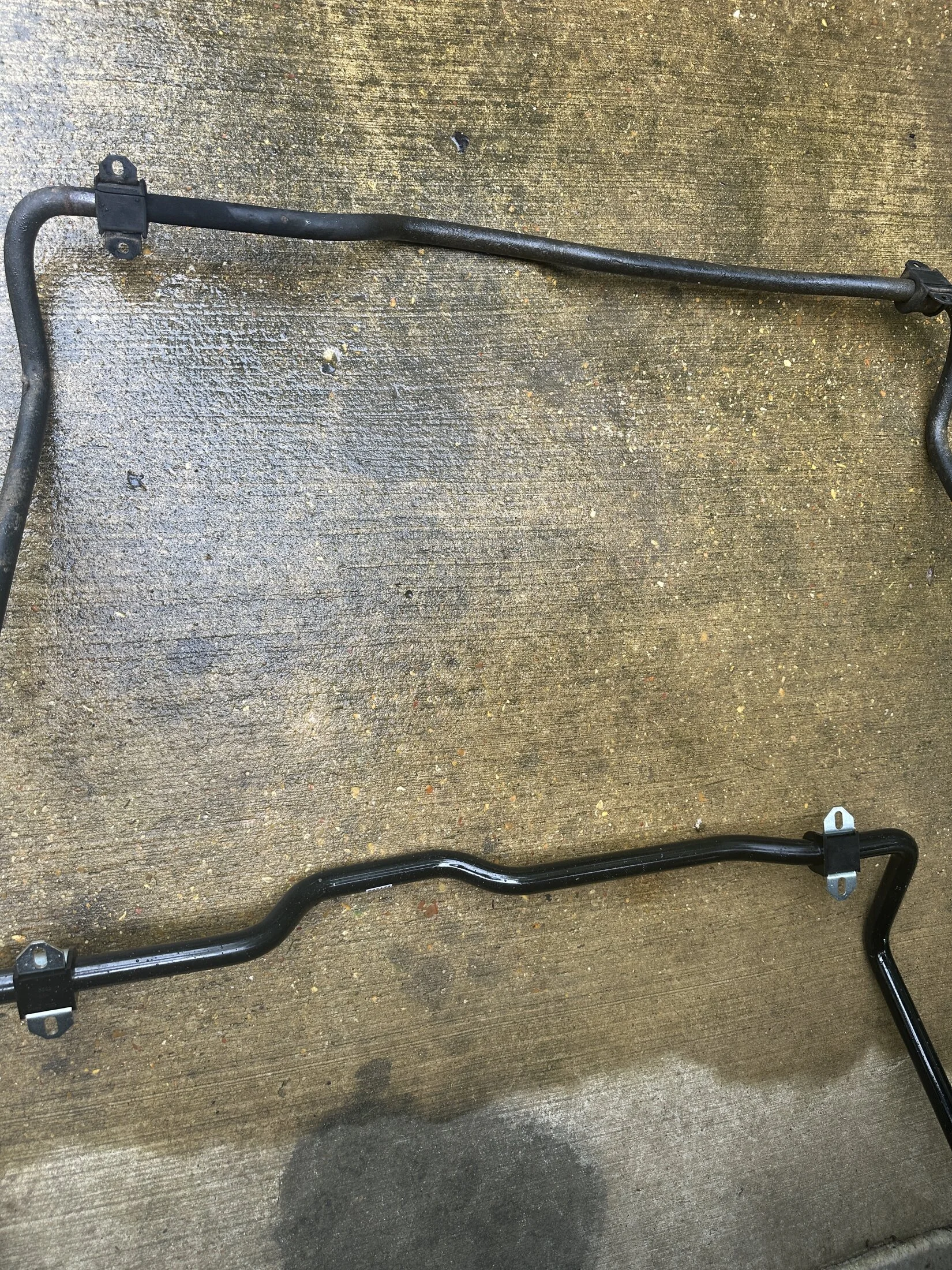

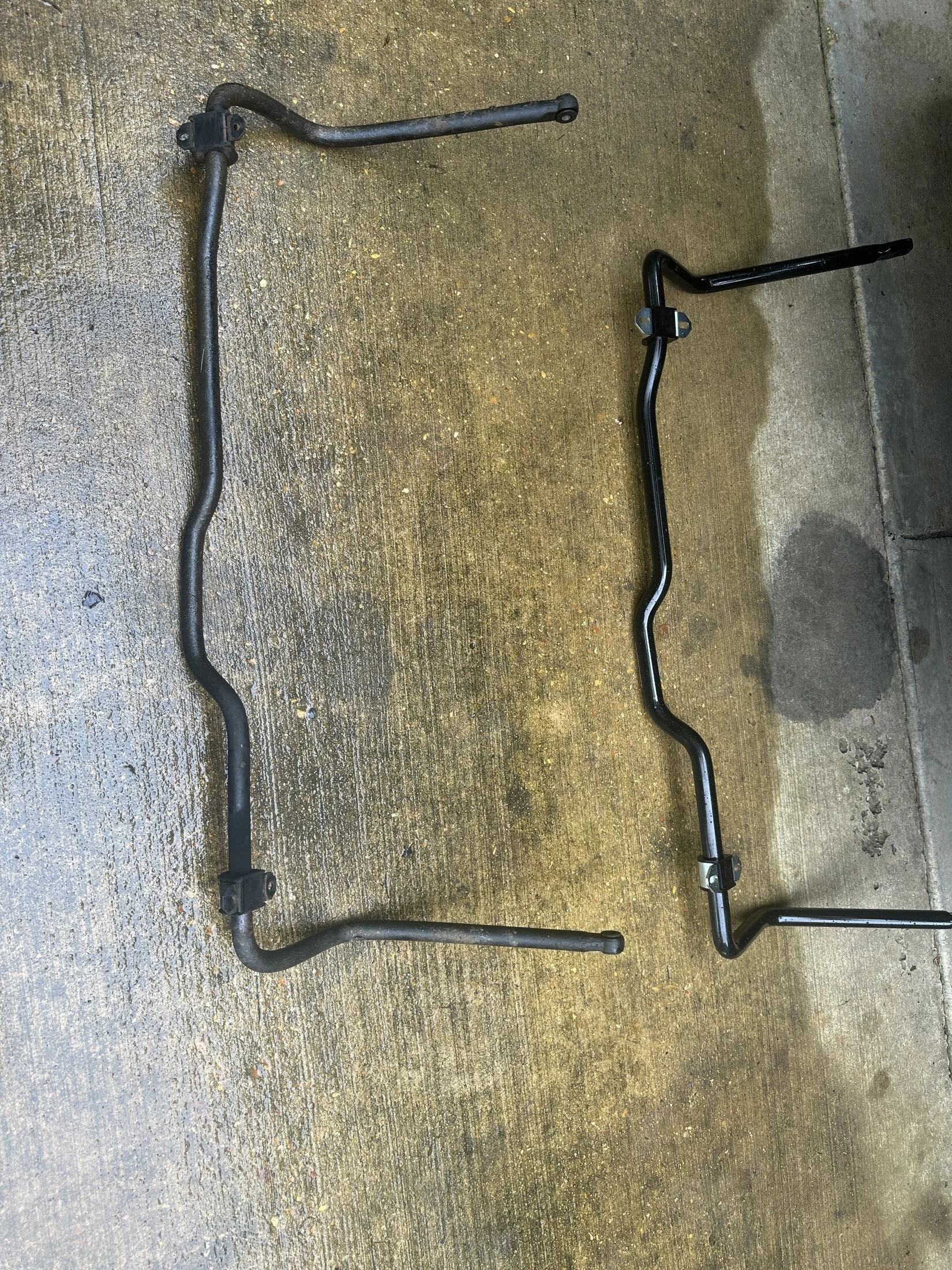

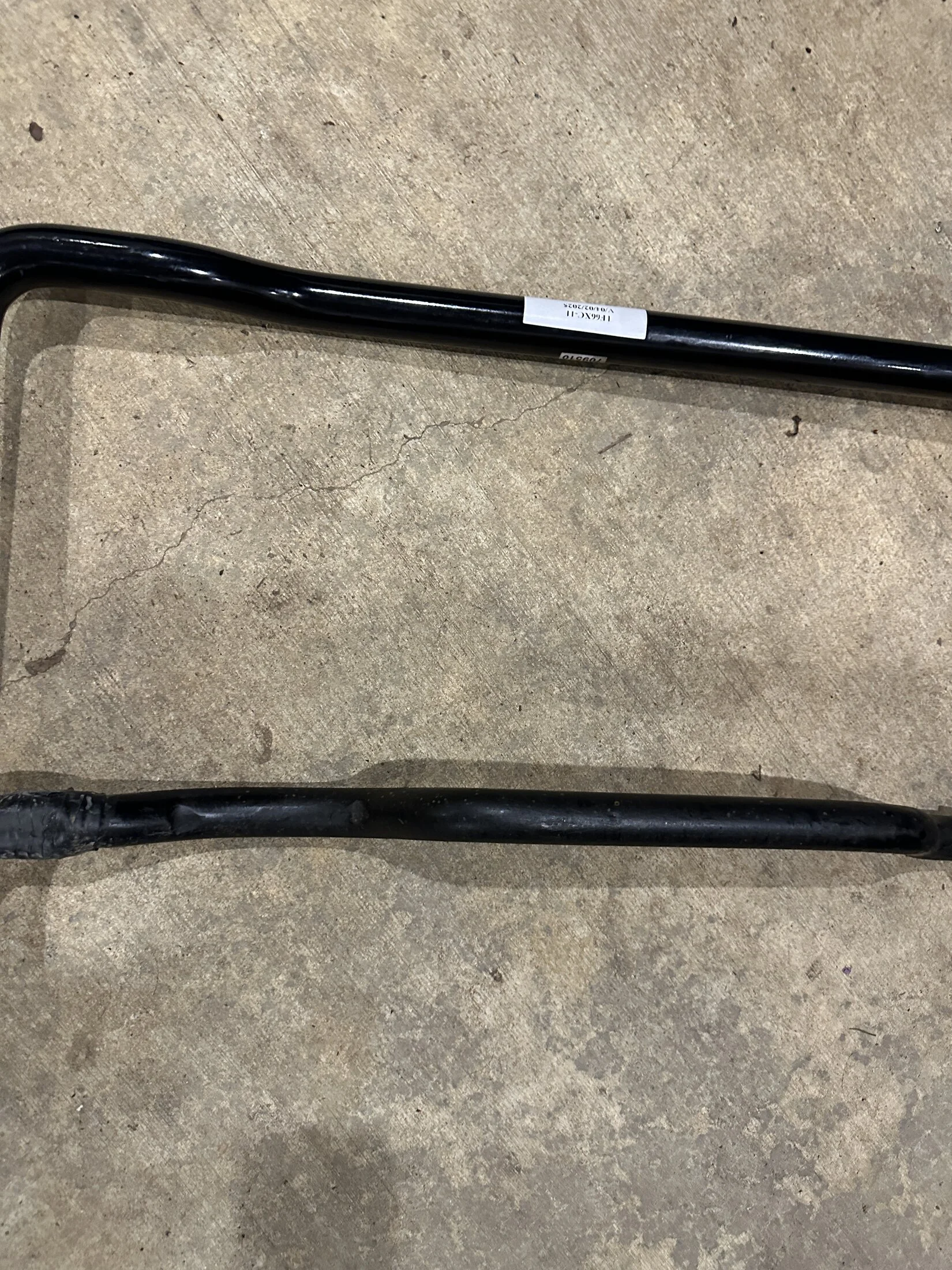

Since I've done my suspension work, I've had a lot of body roll while on the highway. Sometimes, it's been nerve racking. Today, I upgraded my rear sway bar to a heavy duty 30 mm Whiteline sway bar ($258 on summit racing). I just test drove it on the highway and there's night/day difference with the stability on the road. I'm now wondering if it would be worth upgrading the front sway bar as well.

I love mine, did you upgrade the brackets on the rear sway bar as well? Can't speak more highly of the Land Cruiser Phil brackets.
I have not upgraded my brackets. I used the ones that came with the sway bars. Thank you for the recommendation. I’ll check out Phil’s brackets.
