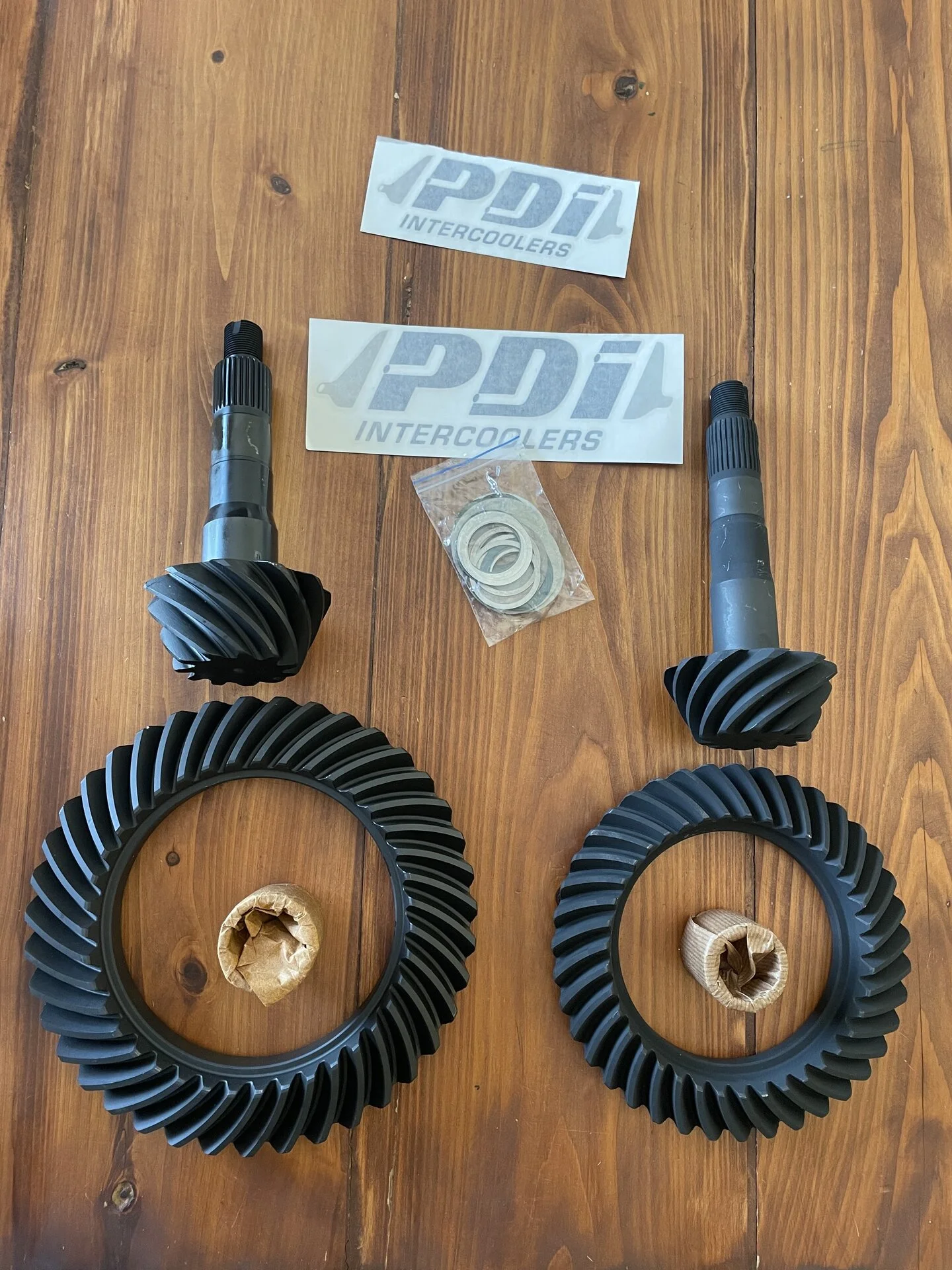

I’ve been running the cruiser around town and on the highway, testing it. My rpm’s have been too high for my comfort on the highway. At 65-70 mph, my rpm’s have been at 2200-2300 and that’s with stock 4.10’s, 10% overdrive sumo gear and 35” tires.

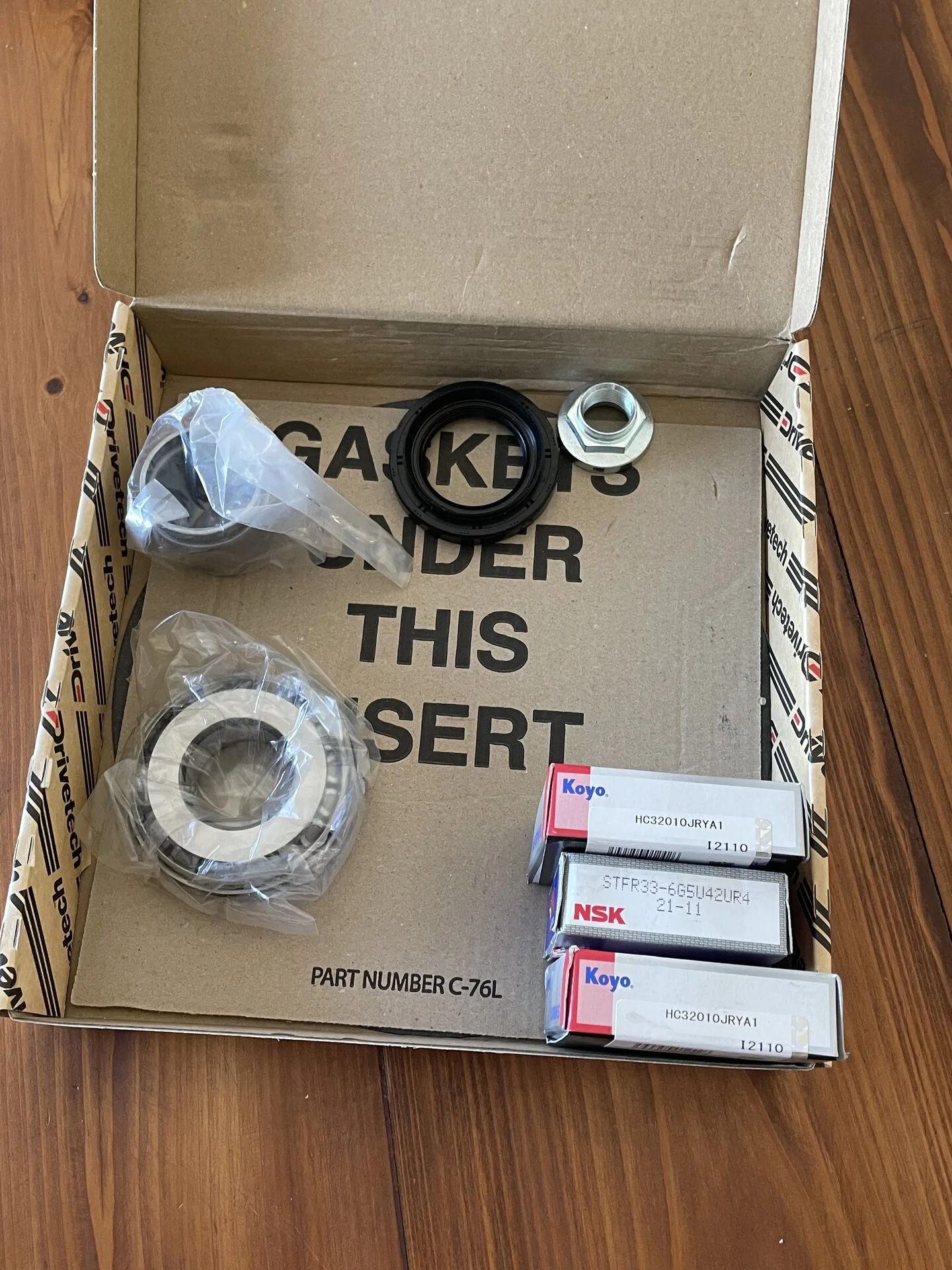

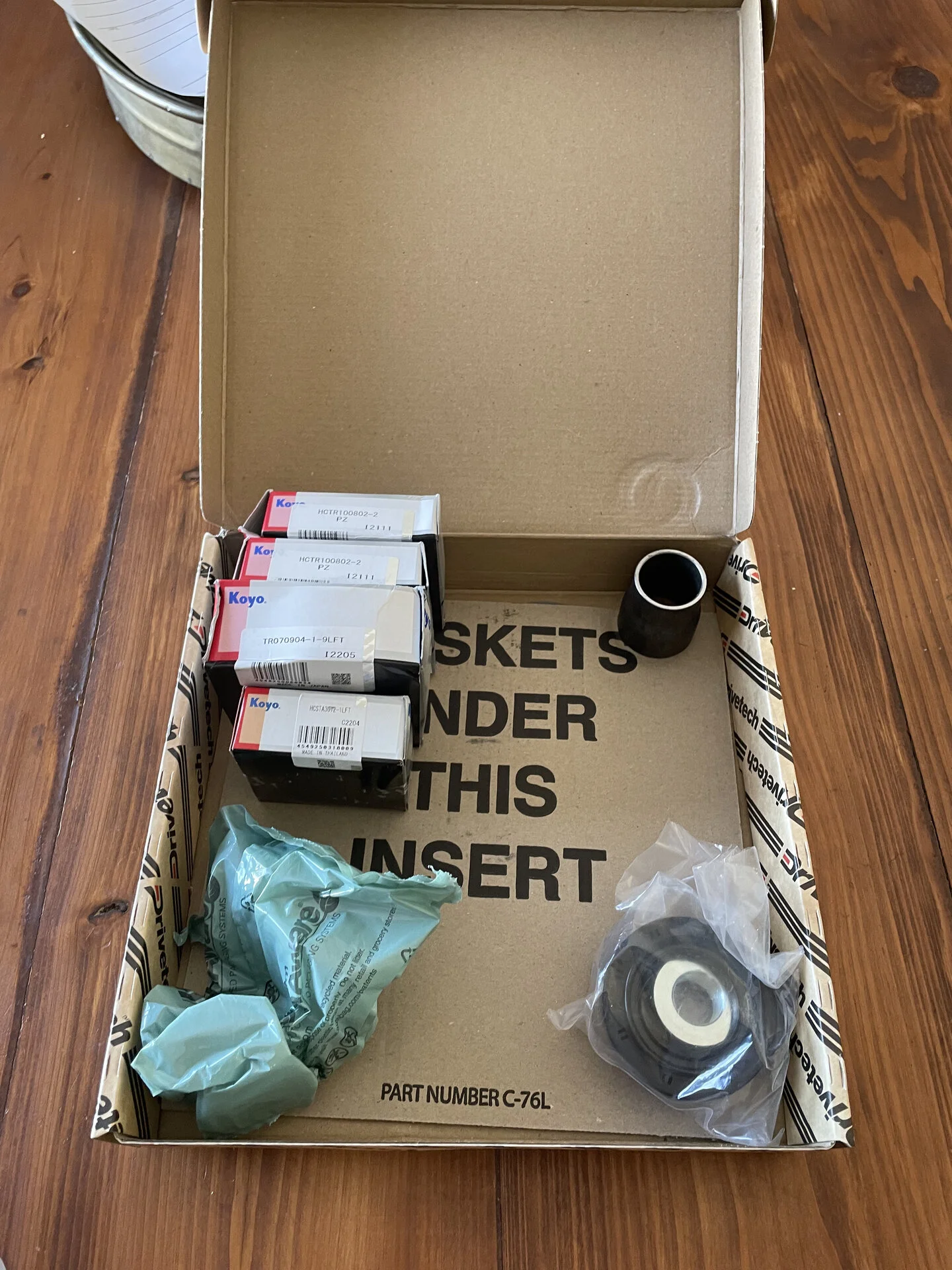

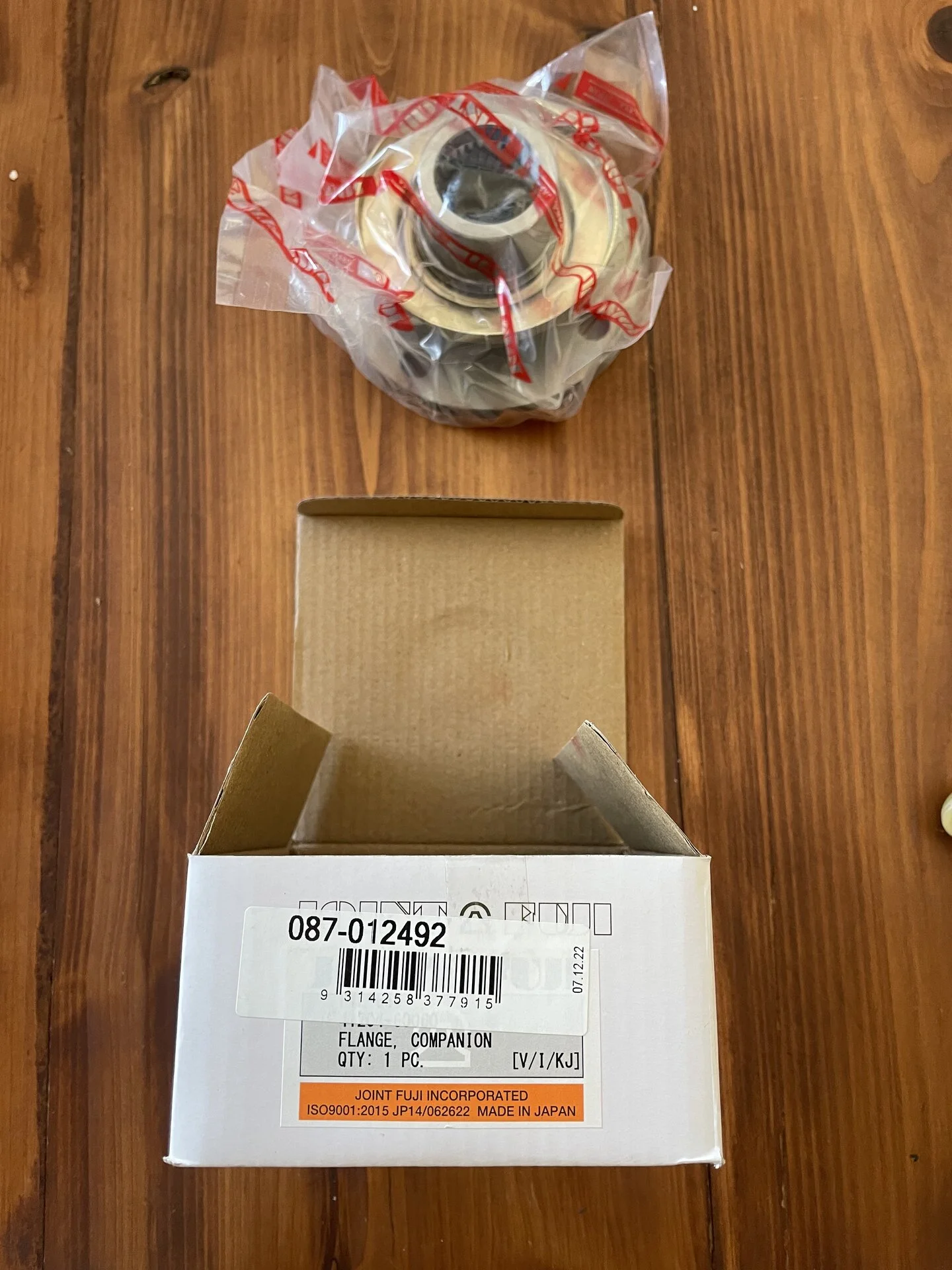

I started looking around for new diff gears and kept hitting roadblocks. A few people on the LandCruiser 6bt Cummins Facebook page told me that PDI in Australia sold them.
I found their page and ordered the set along with their front/rear bearing set.

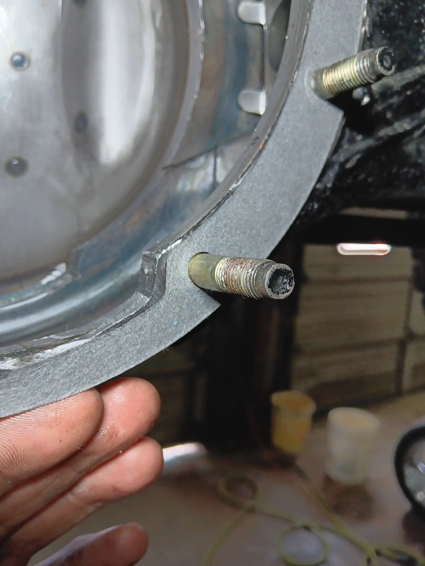

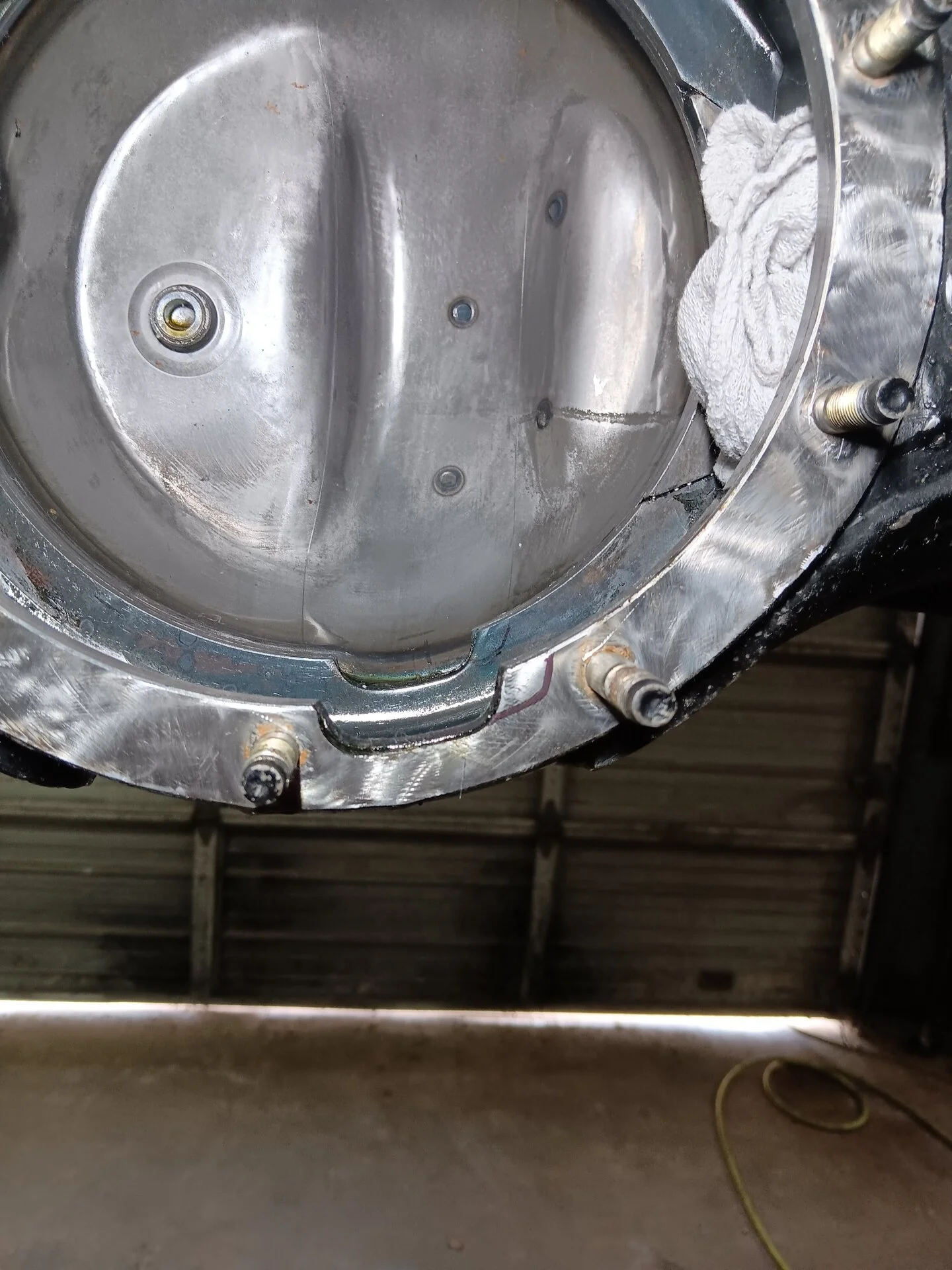

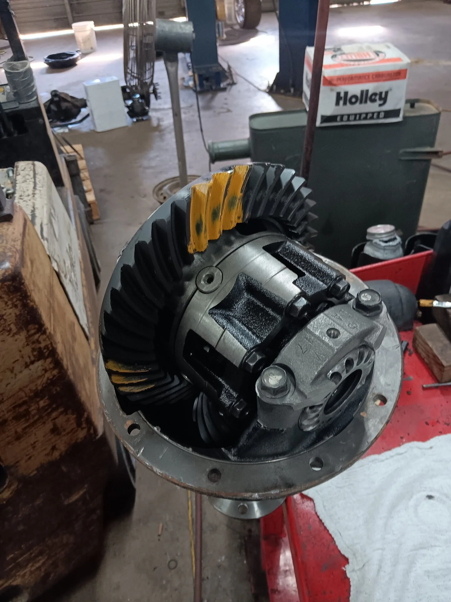

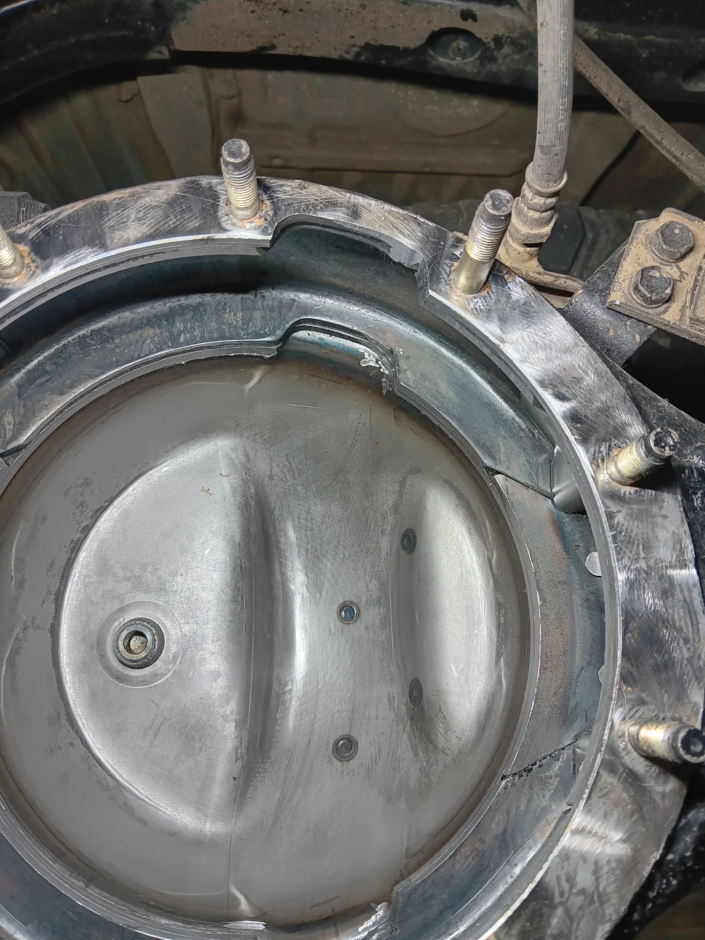

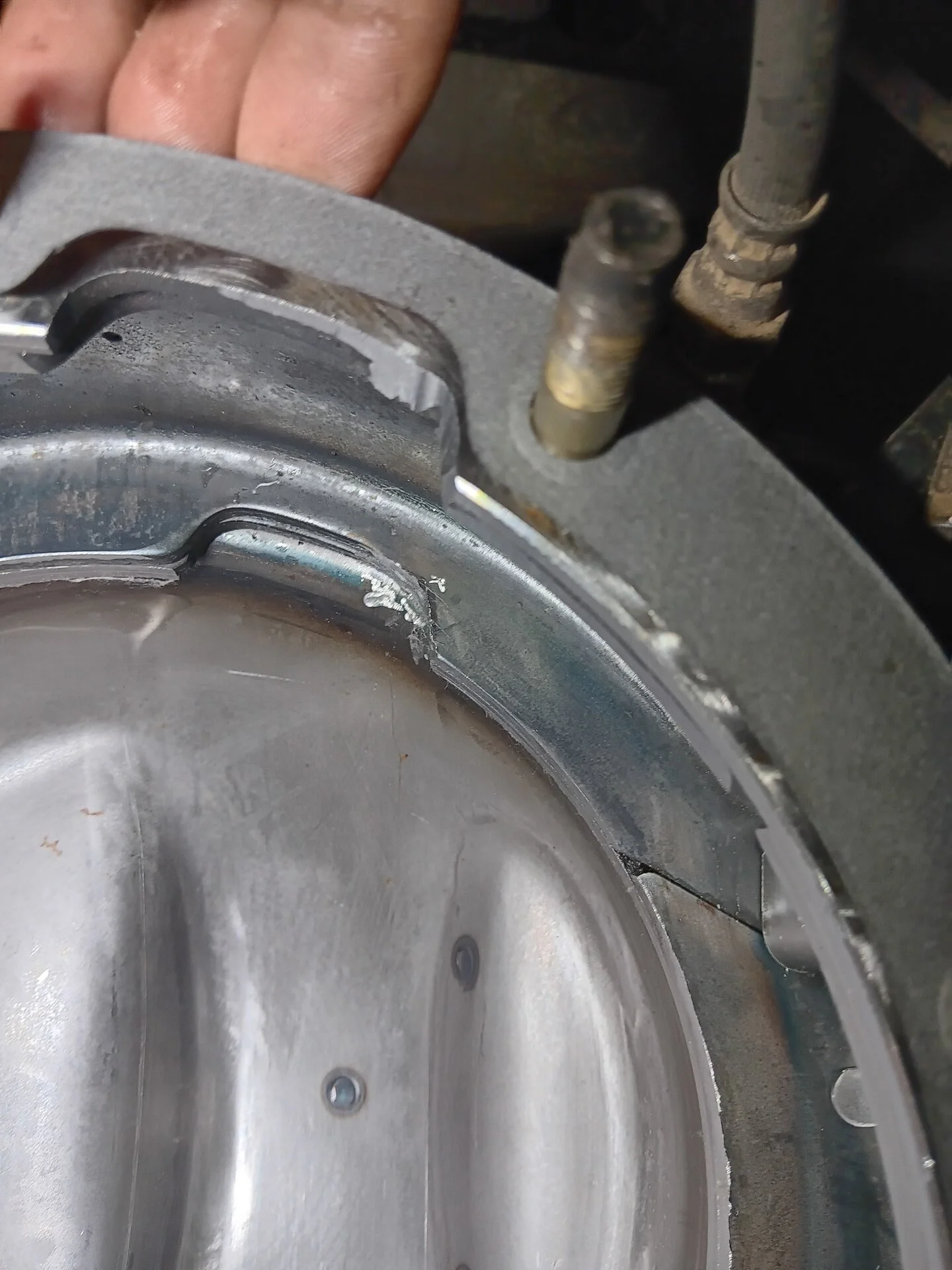

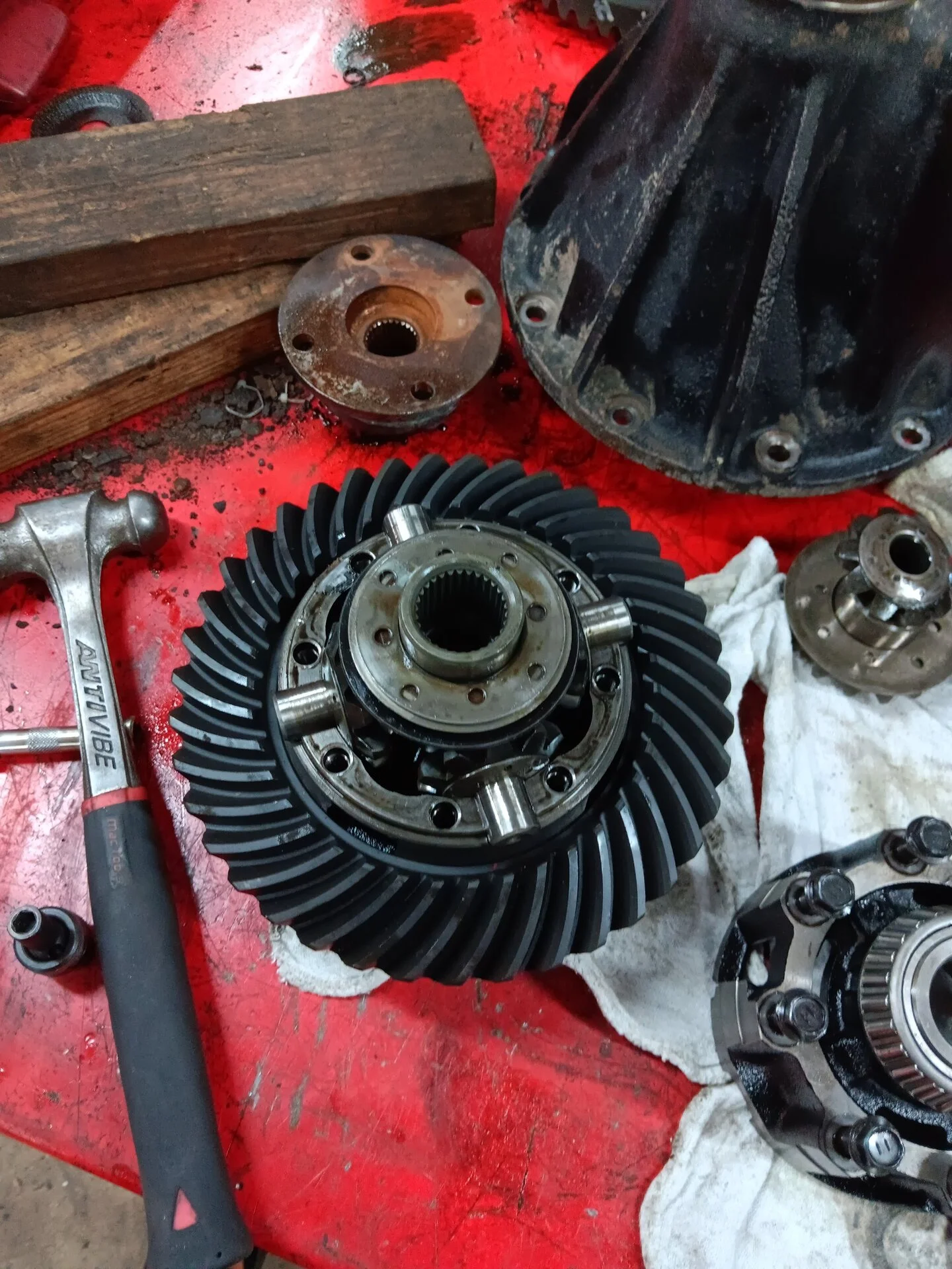

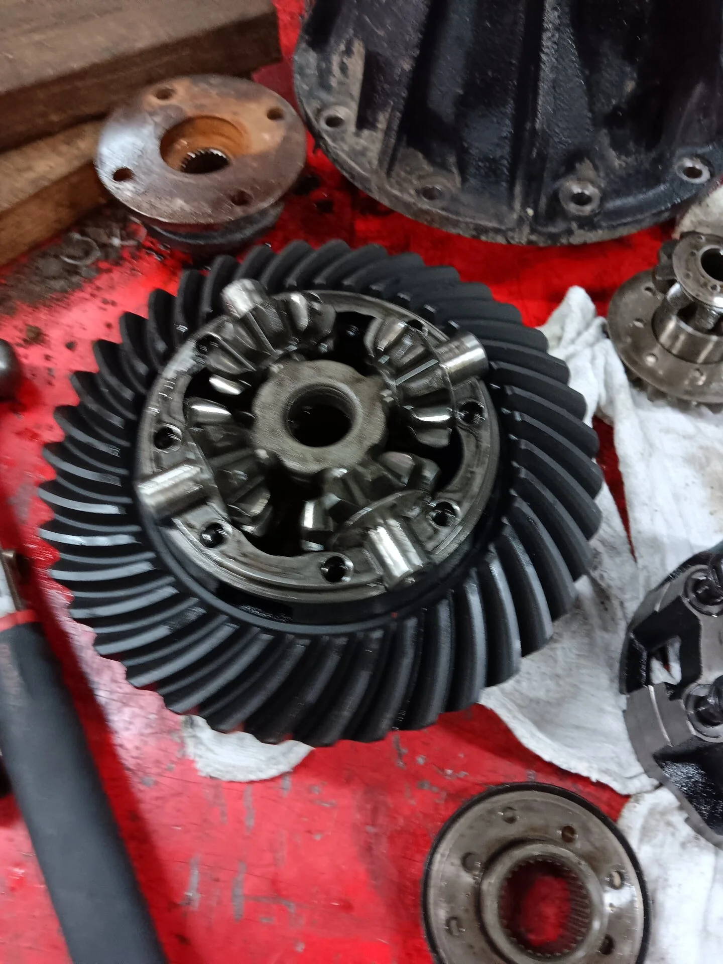

Tye McNatt (Business name - The Mechanic Shop) did the install. The front diff was a direct fit and straight forward. On the rear diff, Tye had a few adjustments to make. PDI recommended using a 100 series rear carrier assembly and swapping in the 80 series side gears as the spline count is different between the 80 and 100 series. In Australia, this is a direct fit, straight forward process as the Aussie trucks had limited slip diff as opposed to the USA open diff’s. We swapped in the whole carrier assembly and found some slack around the 80 side gears. Tye tested a few larger gear oilers he had laying around and determined that the GM 8.5 - 28 spline open side gear oilers fit perfectly.
Tye also had to clearance several areas on the axle housing for the new gear to fit.
I’ve been testing the truck now that the 3.55 swap is complete. I have more range in each gear and at 70 mph I’m running 1800-1900 rpms. The clutch also seems easier to operate as well.
Tye commented that he was impressed with the quality of the gears. All below photos taken by Tye…..

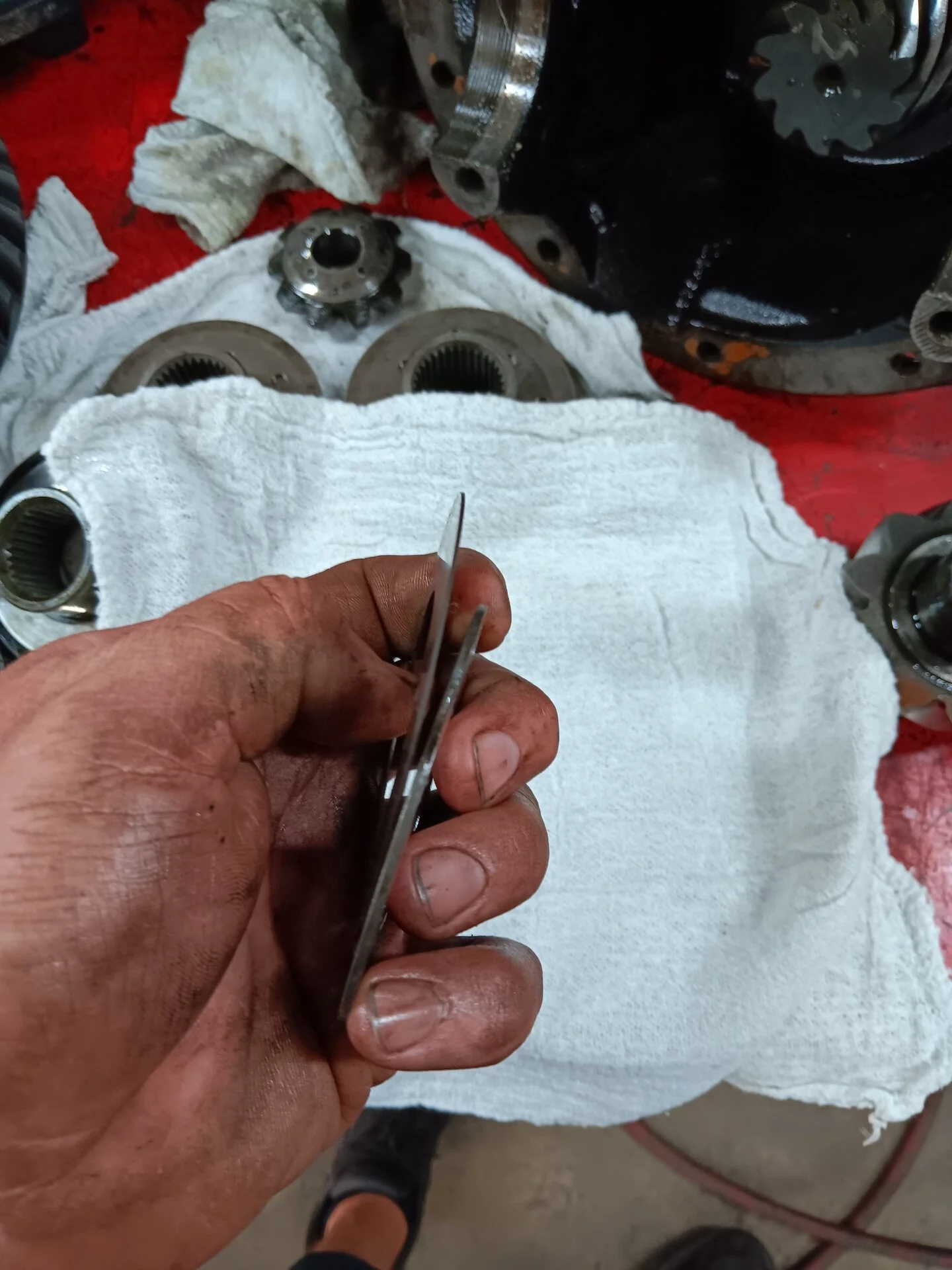

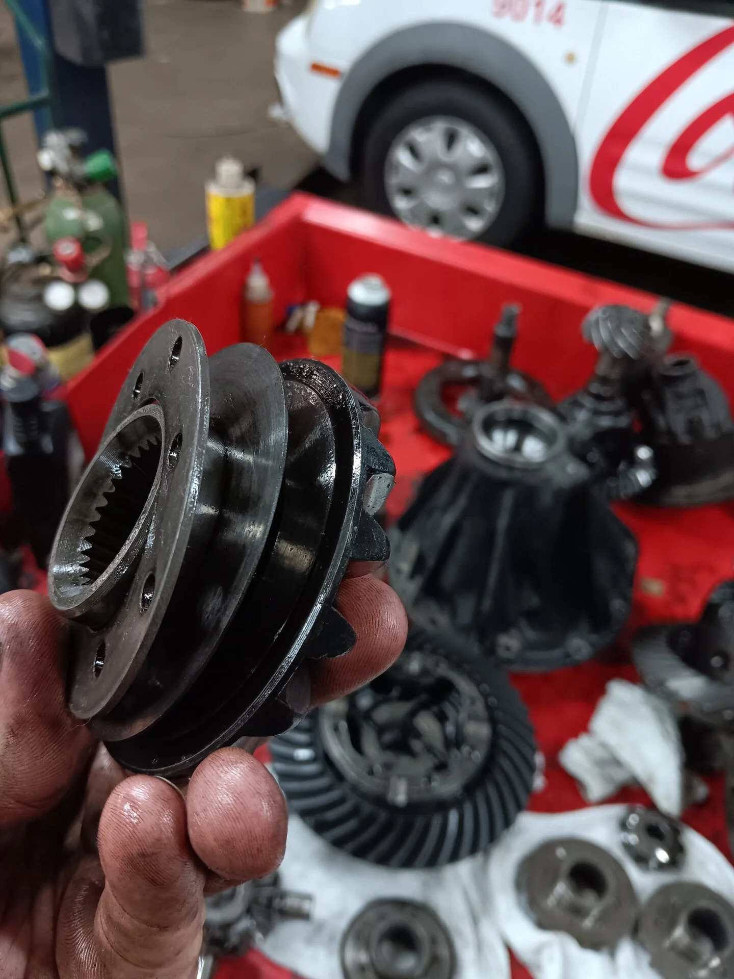

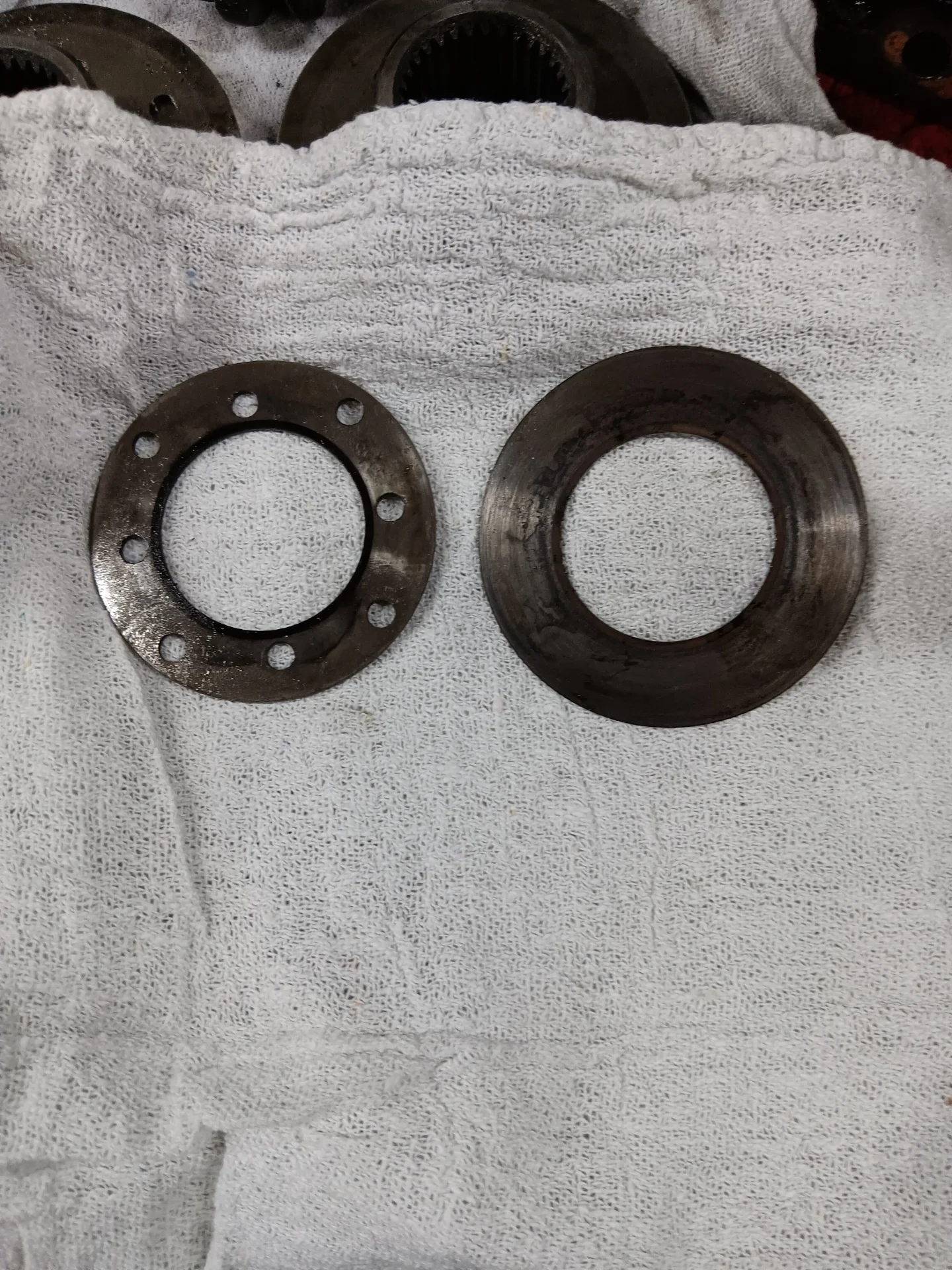

Comparison: 80 series side gear with the toyota and GM gear oilers.
Comparison: size difference between the GM and Toyota gear oilers.

It was done with some small pneumatic grinders.
Did you have to use the 100 series rear housing also or just the carrier. I'm assuming they go together. I'm already on the hunt for one.
