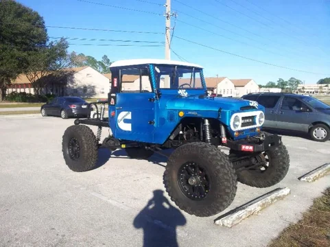

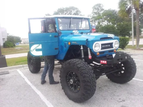

Test drove today. About 1 mile
She leans alotthink ineed sway bars. Also suspension adjustment. Brakes still aren't that great

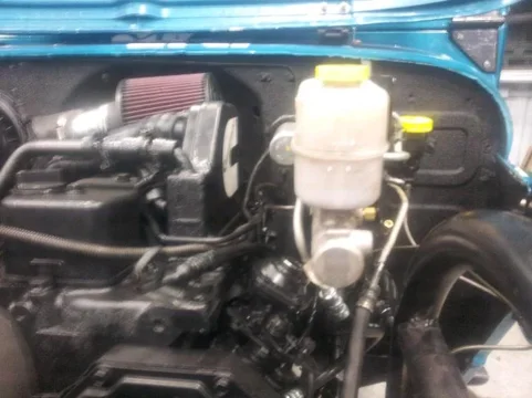

Hydroboost brakes are still on the way. The brakes now are scary but.they work. I have yet to design the rear.tube bed. It will be down the road once I work the quirks out. She will probably end up for sale for more finances for my next prodject. Once I'm done this is my 4th full built rig changing things up every time and once I'm done the usually always end up for sale so I can build my next one whatever my next one might be. Ooo and I'm getting a currie antirock sway bar for the rear so. My suspension moves better and my cab stays more centered since I'm a little nose heavy Thx to the cummins hehe
Depends. But probably 30k. You can't ever expect together what u have in them but it would be a start for my next prodject
This setup is off a 05. Dodge bore size just over 1 1/4. Tried locksmith up today and the rears locked and not front need proportioning valve adjustable. Willwood is on my list
I had a moment I'm never getting rid off this thing my buddy got hung up on a rock at one of our common wheeling spots not Only did I make it to him. And rescued him without a front driveshaft but I did it with. Ease. Felt like a Cadillac "vs "my old wheeling rig my leaf sprung on 40s v8 Jeep scrambler which had problems. Doing it in 4wheel
