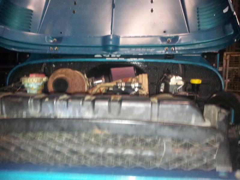

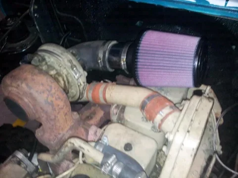

Got a airfilter and been working on the manual brakes

Looking at your pictures you probably have room for a hydroboost Booster. They are fairly small and compact you can grab them out of astro vans for $50 bucks out at pick and pulls.

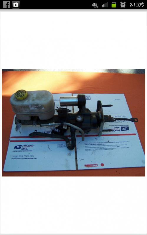

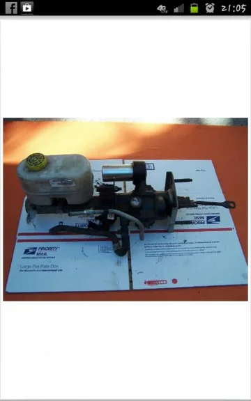

Which hydro boost should I get. One from. I have a cummins diesel. So should a get a booster from a Dodge diesel
Pretty much all of the hydroboost units are the same. I have a 6BT in my FJ60 and a hydroboost from an astro van bolts up with an adapter made from a toyota booster.
All you need to do is have high pressure lines made up to connect it to the power steering system.
All the info you need is in my build the bottom link in my sig. Starting around post #200.
Bought a hydroboost of a 05 Dodge 3500 off ebay. Its on its way it has just over a 1 1/4 bore size on the master. Should be plenty for my 1 ton axle set
