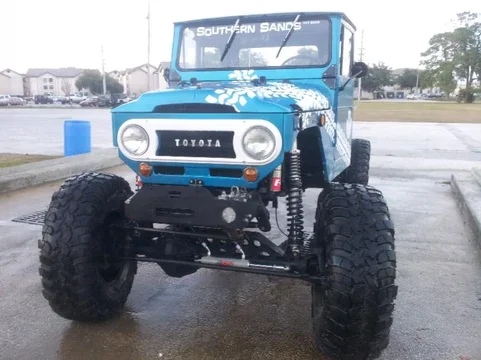

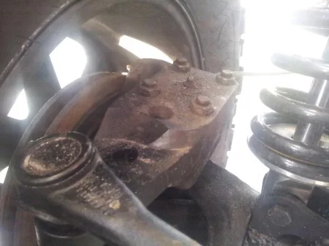

So this arm isn't spring less currently on the toyota and please exposing to me how this helps death wobble
Are you planning on wrapping that big U-bend exhaust under the hood? That will be a lot of area to radiate heat so I hope you're planning to wrap it.
Still got death wobble after ram install not as bad but the wheel wobbles I thing its the bearings
What are caster and toe set to?
Toe is zeroed out no in or out caster is fine. I pushed and pulled on the tire and watched in the inside my rotor disc moving slightly

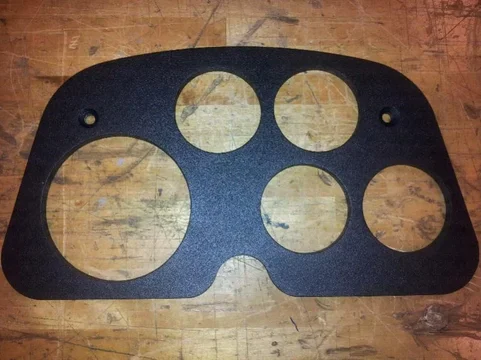

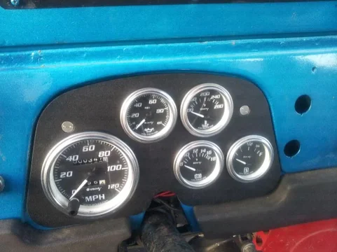

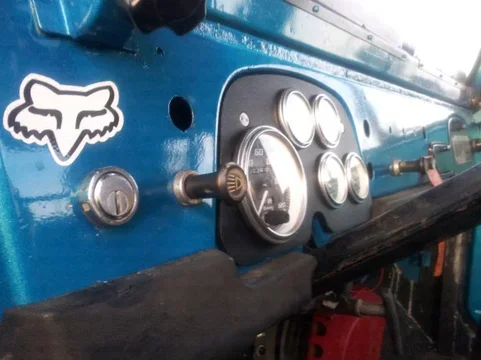

More than likely do u know what the preload pressure is supposed to be. On a side note got my dash cluster panel from trailcandy.com took a while to ship beacause of holidays but its finnaly here
I tried the washer trickput 1/4 of washers on top of my springs on my kingpins and it didn't seem to do any thing I'm not getting death wobble since I put my ram on last weekend but its just making the problem I look out the window and can see my tire wobble and it gets worse with speed I can't quite afford. The springless arms. Right now. But even still I'm starting to think its my wheelbearings loose
