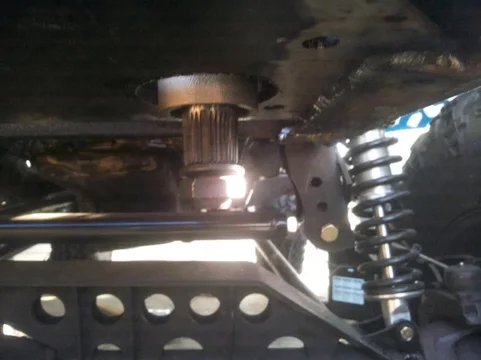

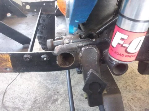

The angle of the shocks. Is not the traditional I was trying to line them up more with the flow of suspension travel side to side never done it that way before just wanted to see if it acted any different I've been told it keeps the rear more steady seeming how as my rig is nose heavy
My wheel base is 120 inches a little long. But if it gives me to much trouble it will be a perfect excuse for rear steer

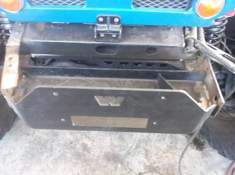

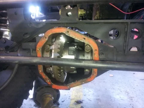

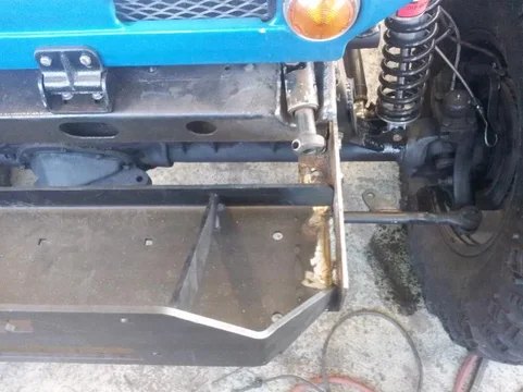

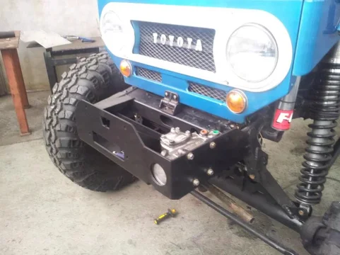

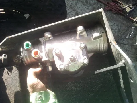

Finished the steering setup. And put some diff fluid. In the front and rear ends while staring and my Detroit lockers my friends been working on my wiring in exchange for beer. She now start drives and even has turn signals and lights but no brakes that's the next prodject
