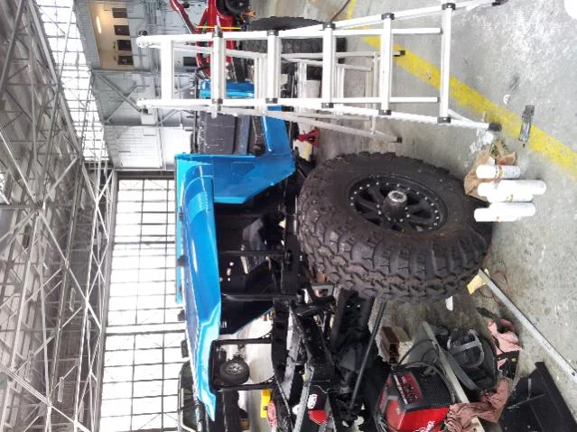

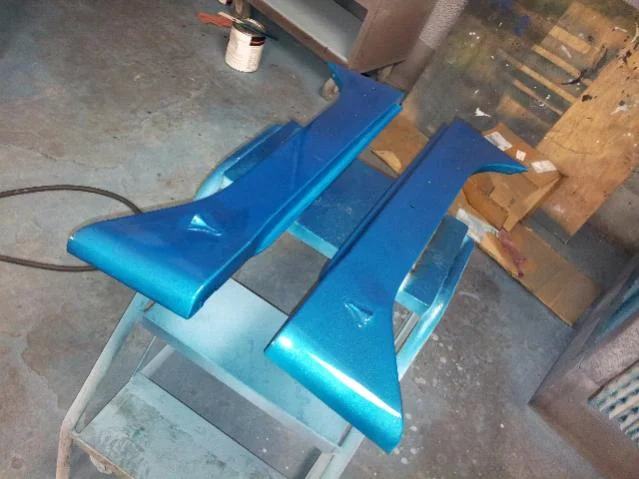

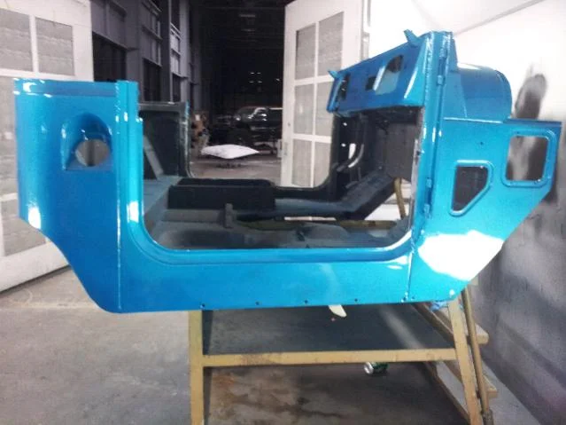

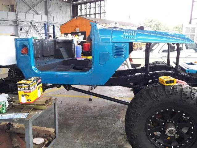

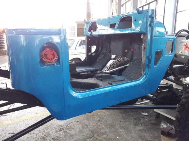

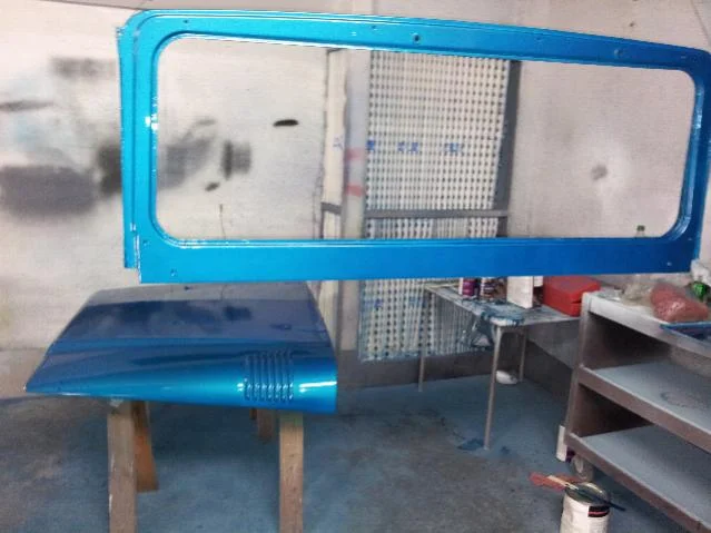

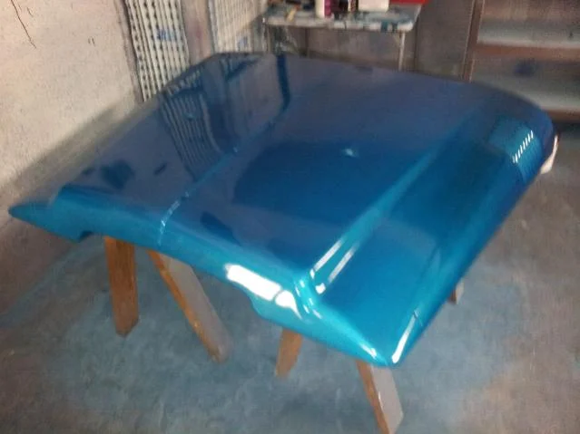

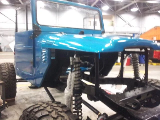

Painted her the teal green metallic. Its more green then it is in the pics but it stand out in the sun

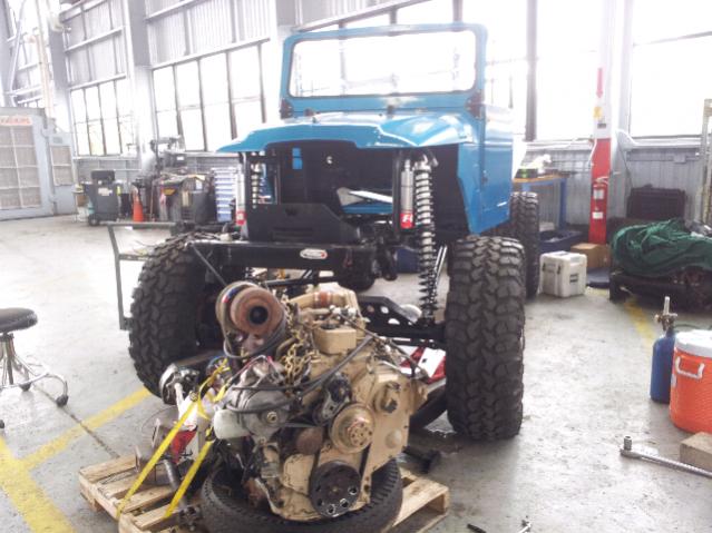

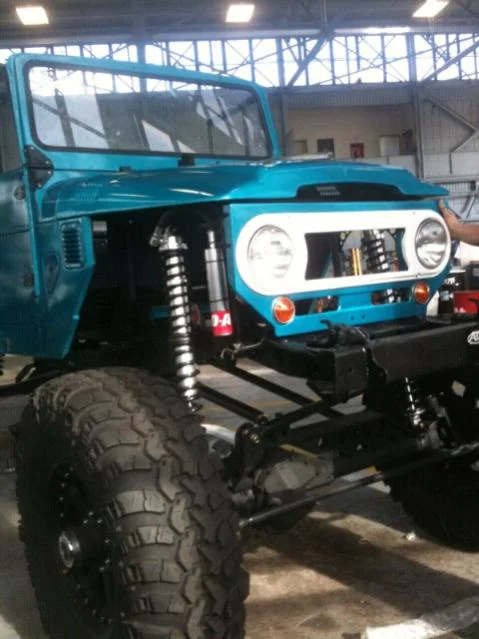

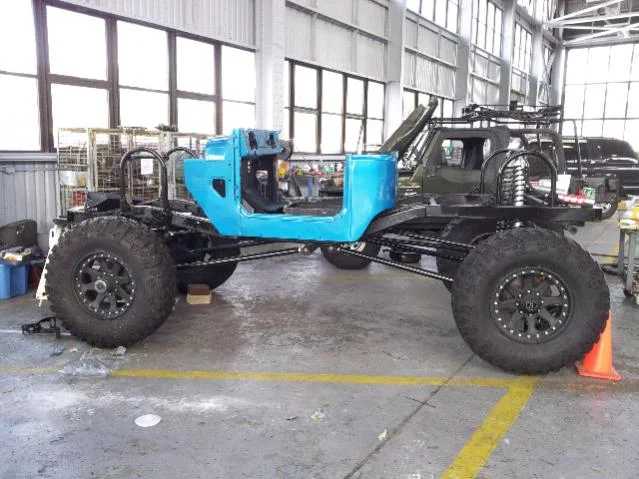

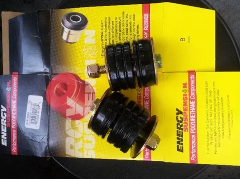

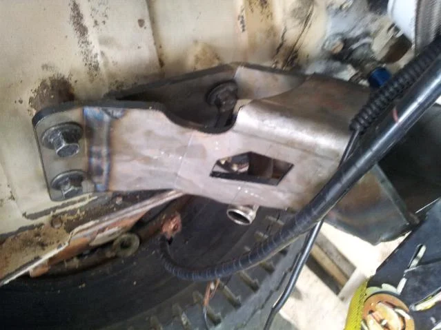

Started assembly. With fresh paint. I only have 6 body mounts but I can't find anyone who sells them individually

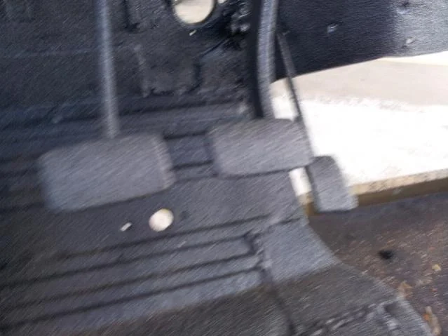

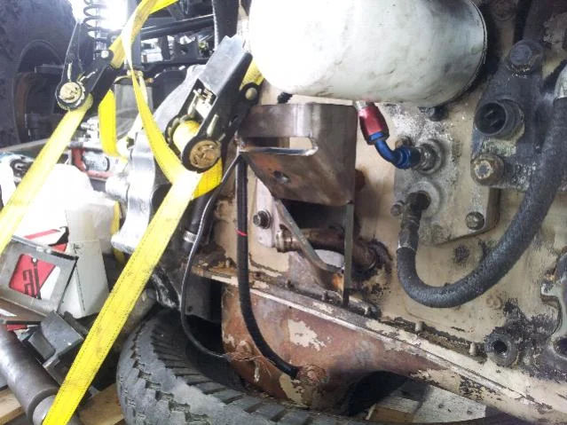

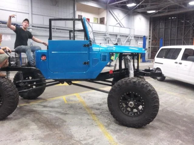

I just thought it would be cool to have my pedals in line x. No other reason other than that really. Funny u mentioned everyone that comes by to look at her asks that question

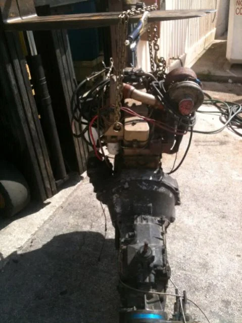

You forgot to tell them about pulling the motor from the J%^ and cleaning it up.
I'd show them myself, but I have an IPhone and can't post photographical evidence.

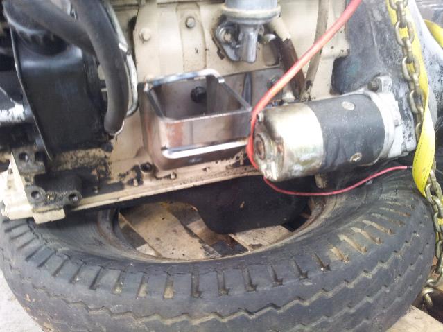

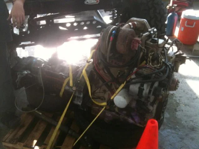

Yea its the 4bt/nv4500hd and Dana 300 pulled out of my previous wheeling rig a cj-8.jeep Soon to be owned by the head lady of southern sands Jeep club great combo for the Toyota I think.
