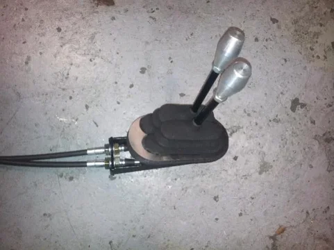

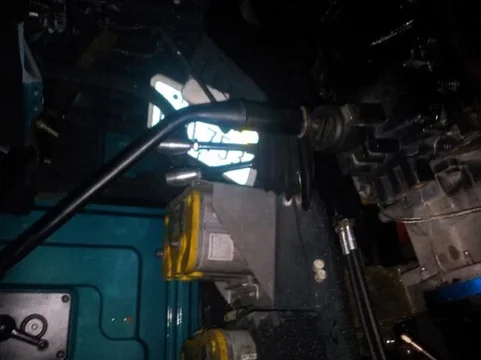

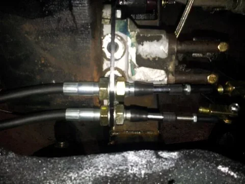

The cable shift setup from NWF for the D300 is pretty sweet. Spendy, but sweet.
Thx I purchased it beacause I broke the original manual one one day I still to this day don't completely. Understand how. All I know is I was wheeling and was going between hi and low range then all off a sudden after coming out of a climb I went to put her in high range and my lever was real loose and she wouldnyt change gear but sure enthusiasm broke the aluminum. Housing for the shifter

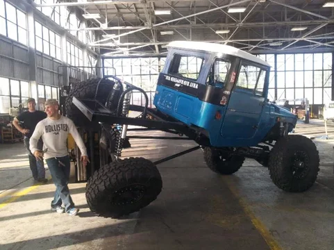

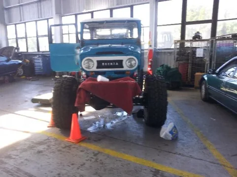

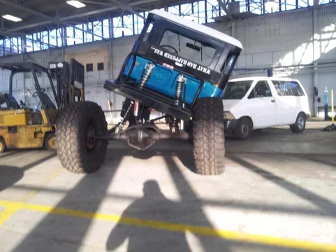

Thx I forklift flexed her for the first time for the hell of ii wouldof went further but the tires are hitting the frame
Dude...the flex on that thing is oh so dirty!!!
Gonna take some serious courage to drive it to its full capability - can wait to see it in its natural environment-parked on top of a Mercedes who double parked at The Landing! Damn that's sick!!
