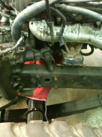

So I bolted the 2u to the 80 series trans and t-case on Monday and began the first install of the drivetrain. All in all it fits pretty well.
It looks like i will have to tub the tunnel a bit to get the back of the drivetrain up a some, but there are no major interference issues with the PS box or booster master assy. I also have yet to build motor mounts so it is just sitting on the frame rails. The engine will come up a few inches from where it is and go back some as well.
It is just sitting on the frame rails now. It will have to move back 4 or more inches from where it is. The PS box interferes with the shock mount (which has been removed) but the fender should be no problem.
