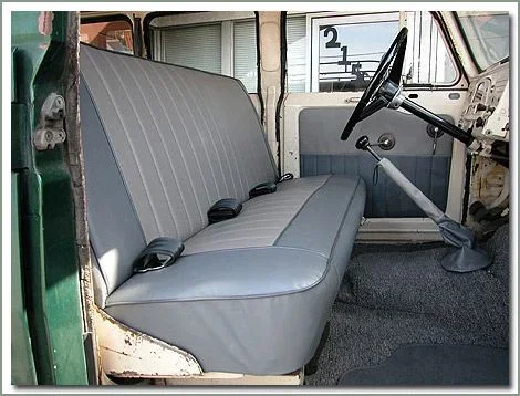

Michael, is the interior of your LV original? I have seen pics of some red interiors and would like to see one live as I have been thinking about going with it for my LV. Thx
Mark,
The only color interior offered in the US was the 2 tone gray like spector sells here....
Also if there was a different color sold in the world it would likely have been the Coral color Shane is repo.ing for the early 40's, that said if you dig the red go for it!!
HTH and great progress Michael:beer:
