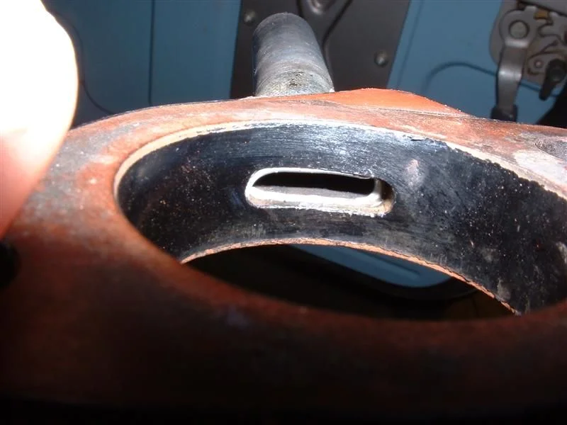

I removed it from the truck, the insulator is not cracked, so I think I will be alright with some JB Weld or epoxy to hold the tube in place. I will have 2 days to mess with it, as I am at work for the next 48 hrs.
I got the tube pulled from the insulator, cleaned out all the oil, silicone and dirt from both pieces, mixed up some JB Weld and re-inserted the tube. Now the wait until it fully cures and I can run the motor and adjust the timing and carb.

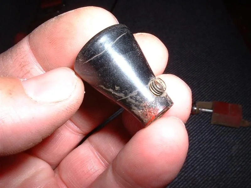

I followed the "How-to" by Dom, and polished/painted the dash knobs. The "Vent" knob and control cable have been cleaned, polished and painted, I still have to finish sanding and paint the small panel for the "vent, heater" controls. The "Heater" control knob is cracked all the way around, I am hoping the "heater" knob on the LV I picked up a few weeks ago (Thanks Whitey!) is in good usable condition.
