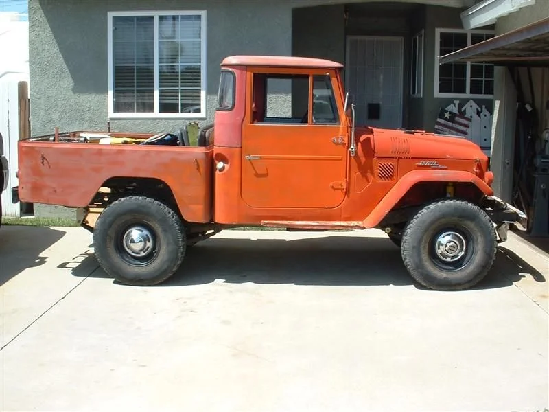

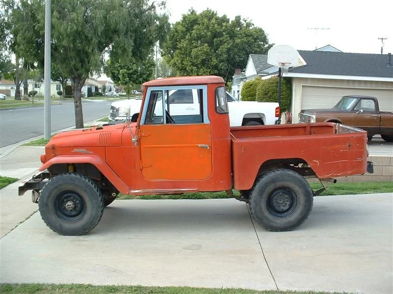

After reading Dom's thread......again, I decided to re-drill the spring pads and plates to move the rear axle farther back. It doesn't look like much in the pics, but it did make a big difference.
Can you point me to where Dom suggested the drilling? I thought that my axel needed the same thing when I did the install on my LV, but others seemed to think it would move back once the full weight was back on the frame?
Do you have a before pic from the side?
Dom has a thread about installing his OME lift. He discusses it in there, sorry for the confusion.
I will look for another pic from the side.

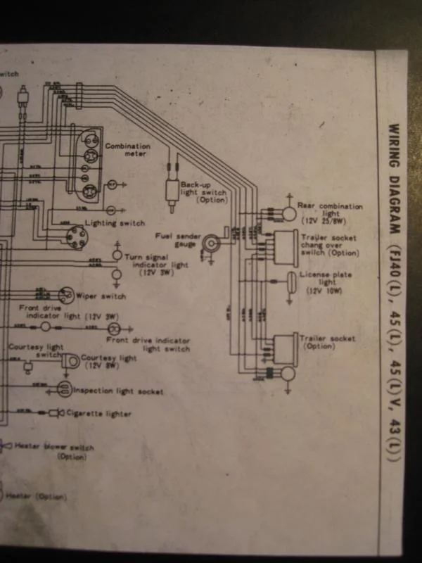

Rear wiring.
Where did you get this from? I can not read the color codes of the wires, I see the license plate light (I figured 1 of the wires is for that) but could not figure out the dual connector. Thanks for the pic.
I remember hearing there was wiring for a backup light. This is supported by the wiring diagram posted. I suppose there would have to be some wires at the column shifter near the firewall in the engine compartment too?
Tony I have a few early wiring diagrams you can copy.
I got it from the, Toyota Land Cruiser Repair Manual Chassis & Body manual from Spector.Its a great source of info for pre 70 Cruisers.I made a Photo quality copy of the wiring diagram,the blew it up.It covers FJ40,45L,45LV,45LWB.It helps out alot.
