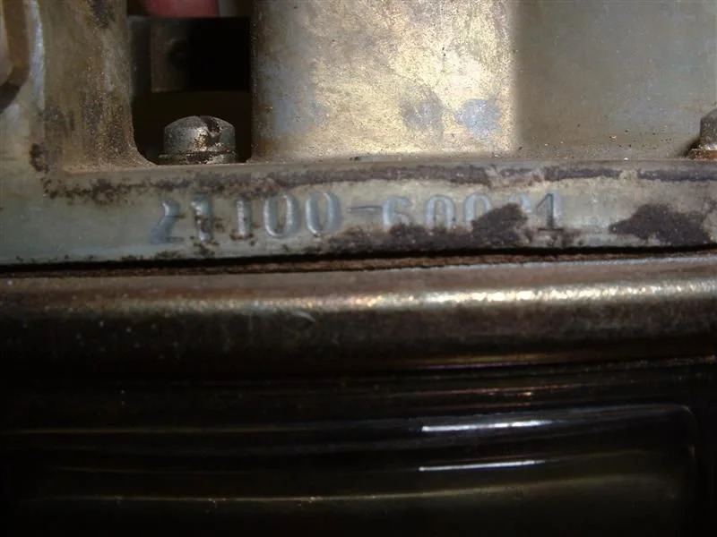

I got another "present" in the mail today, where do you guys get rebuild kits for these? What are the numbers on the last photo, are they a part number????

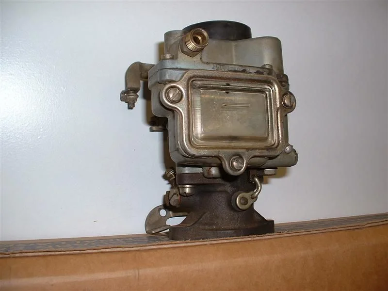

I am going to be rebuilding the carburetor and in doing a search for a part number, it would appear I am supposed to have a large window carb???? Am I reading the date correctly 1 G 15 (1971, July, 15th?)
Not sure what date the change over was from the large window carb. I thought 65 had the smaller window. Did your small window had th kick solenoid? I've got a few carbs and I know there are two sizes of small widow carb. The one barrel ended I believe in 3/69. Then the rest of 69 model year had a two barrel. No real reason I asked just curious what the date for the carb window change was.
Nice looking truck. Not to often you find them this original after this long.
Now I am really confused. I am waiting on the rebuild kit I had ordered, they told me it was for a large window carb from early to 68 model.
I know that the small window came in the later years of the one barrel carbs. The large window didn't last until 3/69 when the two barrel started. Did your small window have a wire on the back for the idle kick solenoid? I've got a few small window one barrel carbs and all of them had the solenoid. I don't remember if any of them came on either of the 65 FJ45s I have over the years but I don't think so. I think both had after market carbs. My 68 had a carter I remember and that was back in 74 when I bought it. That one now has trhe correct small window carb and runs great Funny how I remember the vehicle I bought 35 years ago but don't remember the ones I got in the nneties:rolleyes:
:cheers: John
That makes me think even more that the small window was original. One of the small window carbs I bought from a junk yard's back room. All the carbs had a model and year on a attached tag. It was marked 66 and had the solenoid. So a small window without the solenoid would have been earlier:hhmm:
