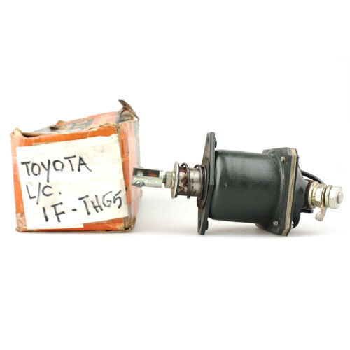

If I can get my hands on a solenoid I think I can make this one work.
If anyone has that older solenoid. Feel free to send me a message!!!
I have see a few on eBay. Not sure if this one is correct.
Thanks for sending that!!
It does look to be the correct one. I have been looking at that and think I will try that route.
Thanks again!!
Everything seems to be coming together!!
