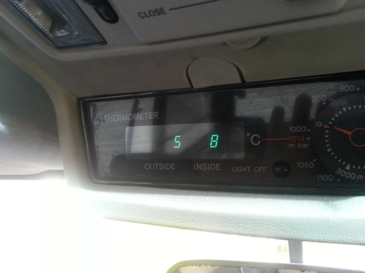

Actually got this gauge to work with a bit of soldering on the back of the board.
Now to find a temp probe for the outside, ( it's missing, it's not quite that cold out..:lol:) apparently a 1k ohm ntc thermistor.
I've found them online, but I object to $10 shipping on a $1 part on general principles.

The outside temp probe wire should be in one of the frame rails at the front of your cruiser. Thats where it was in mine anyhow.
Regarding the thermistor, think this one would work? NTCLE100E3102HB0 Vishay BC Components | Sensors, Transducers | DigiKey I could bring it in on our next order. We order stuff regularly from those guys. If you don't like that one, just find another that you like on that website and let me know. I could pass it to you via mudship or next time I'm up there.

Yeah the wires are there, kinda dangling..haha.
that does look right, i had a go at ordering myself last night but I kept getting blocked before the shipping link on digikey...so yeah if you could ad that to an order that'd be awesome!

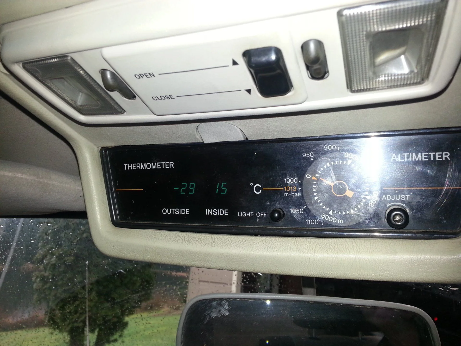

seems to work...I calibrated it by wetfingering the sky, and then stuffed the probe into the frame rail.

this is the thread where I found the info on probe and soldering issues, but I'm sure it's all pretty basic for you... HJ61 in/out temperature gauge repair
