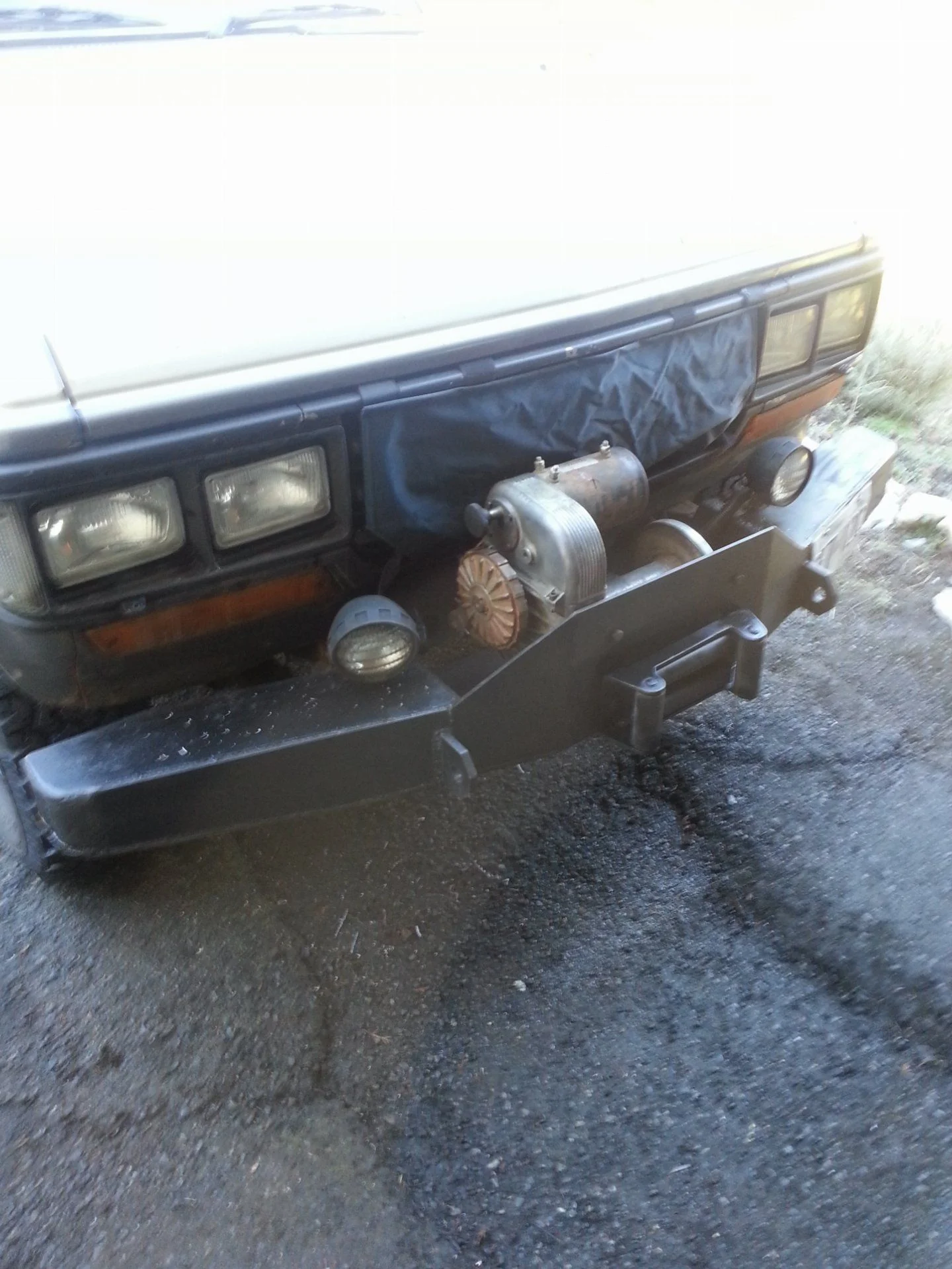

Yeah pretty miserable. Naturally, it cleared up when I finished.
At least I got it done enough to drive it to work this afternoon, the mighty celica with it's racing slicks isn't the greatest when there's a snowflake on the ground.
C'est finis. Pretty much.
Now to figger out contactor wiring.
It even works...still need to add a "holy s***" switch to the hot wire, but for now I'll just leave it disconnected. (if you've ever had a winch stick ON, you'll understand the holy s*** switch. )
Runva contactors are pretty slick. Much nicer than the solenoid nest most winches come with.
(don't mind the fancy cables, just more stuff I've been hoarding for years...:lol: )

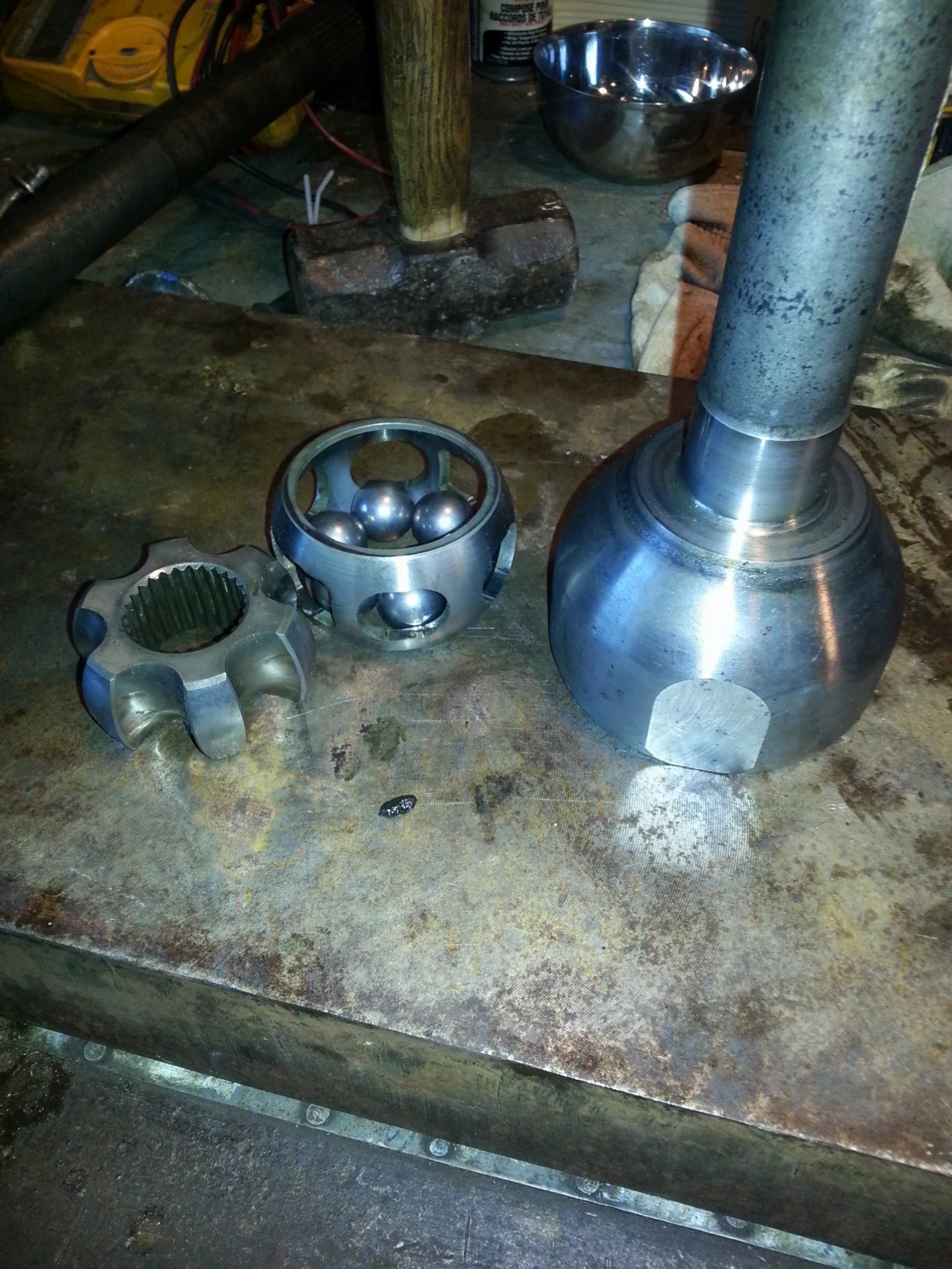

So i dug into the shed to find my spare birfs. They were covered in dirt, so i figgered I'd take one apart to clean it. (It felt better than the one that came out of the truck.)
A nugget fell out which I thought was a metal chunk.
There it is in the foreground looking like a greasy rat turd.
Which is exactly what it is.
No doubt the same rodent that pissed on my shop towel, adding a pleasant bouquet to the process of scooping out the old grease and mung from the knuckles. ...

Best part, I actually had to break the turd in half to verify it was in fact a turd and not a chunk of metal. Little bastard....not sure how he managed to poop inside my freaking birfield, but I'm taking it personally.
