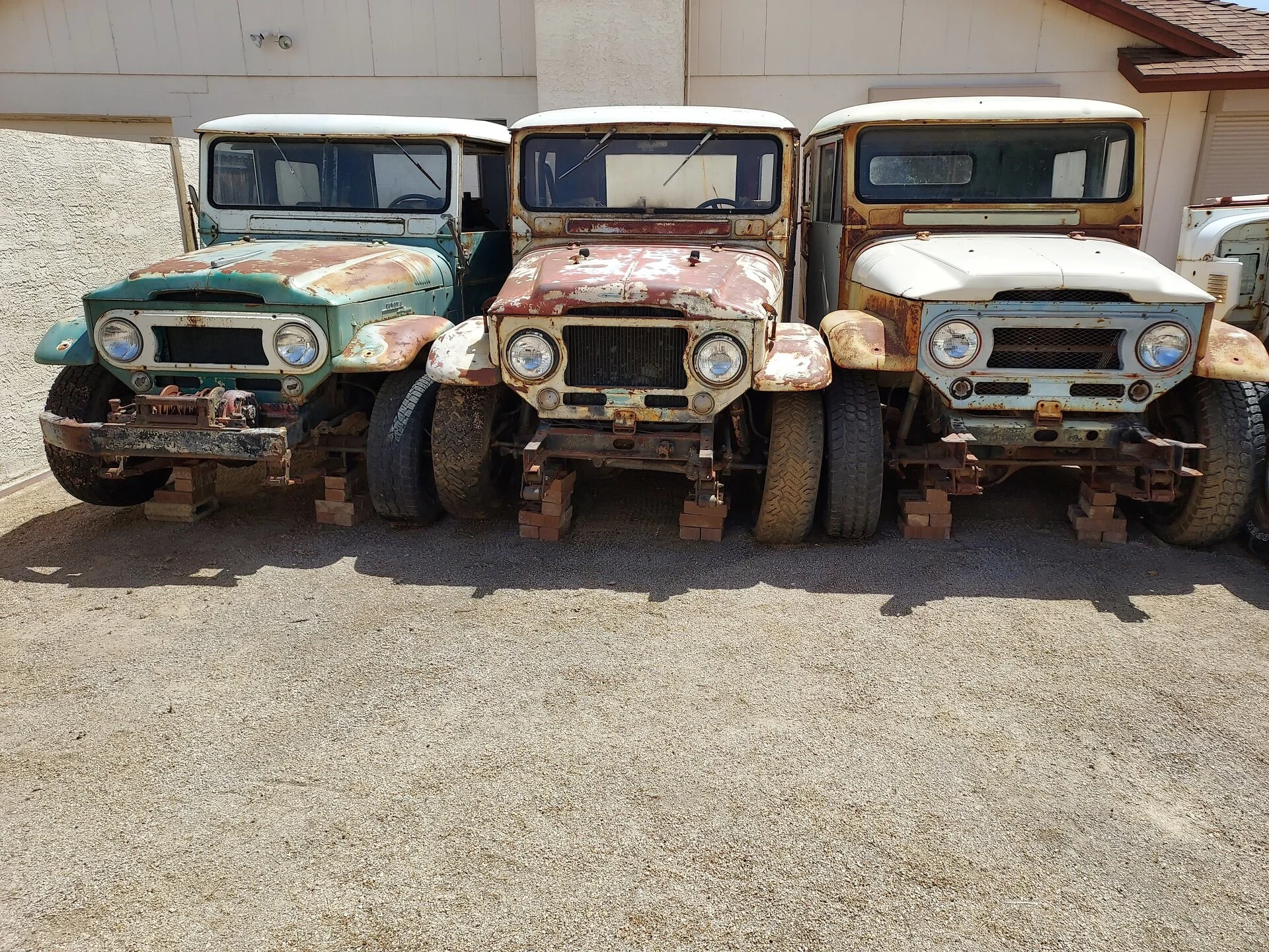

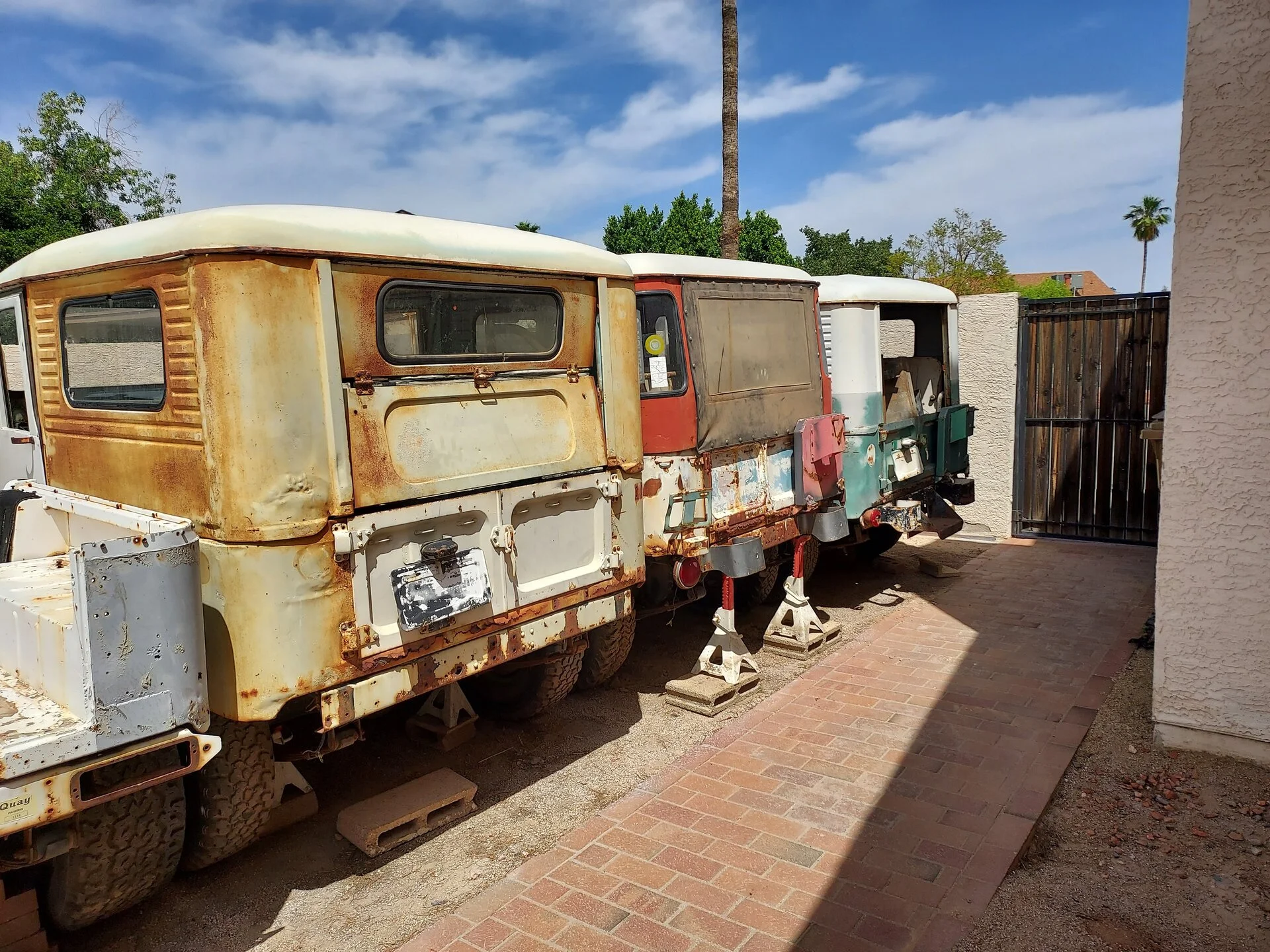

Unless you want to restore as a 61 I wouldn't waste my time. 61 still have some carry over differences that were on the FJ25. The jump seats were one year only. Turn signals, transmission/transfer case/ PTO, centered diff on the rear axle and stamped bezel were changed in 63. Green is a 61 Titled as 62. The off white is a 62 with a 63 VIN plaque I bought for the floor to use in a FJ25. But it has the later ribs used until 79. Both these surprisedly rust free except the rear sills. I have another 61 that sound similar to that your thinking about buying. It currently has a rust free 62 FST tub seating on it. Bought that 61 with title except the PO never bothered to transfer that title in his name. If you were closer would have you come over. Looking clear out my RV area.
Unless you want to restore as a 61 I wouldn't waste my time. 61 still have some carry over differences that were on the FJ25. The jump seats were one year only. Turn signals, transmission/transfer case/ PTO, centered diff on the rear axle and stamped bezel were changed in 63. Green is a 61 Titled as 62. The off white is a 62 with a 63 VIN plaque I bought for the floor to use in a FJ25. But it has the later ribs used until 79. Both these surprisedly rust free except the rear sills. I have another 61 that sound similar to that your thinking about buying. It currently has a rust free 62 FST tub seating on it. Bought that 61 with title except the PO never bothered to transfer that title in his name. If you were closer would have you come over. Looking clear out my RV area.View attachment 3530263View attachment 3530264

They look great. are they all Arizona FJ40's ?

@Living in the Past
The green one came from Southwest Colorado. It was in Southern Arizona when first heard about. Owner kept it at a second home in Rocky Point Mexico. Sold the the home Mexico and moved to a shop in Ajo AZ. Later moved to a shop in the Phoenix area. That shop has purchased a cylinder from SOR. Had the engine running but could figure out the brake. FJ25 had they own brake system was sure if it carried over to the 61. CDan kindly sent my a 61 microfiche and confirmed it used the same as the 62. Finally pulled the drums and confirmed they are the same as later drum brakes.
