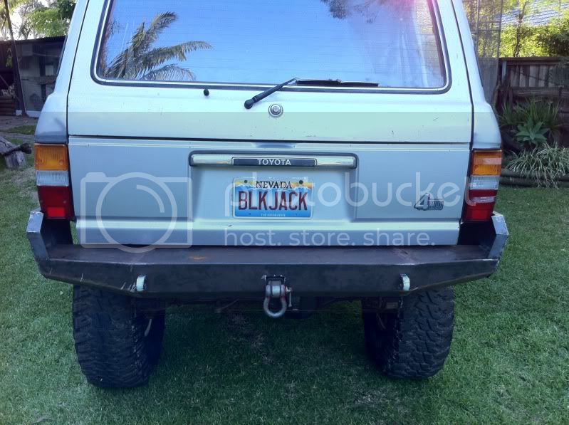

few more rear bar updates
all the holes for d shackles and trailer hitch have been drilled
after some playing around with the trailer hitch fitted, i decided that it needed a little something to take the rattle out of it, so i drilled and tapped though the corner here,
once the hitch is in you, screw this down to take the movement out of the hitch, after i did all this and welded it in place, i realized that it was too close to the pin to work effectively
so out come the grinder cut it off and moved it forward a little.

i got the side plates tacked up today, they are short then i originally designed which now makes the side profile not as nice as i would like :doh::mad::frown::crybaby:
im hoping that once the flair gets fitted it will break it up a bit
here are some side shots, il take some better ones during daylight hours

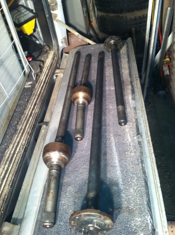

Got these delivered today, not too bad for $100 including shipping from Queensland (intestate) not bad for $25 each
all splines are nice and straight, CVs are click free :) stoked:bounce:
