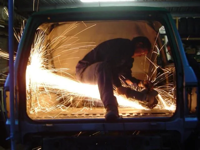

soon there after the rear end was stripped out, leaveing only a bare shell, and then with some carefull measuring and marking by Hypo, the first cuts where made (this was the point of no return, once a 9 inch cuts thru the turret, the isnt much that you can do.
the plan was to have the body chop done and dusted on the June long weekend 05, Clearly that didnt happen..LOL

Ho-Lee-s***! I have seen plenty of build threads, including bob threads, but this one rocks!
This photo is art. I hope those pants were thick, or your Marvin looks like it got a little scorched.
i like the look of the bumper template. it looks like it will take a beating. yeah the above pic is awsome but, then again im a bit of a fire bug my self

that is one of my fave pix from the build so far,
thats my brother doign all the chop work
