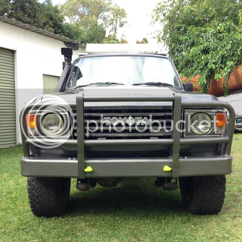

This looks really great perfect colour, , I've got to put the flares back on mine.
but thanks cruiser pilot, i love the colour, its darker then i planned, the only down side to it is i had to go out and buy a chrome grille to suit it, since i blacked out my old one, and the black and the grey just look too dark, but the little bits of chrome really pop now :)
nice work mate, it came out great
it does look good, i can't wait till its cut and polished :)

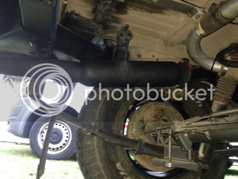

Took Bob to get engineered yesterday, passed everything except it failed the exhaust noise test, came in with a reading of 96dB but needed to be under 90dB,
so i took it straight from he engineers to the exhaust shop, got them to fit up a hot dog resonator to the rear section of the pip and dropped my exhaust noise down to 88.5dB :)

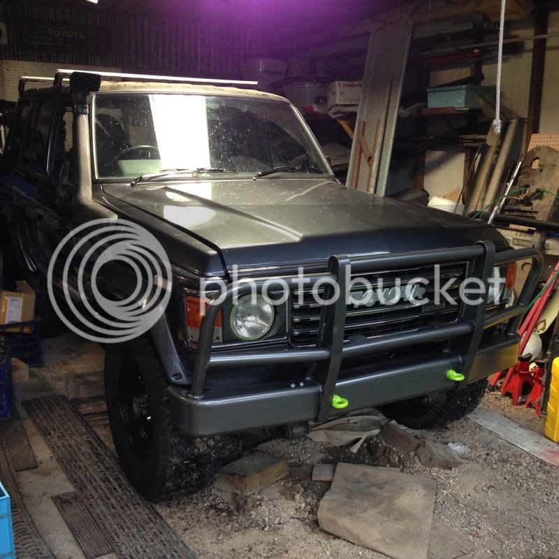

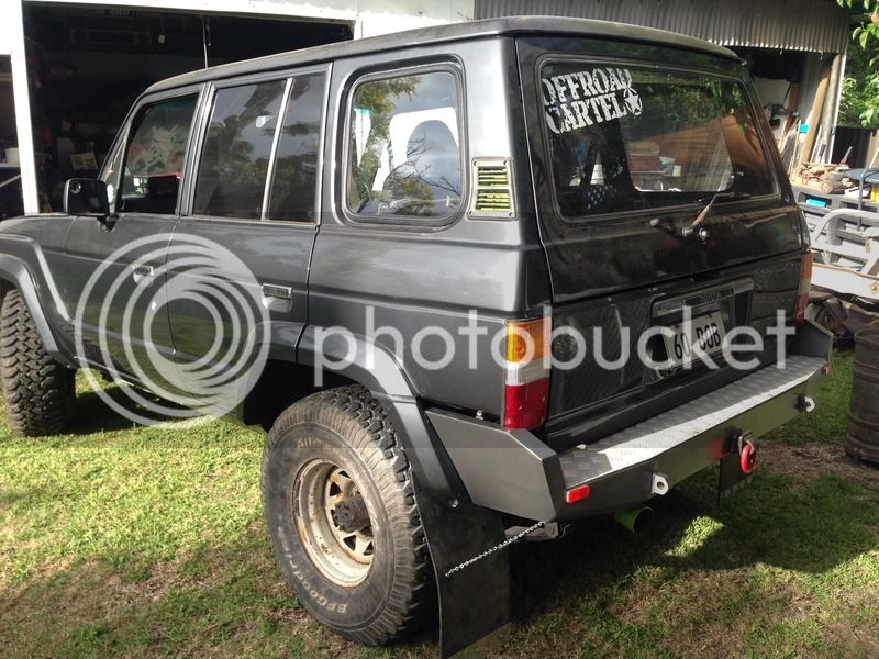

her is how she looks at the moment,

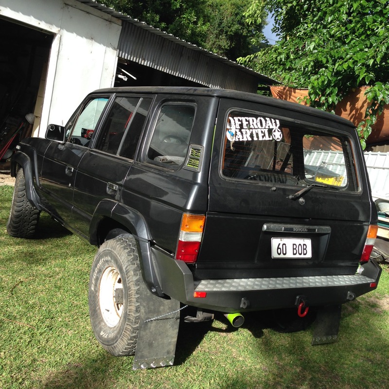

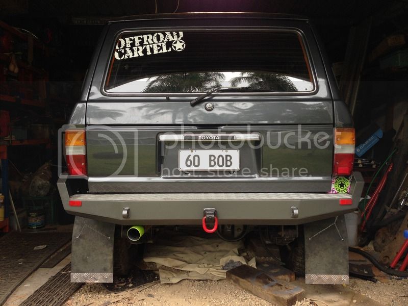

rear end all finished off, mud flaps mounted up, all i need to do know is make up a rear swing out

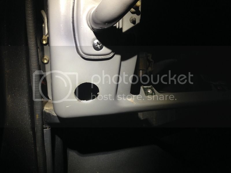

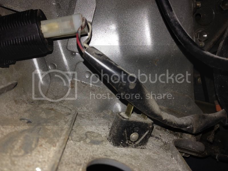

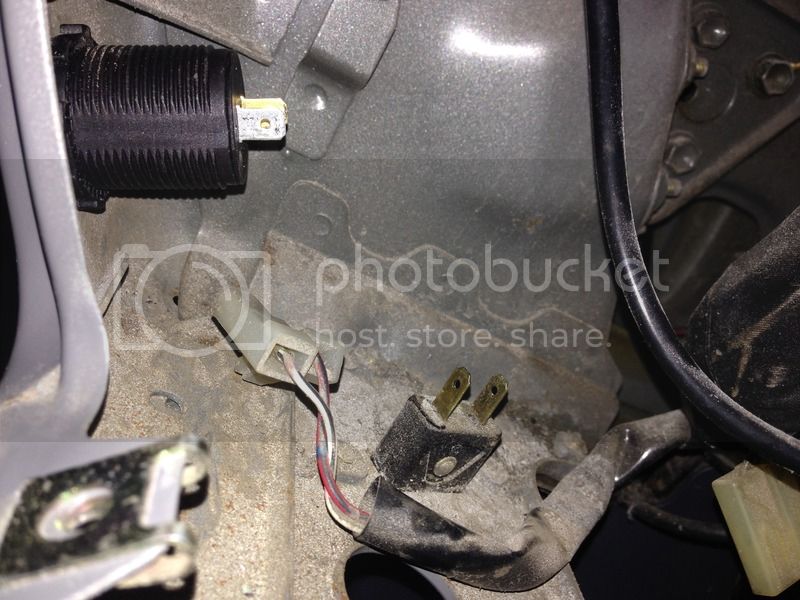

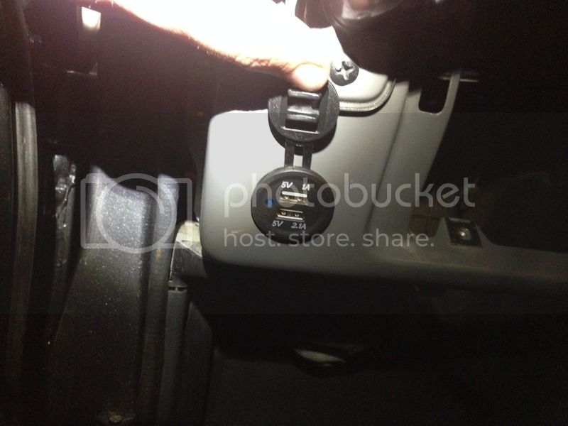

I decided to install some usb ports and bring my old girl into the 21st century, i picked up the active from the original work lamp plug, which as it turns out give me usb power 24/7 :) win!!
the hardest part of this was drilling the hole in my dash
i have since added one on the other side of the glove box too

also failed the noise test for engineering so off to the exhaust shop to add a resonator my original readings were 96db and this dropped it to 88db
