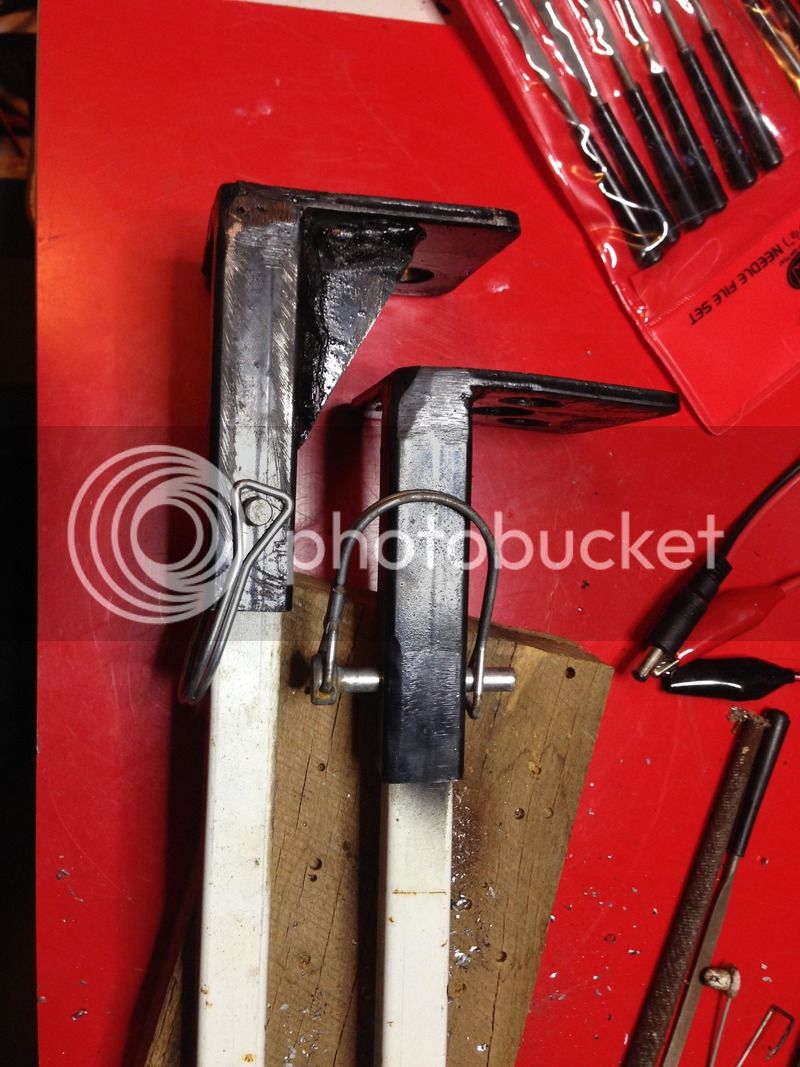

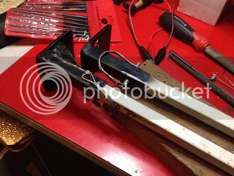

So decided that i needed quick release mudflaps for the 60 and here is my solution
i used some square plates that i had laying around, as the mounting plate, i uses two existing holes in the chassis rails just behind the rear wheels that were the perfect size to run an M10 tap through, the original mud flap arms where just 20mm square tube (no photos of this), but as you can see now, i have have shorted up the original arm and then sleeved it with a smaller diameter section of tube, i also had this in my scrap pile,
I then used a 6.5mm lynch pin to secure it in place, i haven't road tested these as yet, but I'm be sure to take the 60 for a run this weekend and see how they go
Long time no updates, the mud flaps work great, expect they do need a little tweaking,when the rear end flexes, the tires hit the mud flap arm on full up travel, but its not a major issue right now, so il address that later.

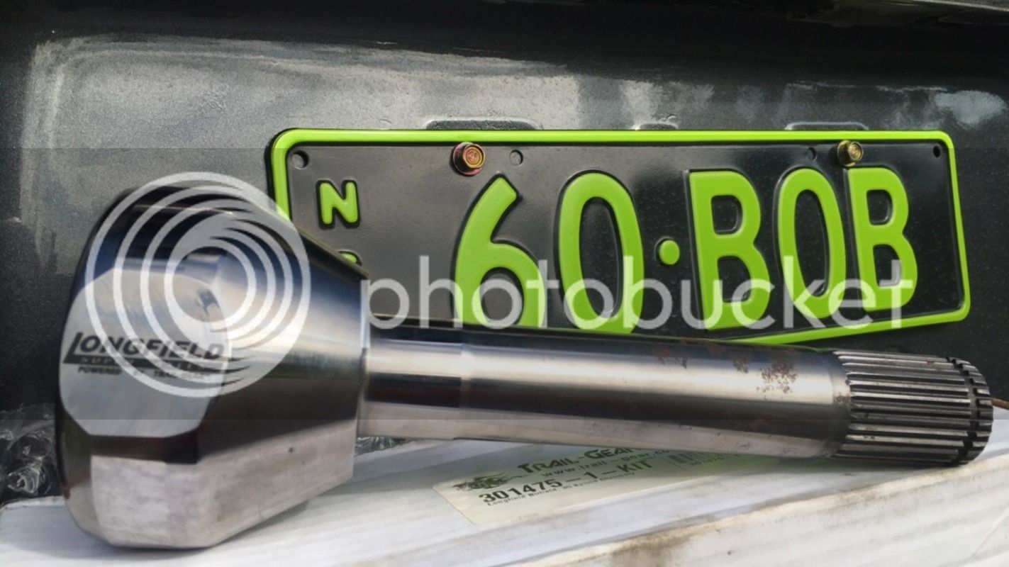

i picked up these cheap, so when i pull the locked centres out of my other set of diffs i have i will be upgrading the axles and CVs at the same time

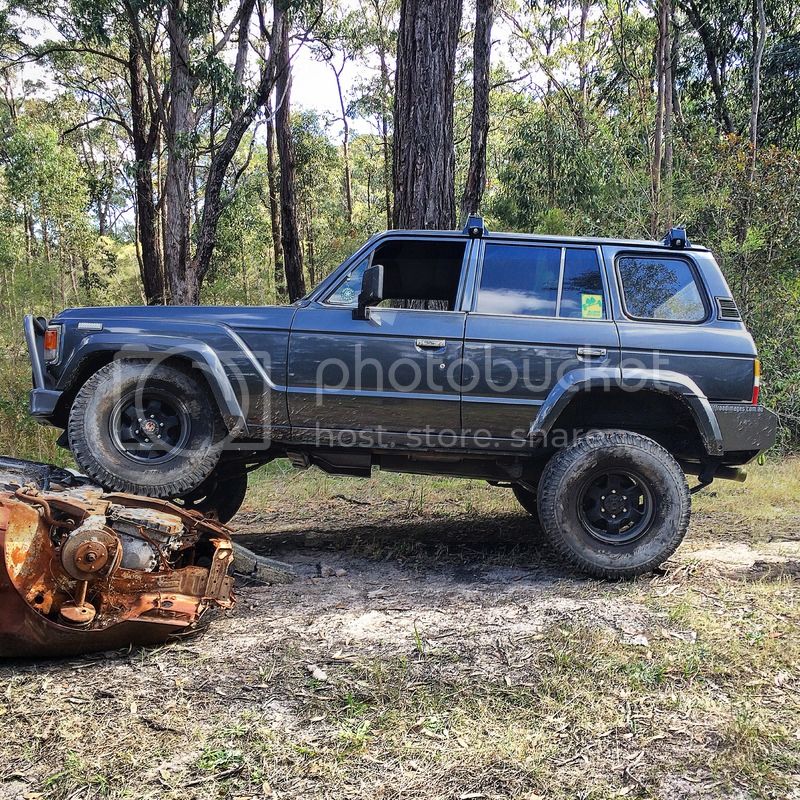

Bob making friends with a more chopped up 60

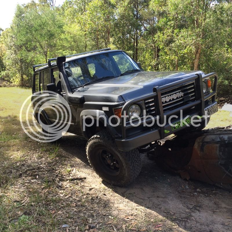

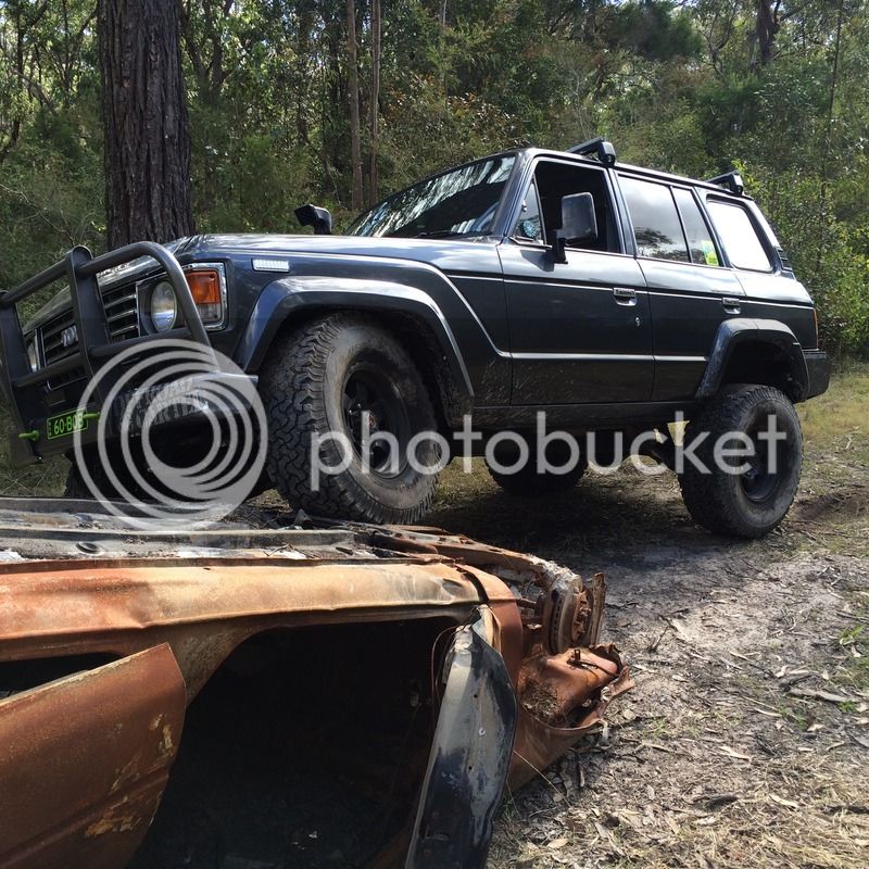

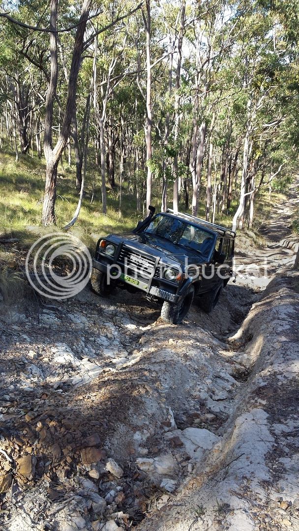

A few shots from another day out on the trails

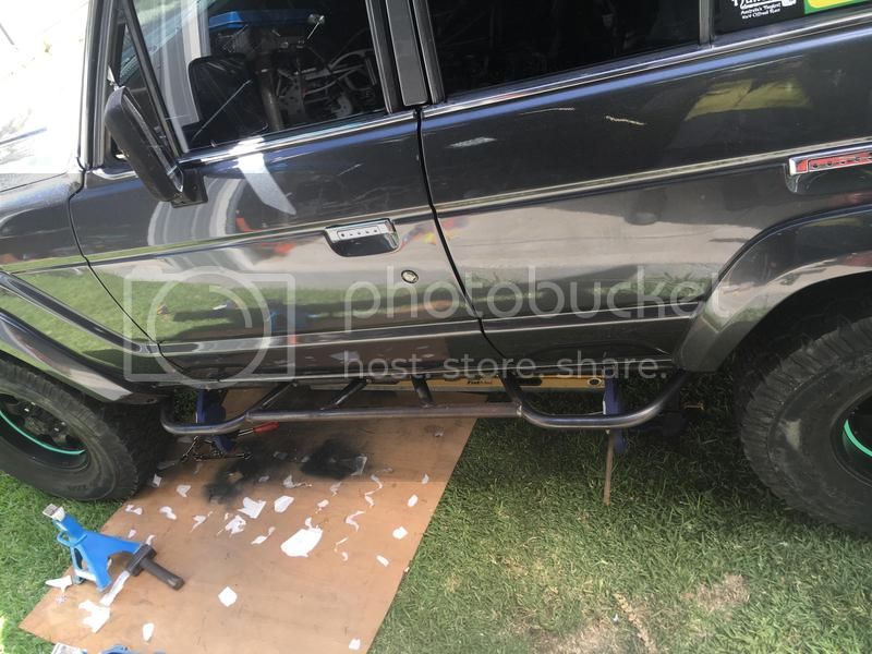

Now a few shots of Bobs new SlideSteps

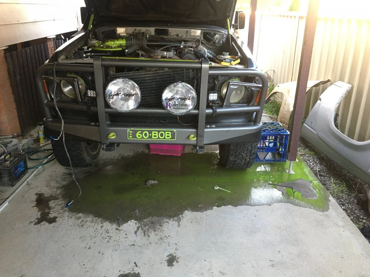

so i now have my radiator out and pulled my water pump, ready for a new now to go in tomorrow,
is there anything else i should look at or replace while i have it this far apart?

As the owner I am responsible for territory pissing
new clamp, but it is about the cheap laser thermometer that helped deciding it was not overheating, also the meter is first alarm-bell in wheels temp and when one wheel is high it is leaking.
