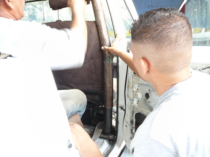

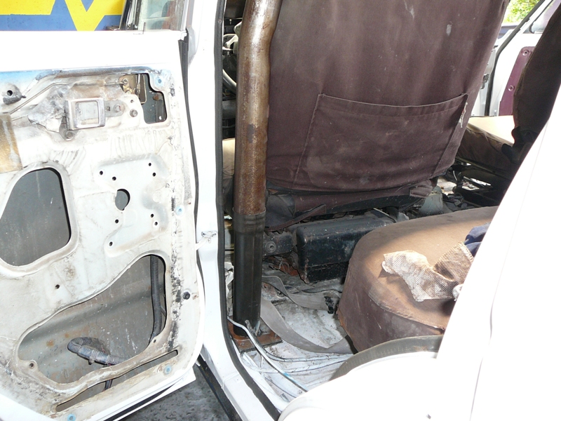

I gonna use 1.65 DOM for rolll cage ..

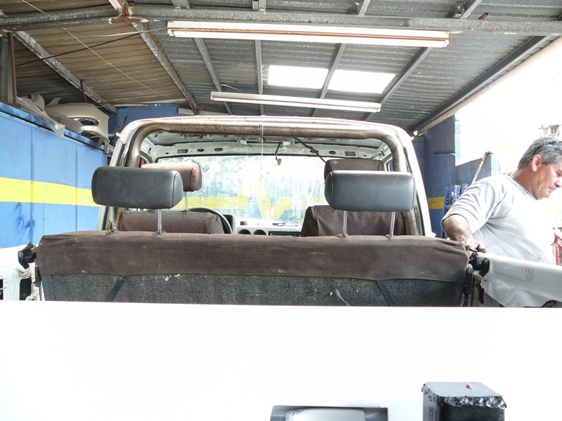

looking better! im curious as to what you are going to do to the interior in the rear part of it?
as same as you have in your 60 series .. seats, mats all as I have my hard top ..
:D be patient and see !

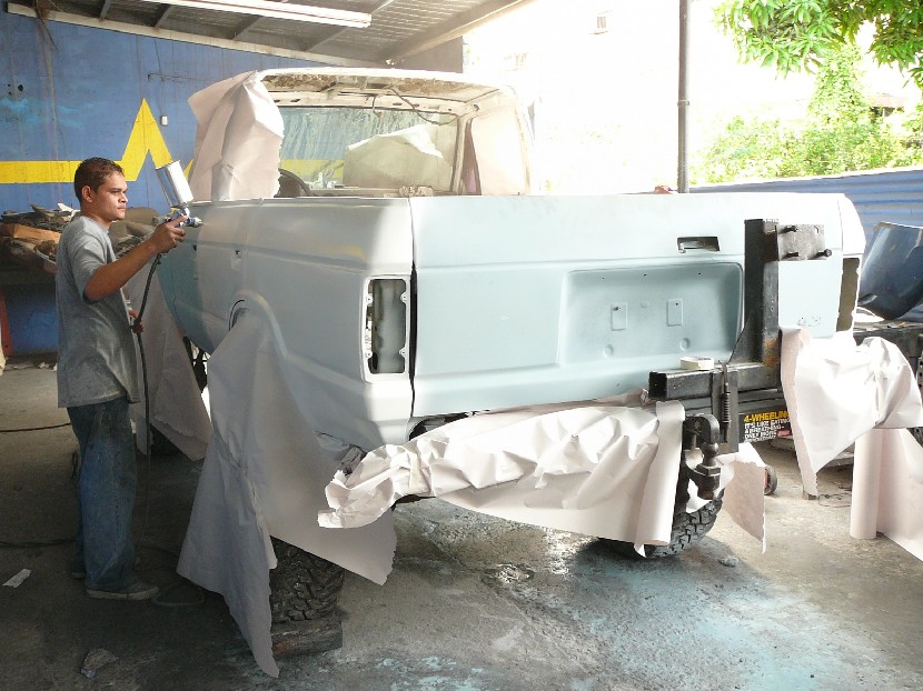

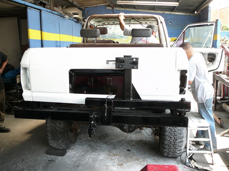

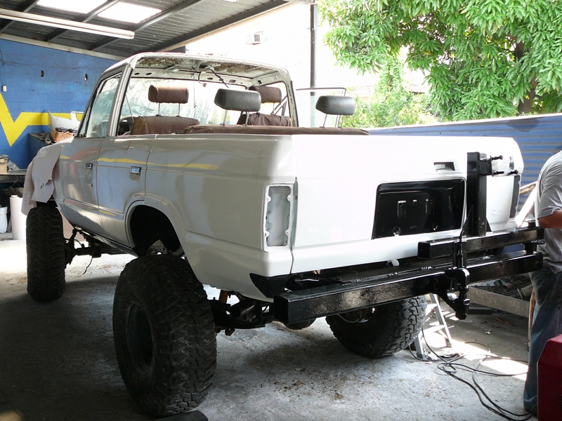

Wow, fresh paint and all, no fooling around. I really like what you've done to raise the tailgate height. What are you going to do for a latch?

Tapage, now you just gotta get your buddy spraying the paint to wear a respirator :) no point getting your lunges full of paint now..
tailgate latch . ? did you see the hole outside and inside :)
It's my buddy as is .. is a guy who work in the body shop .. so he need to take care about his bless :D

cage ..

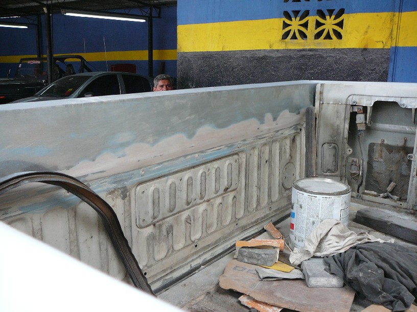

How much work was involved in raising the tailgate to match the quarters, that looks great.
not much really .. just make a mold and weld it over the tail gate .. the main issue is the mold per se .. it's like a U
