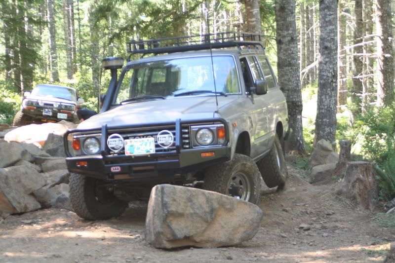

ok... Clint sent me some more pics. Thanks!
Wow! All that looks great. Sorry I missed you guys. I'll take your word for it that 31s and open diffs could go through any of that. I hope to get some ARB lockers fairly soon. Keep me in the loop about building sliders. I make it up to Oregon on a fairly regular basis.
