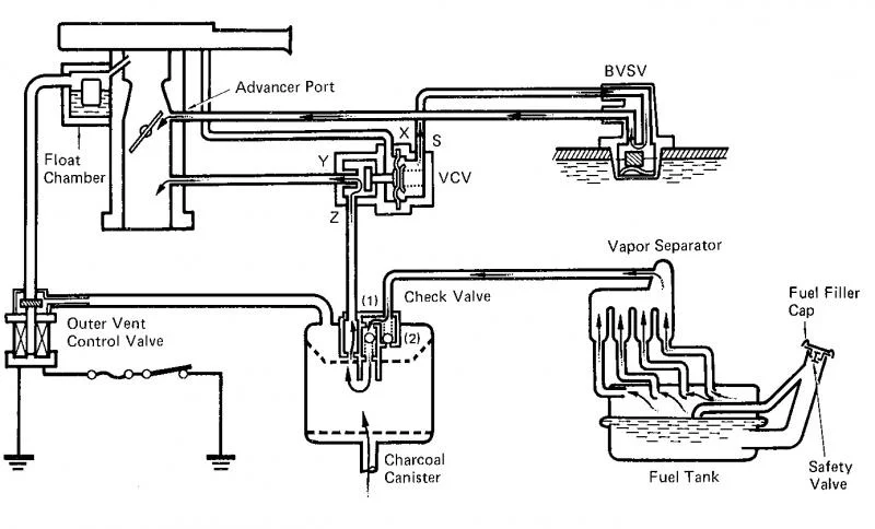

resurfacing this thread. getting fumes in my 85' fj60 drivers cab, trying to fiugre out why this is. Is there a venting line that goes into the drivers cab area that I can reroute? Or, maybe its one of these reasons (i've alraedy replaced PCV valve out of the block and the c canister...)
Alternative explanations:
1.) I replaced the lower vent lines via your kit, and am wondering if I need to replace the upper ones.
2.) is there a check valve all the way in the fuel tank area that could be old and clogged or is this only for Fj40's? (see photo)\
3.) I've read guys have issues with the seperator sometimes getting clogged, has anyone seen this?
4.) Finally, I suppose it could be clogged somewhere all the way back in one of the metal lines going under the truck as the truck sat for a while before i bought it 3 years ago. If you have any ideas much appreciated, trying to car camp in this thing over the holidays and rather not have fumes haha.

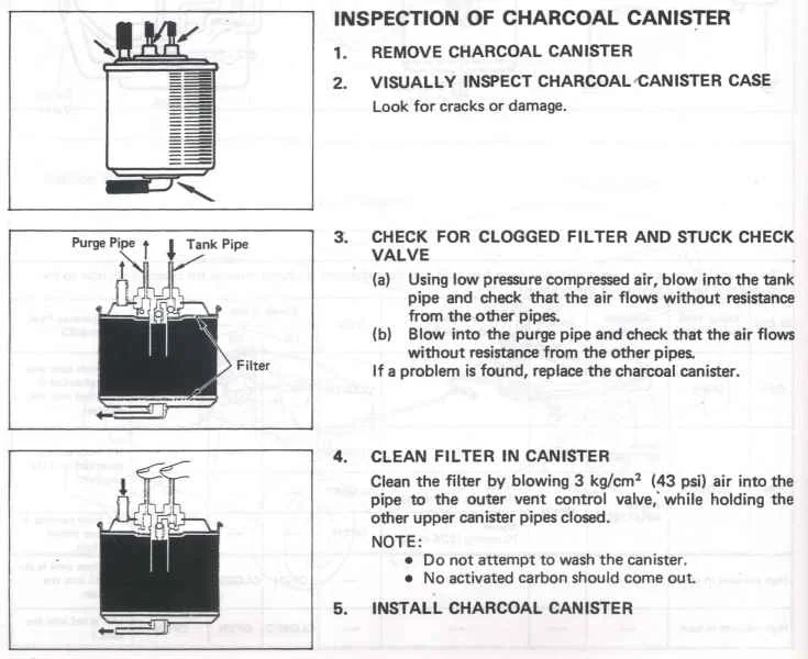

You need to read the emissiosn diagrams for charcoal canister. If all of your lines are connected correctly and unbroken from tank to separator, then you need to test your charcoal canister, vent control valve, VCVs and associated lines are routed correctly. Then come back.
Make sure all lines are clear,
Until you get it figured out—
Remove the gas cap and stuff a rag in the fill pipe and lock the access door.
That will eliminate any vapor pressure in the tank & lines and vent it outside.
My guess is your vapor separator behind left rear panel is still leaking and your charcoal canister check valve is stuck (unfixable).
