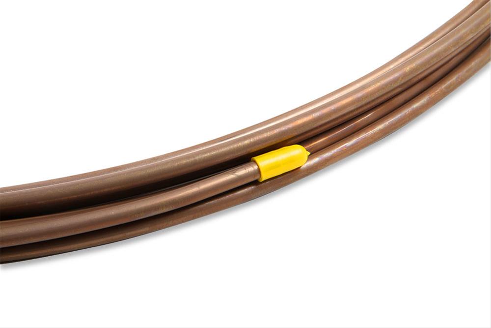

Can you share specs of hardlines used for tranny lines? Great build!!!
