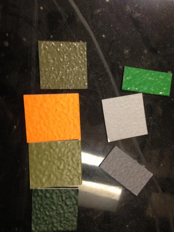

Trying to decide if I want the doors black or orange given the lower orange coloring.
I have powdercoat orange and black, so let me know your thoughts. I can't say ever seeing painted tube doors that i liked.
Hmmmmmm???
I love orange,but... my vote is too go with an oem color. I think you will like it for a longer period of time.
I think colors like orange are too trendy.IMO...
Thanks.... I did get a chuckle that your avatar is an orange bus....:D

I concur on tube doors same color as the body at that area. The one pic you had of black tube doors next to orange body looked a bit odd.
